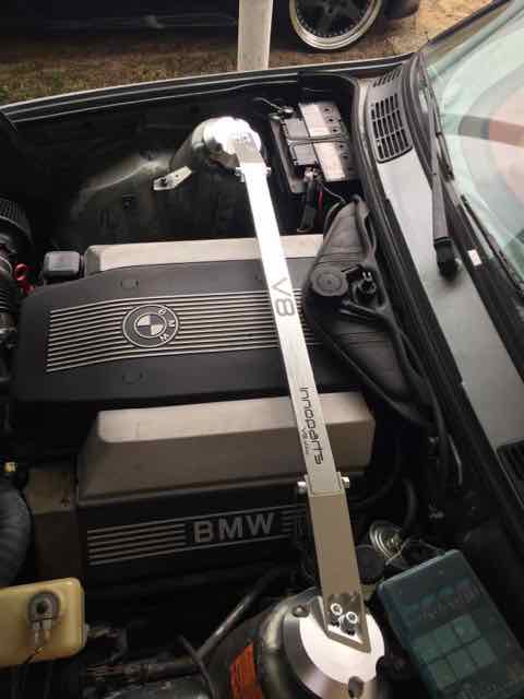

                    Lets see your V8 E30
                    In my early stages. Testing fitting many things before I started to clean up the bay.
