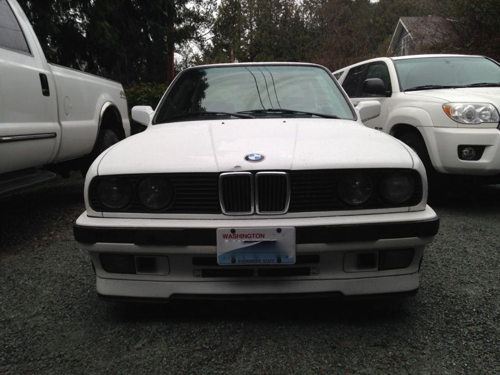

  • Nader393
    replied
    Anticlimactic?
    One the one hand, it's hard to see the new smoked headlamps. On the other hand, this looks kind of badass.

  • Nader393
    replied
    I wanted to replace the headlights, because one of the GE sealed high-beams was running low on headlight fluid. Kind of hard to see, but it's only about a quarter full. Where can you even find a bottle of that anymore? I used that as an excuse to step up to smoked Hella smileys + Lamin-x + LED city light + HID conversion. I like the crosshairs on the high beams, too.
    Leave a comment:
