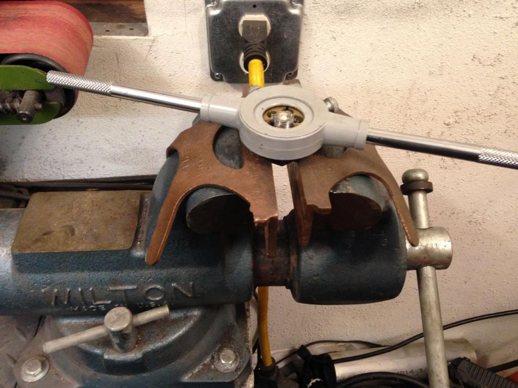

    While attempting to replace the car's thermostat, I broke the housing because I am strong like Hulk. So I got a replacement off eBay, probably made in Romania by Gypsies. It not only had metal shavings in it, but also two threaded holes in the top that didn't need to be there.
    What to do? Like any normal person, I machined my own aluminum screws to plug the holes. The backstory on how I taught myself machining is buried somewhere in the middle of my Alfa race car build thread here It's actually more fun and not much more work for me to machine these screws than to drive 10 miles to Tacoma Screw to buy them. And mine are lighter.
    First, I selected the appropriate sized 6061 Al hex rod from my stock.
    Cut it down, faced the ends, and turned it on the lathe into a screw blank
    Then started cutting threads on the lathe
