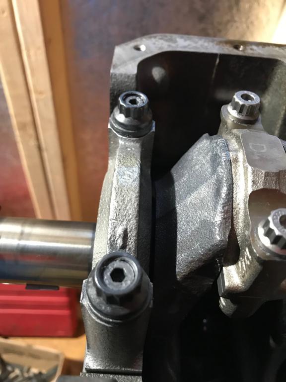

    As for my ongoing project, I spent a few days away from it, stewing over the shallow main bearing stud issue. Strange, because I ordered the specified kit from ARP, according to the machine shop that has built up many of these M20 engines. In my research, though, I can't find formal documentation of the M20-specced part number from ARP.
    It still bugs me that those ARP studs don't protrude from the nuts. This happens when I farm out work; questioning variances like that. The more I think, the more I worry. Then my concern escalates, and I imagine that maybe it's worse that it seems; maybe the studs aren't even bottomed out, and still installed short. Here's a picture of what worried me:
    So I went back and loosened the main bearing stud nuts (in the correct order), and sure enough, the studs weren't even screwed down all the way. Picture shows the studs fully threaded into the block (that I painstakingly chased and cleaned of gunk in a previous post). One side has the washer, the other doesn't.
    So apparently the studs were backed out of the block enough to thread just the bare minimum nuts, ostensibly to reach acceptable torque. Unacceptable (to me). Must have at least two threads protruding from the nut, while the stud is bottomed out.
    OTOH, since the main caps are steel, one could use the nuts without the thick washers (as pictured for the top stud/nut above), but even then there's barely full thread coverage. Call me crazy, but when you spend 1/8 of $1K for slightly more than a baker's dozen of some finger-length small caliber studs with washers and nuts, I feel like they should fit as a mechanical engineer intended, including the washers. In this case, backing out the stud to make it fit sacrifices precious block thread real estate, thereby losing out on ultimate stud grippage. I'm sure this setup is fine for 99.9% of users, and that I'm making a big deal for myself out of nothing, but I still find it frustrating, can't let it go, and I'm going to fix it...

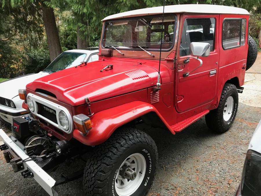

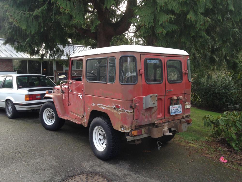

    Thanks, and you are correct, that is my '76 Toyota FJ40 Land Cruiser back there. I have a thread on IH8MUD:
    Hi. I've always liked these old Land Cruisers. Almost got one in '98 when I lived in Phoenix. Probably should have, they were cheaper then and less rusty there. Anyway, life got in the way, interests changed, blah blah blah. Then I stumbled into that Youtube show Dirt Every Day which has a...
    I'm happy to post up pics of it, but this an E30 thread, apparently with a smattering of Alfa. So I'll try to tie everything together in a few pictures:
    Here's the rig right when I got it home. I drove the E30 out to see the truck before buying it. It was kind of an impulse purchase. Truck was very crunchy when I got it (still is):
