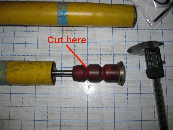

                  Originally posted by Bggdnssnguy
                  I also mentioned in previous post about bumpstops. Yeah well that didn't work. I cut one down to size and Dremeled the fuck outta it. Go it on finally and tried to pout the shock sleeve on and it would go over the bump. If I had dremeled the outside to fit the sleeve, then it would of been useless and broke. It was sturdy like it was but I didn't wanna fuck with it anymore so in the trash it went. So here's a couple pictures of what I tired to make work.
                  Not sure why anyone hasn't mentioned this yet, but Bilstein shocks have internal bumpstops at the bottom of the insert - there is no need to add external ones up top which is why they don't come with them (like KONI, since those DON'T have internal stops)
                  Pic of E30 Bilstein for reference - ignore the 'cut here' text.
                  Top is unopened, bottom is opened revealing the internal bump stop.

                    Hmm didn't know that. I didn't run them as they didn't clear the cover. But nice to now know! Thanks man!
