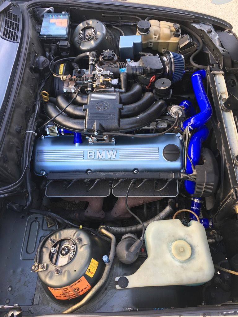

        So got a couple things done and found some problems that I also fixed.

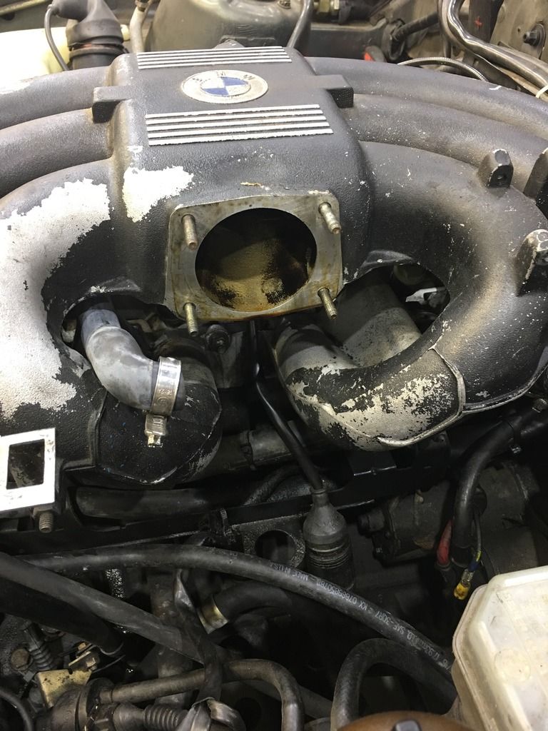

        1 thing wrong was there was no gasket between the throttle body and the intake. This was my major oil leak. Not the return tube. But everything got new bolts and nuts and rearranged as close to spec as possible.
        Now for pics!
        No gasket what so ever and oil leaking out of it.

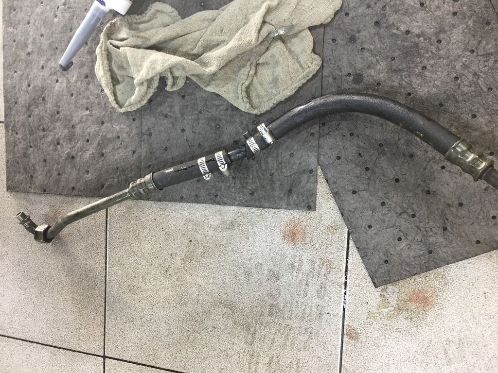

        Here's the rigged up trans line someone thought wouldn't leak. Rubber hose inside a rubber hose.

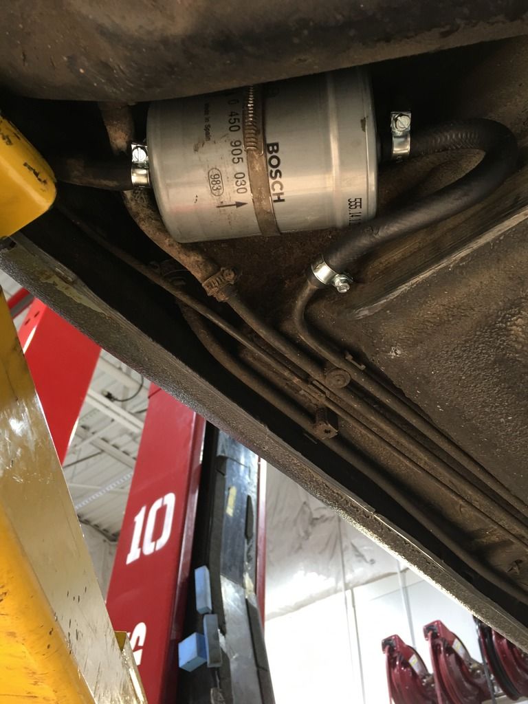

        New fuel filter and clamps.

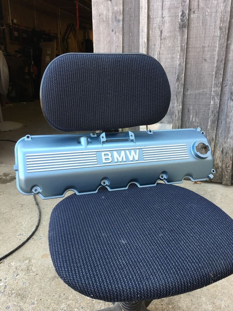

        Valve cover painted with vht paint and sanded fins and lettering.
        Everything installed and cleaned. I will be prepping more plastic to paint same as the valve cover.

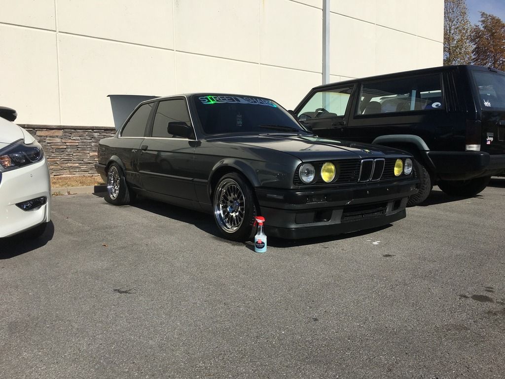

        Here's a shot before the e30 meet last night and while at the meet.

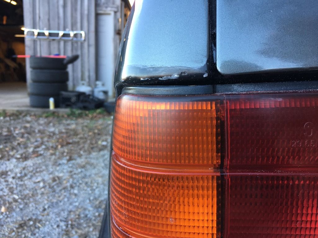

          Some rust I found. Sanded and primed then sprayed with black and wetsanded. Not 100% quality but it will stop it from getting worse during winter. Have 2 more spots I need to tend too.
