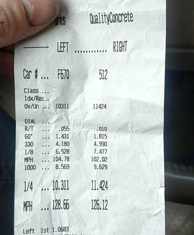

                    Yeah, I mainly started this with the intention of running it at Shift S3ctor. Unfortunately it wasn't done in time last year so I ended up racing my evo when it was at just 350whp (488whp now).
                    While the e30 is ready to race it this year, Shift S3ctor unfortunately won't be in Oregon this year due to them repaving the airfield same time it was supposed to happen.
                    The car has had 1 day at the drag strip so far. Without launch control, still a lot of weight reduction to be done and the rear end still needing to be built, it back to back was throwing 11.4 @ 126mph. This was it supposedly making 520whp on a mustang dyno. However I wasn't there at the time and never got a sheet proving it. I put it on my friends mustang dyno and made like 398whp. So either something was up and it was making less power on e85, or it really didn't make 520whp which means I can crank the boost up more as it is turned down quite a bit at 17.5lbs

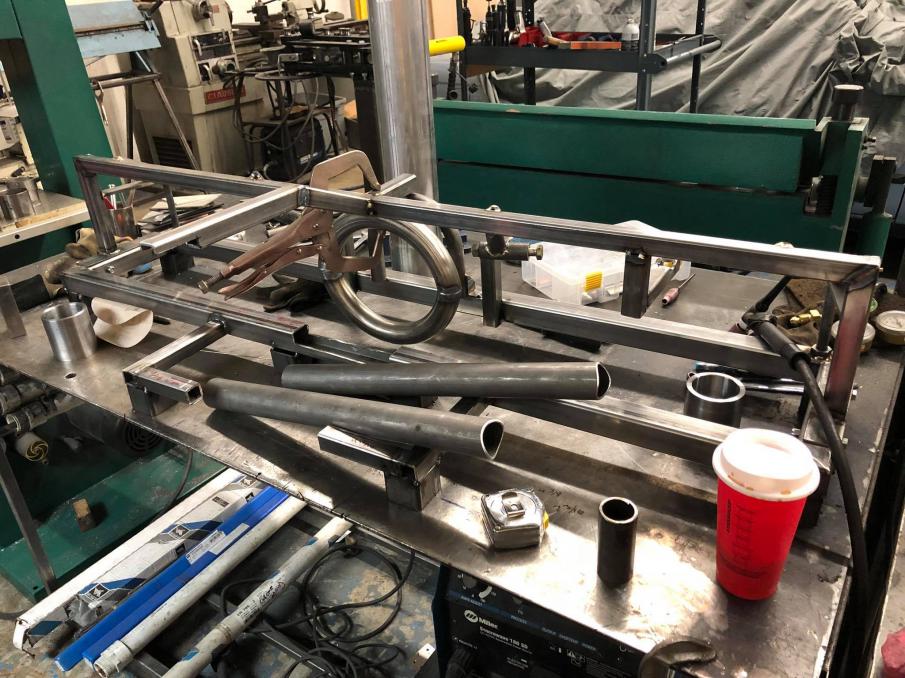

                              Little update:
                              We are scrapping the carbon fiber driveshaft before even using it. It won't fit the application I am now in the process of having built. I am having a completely custom rear subframe built to allow a 3.5" 1,100 hp rated driveshaft from The Driveshaft Shop to fit it. As well as just allow it to be dialed in completely for this setup. We couldn't get rear camber to zero out completely so we will be able to with this setup. I also wanted something beefy and also allow the shop to use their creativity again. It will also allow for the differential to work in this.

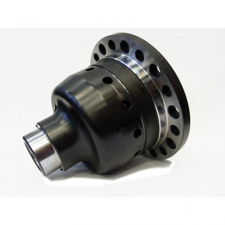

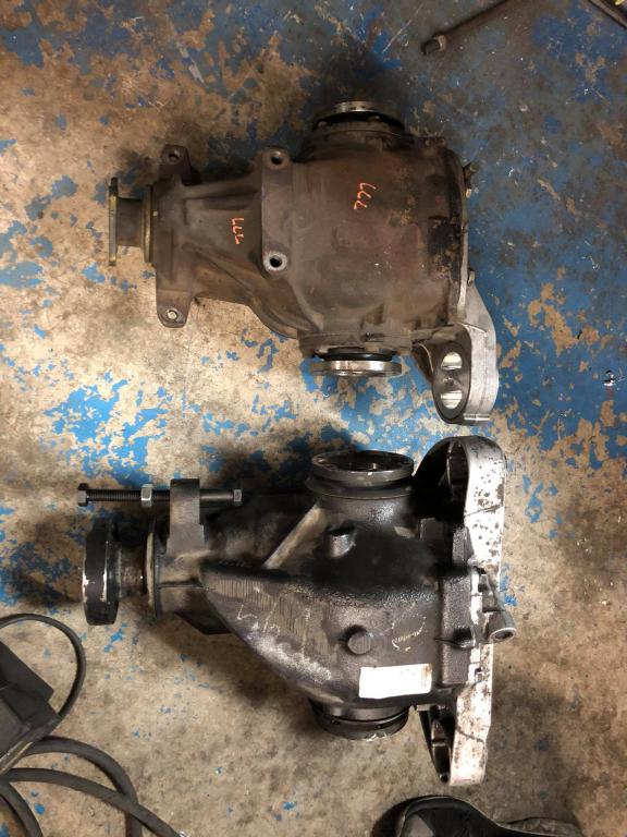

                              The 2.93 differential is being replaced with a e39 540i open diff that is being fitted with a Wavetrac LSD. Instead of the single ear the stock differential has, this has two built in. So I won't need to buy the Garagistic secondary diff mount that bolts on to the stock single ear. From my understanding there's multiple people running this diff and throwing 1,000 hp at it and launching it without issue. This is good. I want my drivetrain to handle everything I throw at it. The next weakest link however would by my ZF transmission I bought for $100. Second gear isn't happy. I'm just hoping I can make it last until I go with a sequential gear box.
