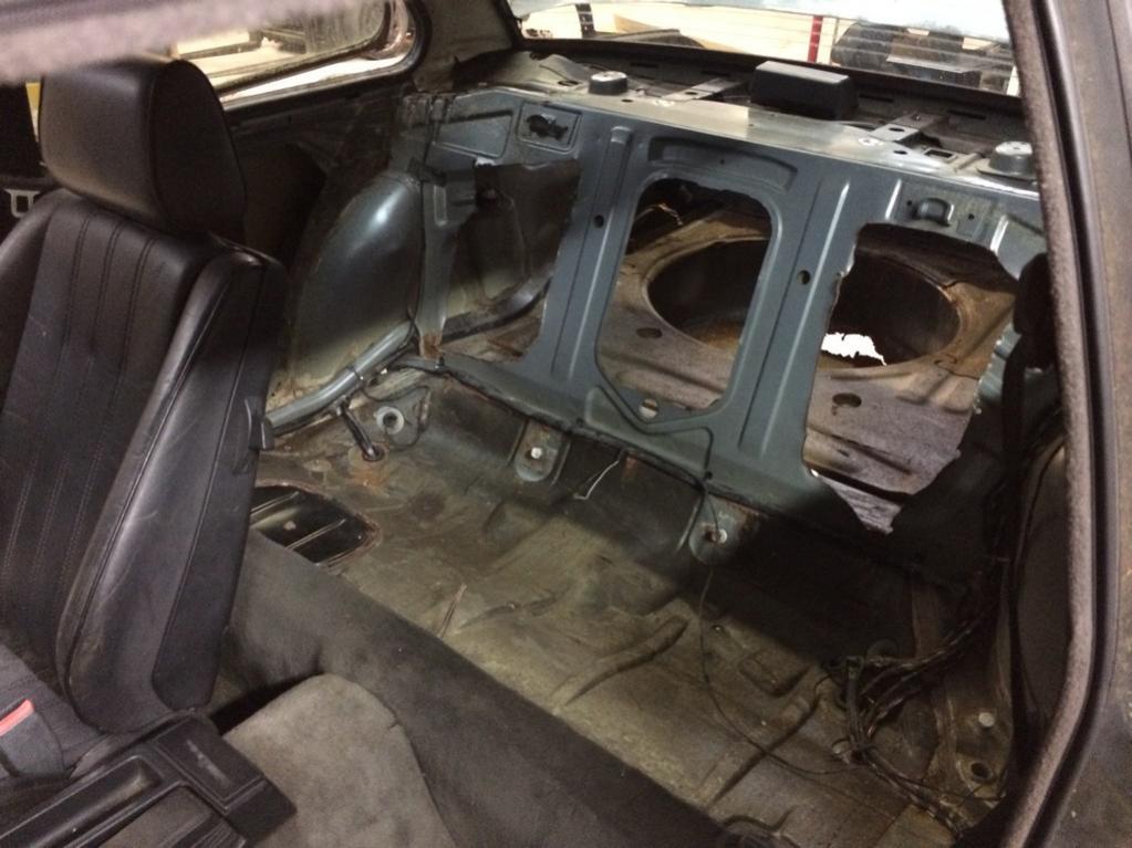

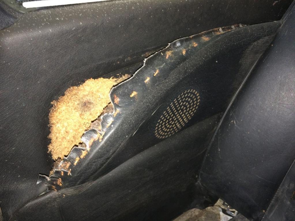

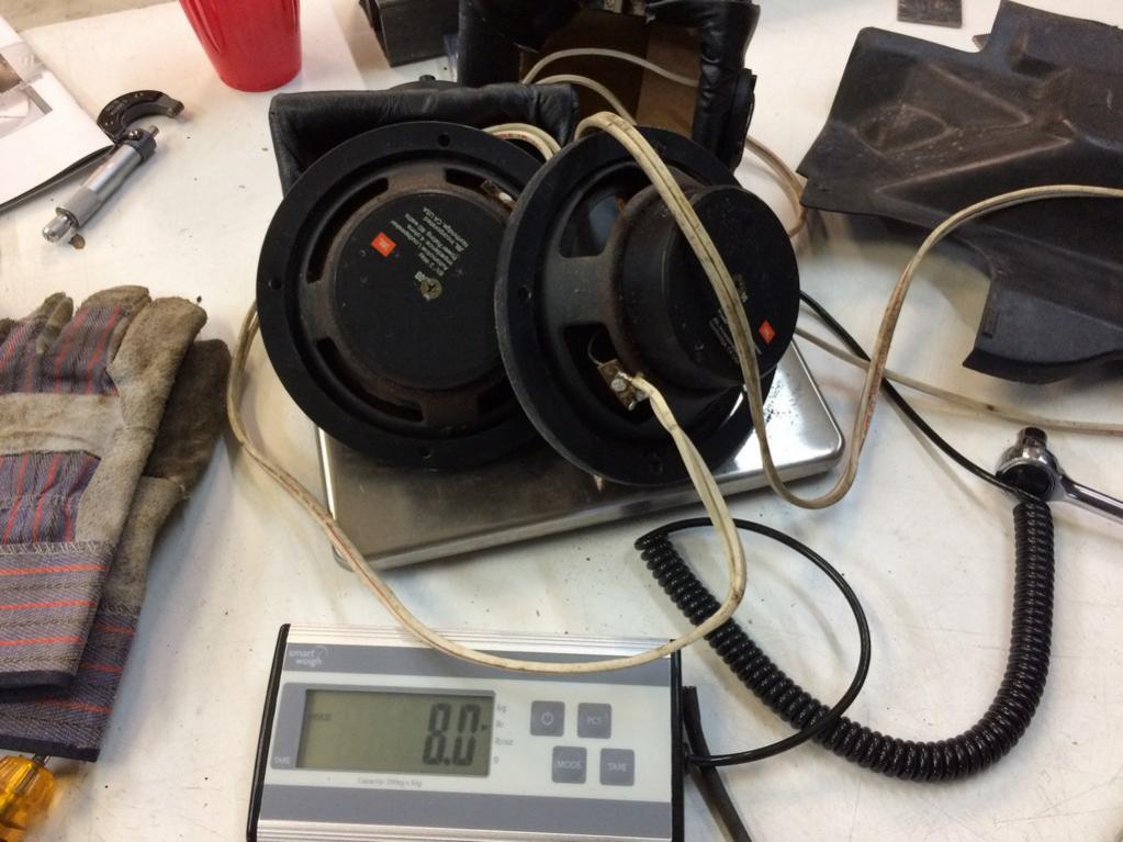

    I removed the interior. The rear seat was torn, the rear cards were poor, the driver's seat was broken and the passenger seat was rusted in place. That took some beating on just to get out. Also tossed some 90's stereo equipment.

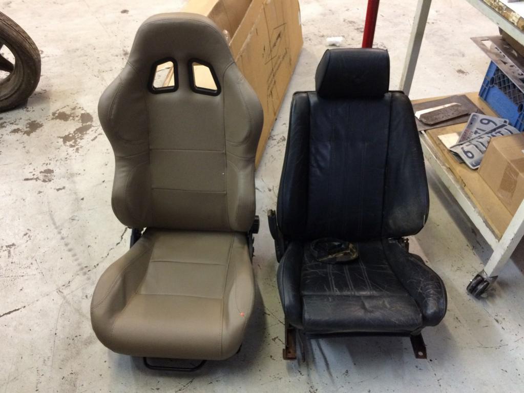

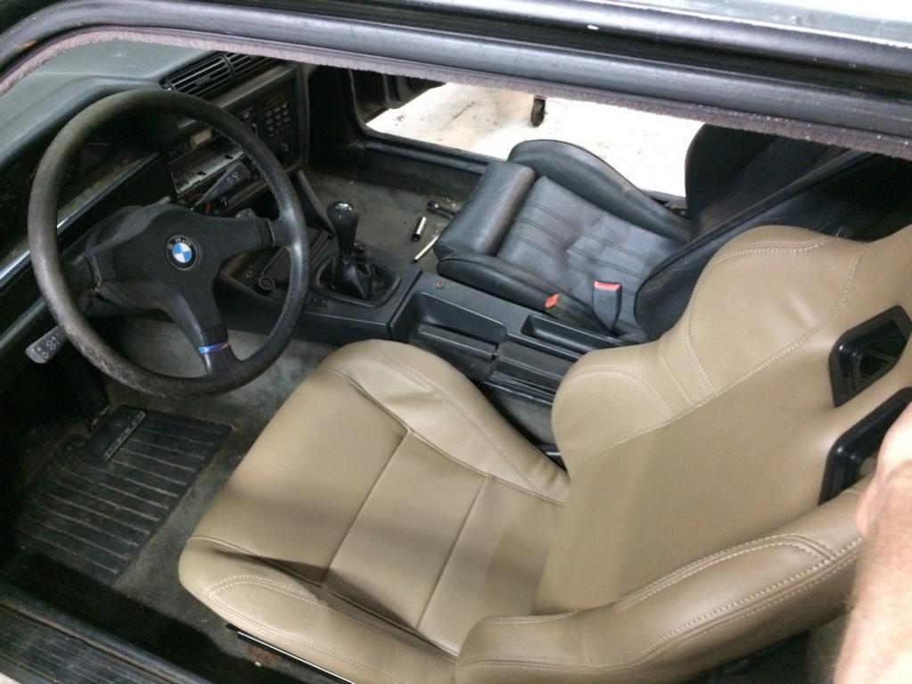

      I happen to have some seats I bought from Summit a few years ago. They are still in their boxes. Looks like they will fit nicely.

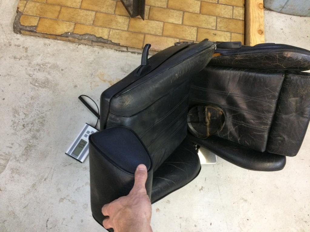

      Stock e30 seat - 45.1 pounds (balanced with my hand)

        Weights: I am just weighing some things for fun and future reference. I am not counting ounces and shaving seconds.

                What does the new seat weigh?
                AWD > RWD
                • HCMW Adam
                  • Oct 2016
                  • 209
                  The box says 18 kg. I will weigh the actual chair Monday and post that.
