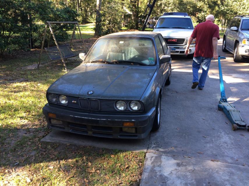

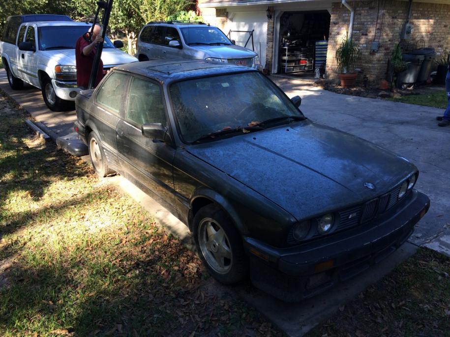

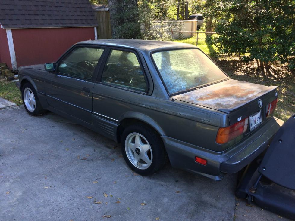

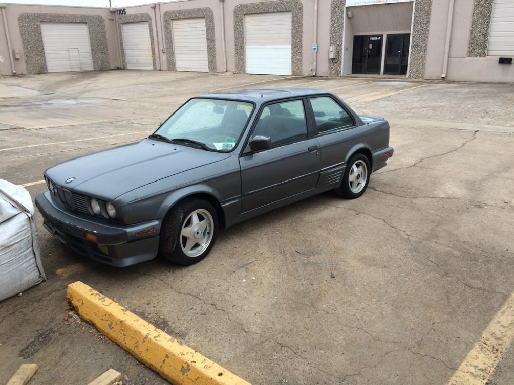

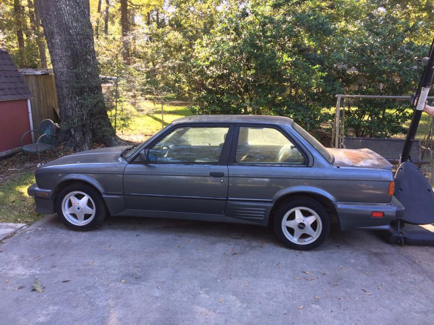

    Hello all. I was looking for a 325 and found one in the for sale section of this forum. Registered to contact the owners friend and then the owner. Checked it out and it was as advertised. Let the work begin.

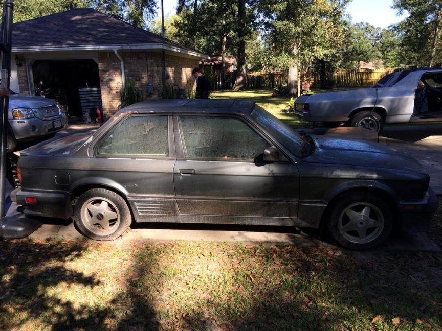

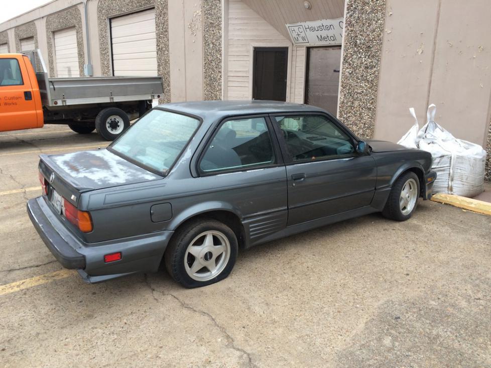

    I brought it back to my shop and washed it that night.
    • HCMW Adam
      • Oct 2016
      • 209

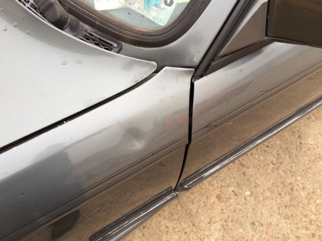

      Exterior condition: Not bad.

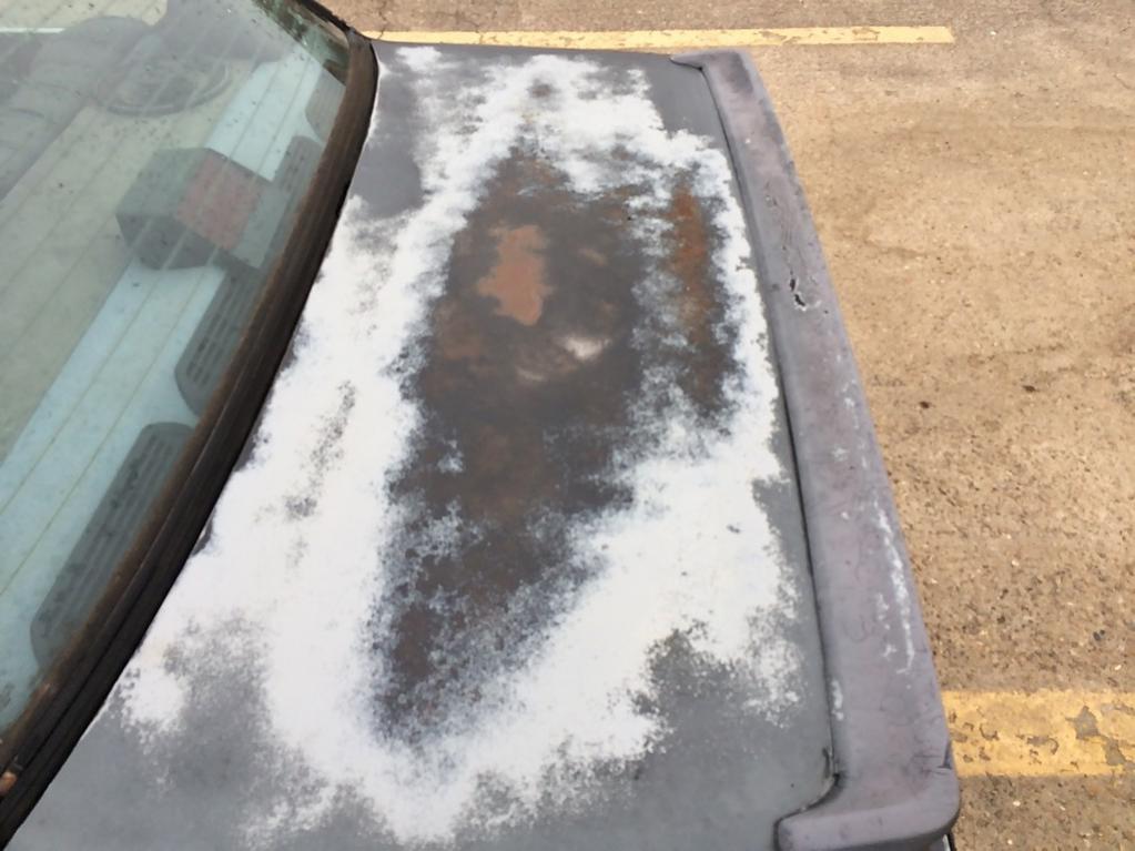

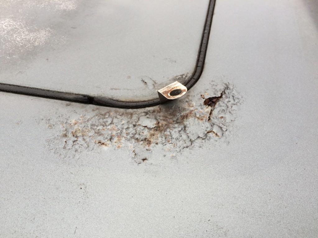

      There are only two noticeable rust areas so far. By the sun roof it looks liek the rust has penetrated through the steel. This may get some silicone smeared into it or get hosed down with paint until it can be properly dealt with. The second spot is the rear deck lid. It is just surface rust. Most of it came off with a green kitchen scrubby pad. That will be sanded a bit and painted.

                    FYI based on build threads I've seen, your best bet to tackle that roof rust when it gets that bad is deleting the sunroof and cartridge.
                    This would also remove a bunch of weight up high, perfect for a track toy.
                        P.S. - You can insert the attached images into your posts (so we don't have to click them). There is a button to do so when submitting posts (you may have to go to "advanced" view)
                        I am planning on making it a slick top. I have a metal shop, so I have the tools. Never done this before, but I can handle it.

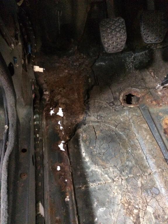

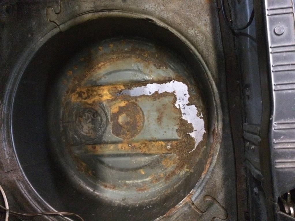

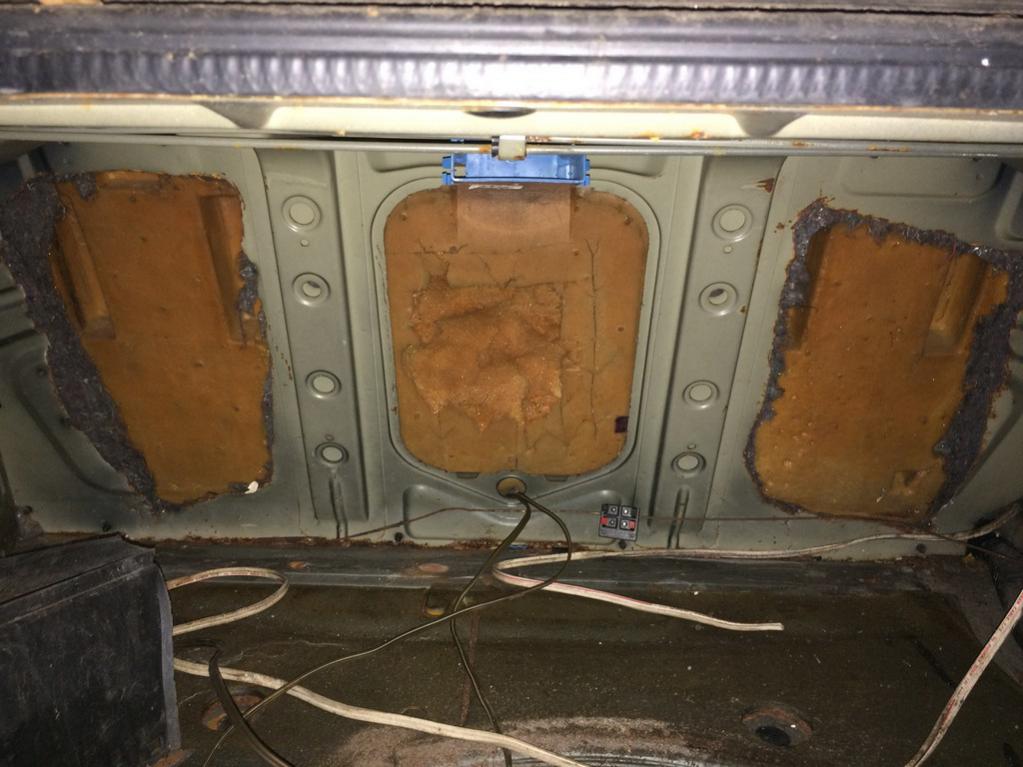

                            Further inspection revealed that the spare tire well was worse than previously suspected. Also there is rust below the driver's side carpet. It was covered with some metallic tape, so the PO knew about it. I would have bought the car anyway, but I was a little annoyed with this. What is with the cut up rear bulkhead. Stupid. I am not building a show car, but this is poor work. I will patch it somehow.

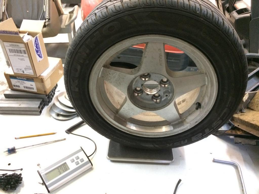

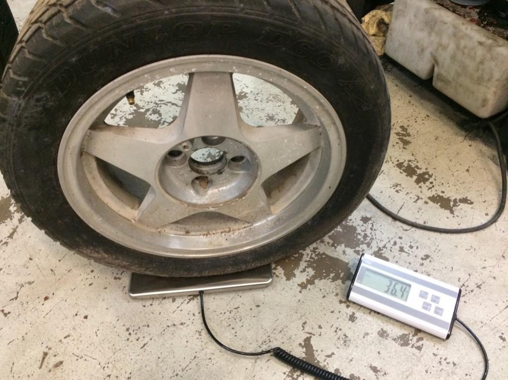

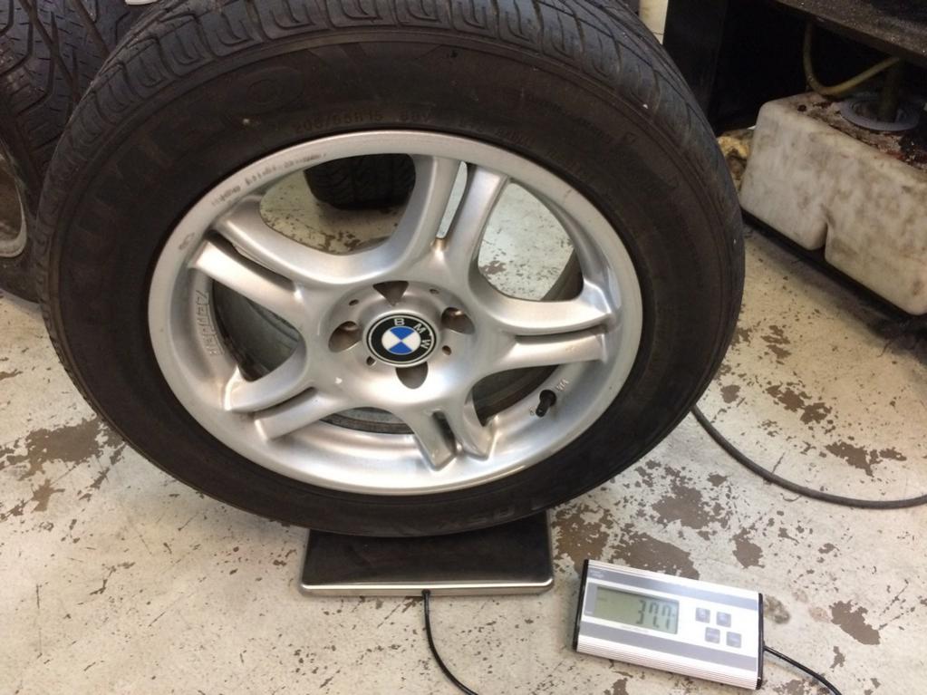

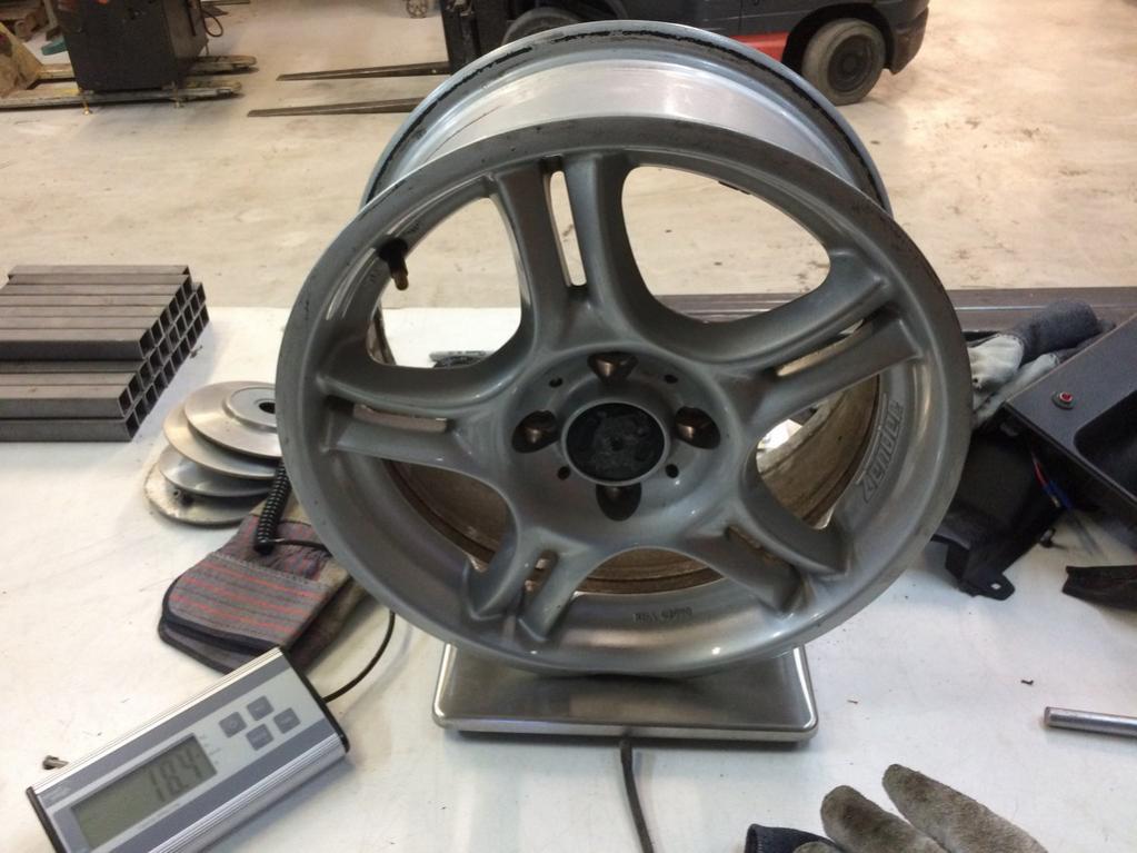

                              The tires it came with were shot. One would hold air for a week. Two for about three days. The fourth tire leaked while filling it. The spare hold air the best, so it gets to stay the spare. They were 205/50R15's. I think they looked a tad small and some internet calculators agree. I bought three 205/55R15's that were mounted to some Zender challenge wheels and one ebay wheel to make four. One of the Zender's was bashed bad. The other two look fine. Hopefully I can sell them. All four good tires are now on the Fitippaldi wheels.
                              Zender Challenge 15 inch wheels with Kumho 205/55R15 - 37.7 pounds
                              Fittipaldi 15 inch wheels with Dunlop D60 205/50R15, dry rotted - 36.4 pounds
                              Fittipaldi 15 inch wheels with Kumho 205/55R15 - 37.8 pounds
                              Zender Challenge 15 inch wheel - 18.4 pounds
