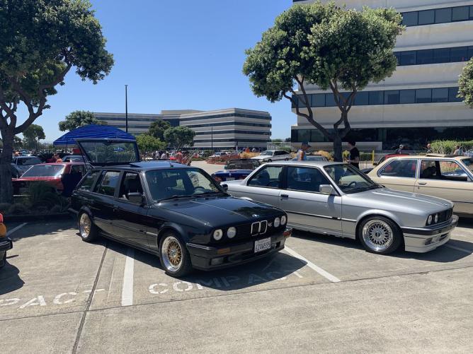

                            And this Diamantschwarz Touring - that was actually imported by my old friend/neighbor from when I lived in San Diego, Konstantin.
