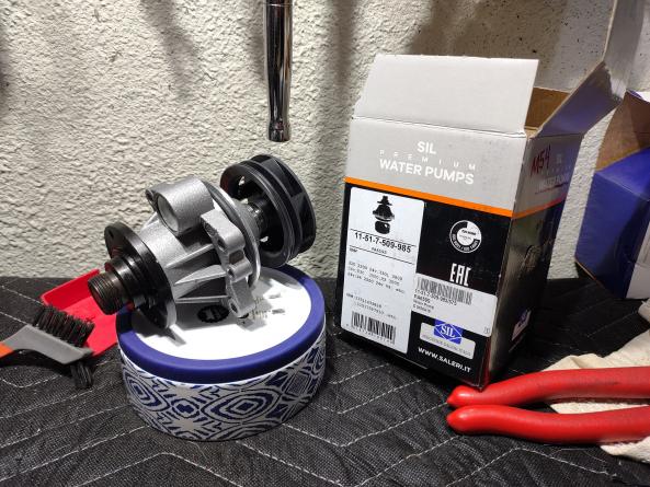

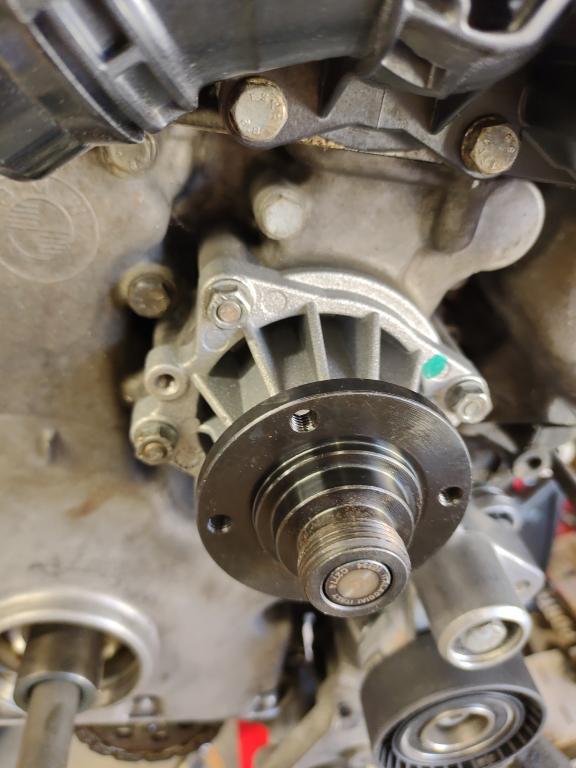

            Another small update on the M54. The other day I wire wheeled the mating surface, and replaced the water pump.
            Here's the pump-hole after I treated the surface
            Here's the guy that went in. It's got the metal assembly with the metal fins, so no plastic./
            The o-ring was a bit too grippy, so I just put a thiiiin layer of anti-seize on it to help the water pump slide into place.
            Here she is all installed and ready for action!
            I was bored, and even took the brass wire wheel to the nuts haha
            it's quite satisfying to watch the hardware turn shiny in front of you

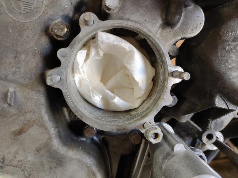

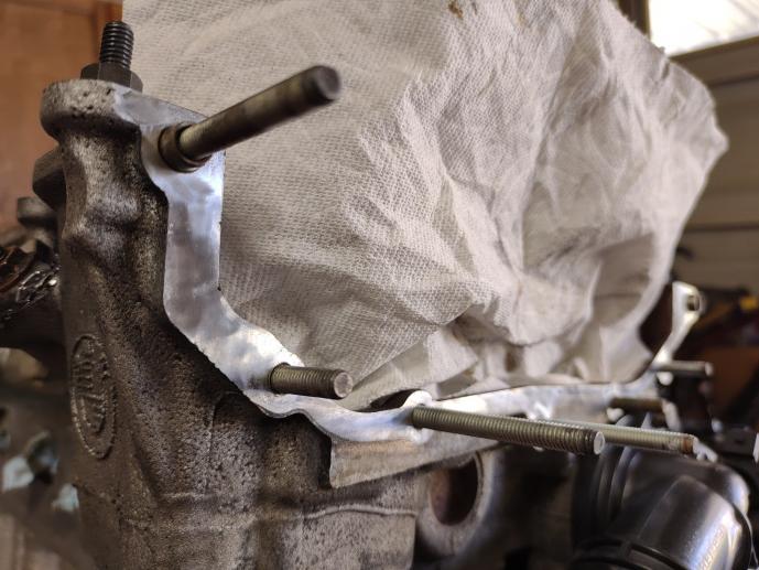

                  Okay time for a long awaited update. I DO still own Ruby, just haven't driven her much since getting my FJ and life moving on, ya know?
                  I got all our cars inspected this last May, and after getting Ruby inspected, on the way home, she started overheating. When I got home, I could see there was a definite coolant leak coming from the radiator. Either a split hose, crack in the plastic, or something to cause a leak and not just a sudden gush of coolant.
                  I'm not going to replace the M42 radiator. I've gone ahead and taken this as my sign to get my ass in gear on the M54 swap.

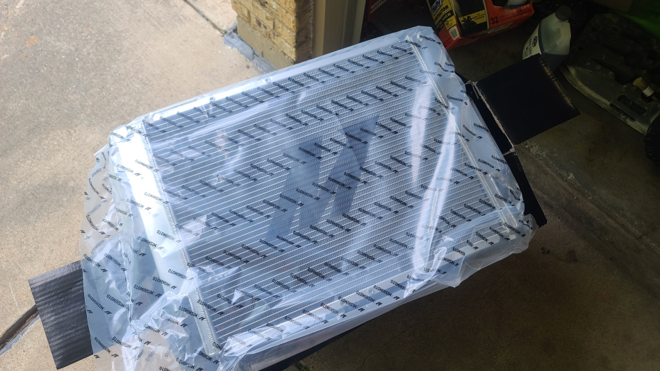

                  First order of business! A radiator for the M54:
                  I got the Mishimoto Performance E30 radiator. Not sure how much adapting and custom work I'll have to do to make it fit in my 4 cylinder (product page specified it was for 6 cylinders), but I've got a welder and loads of little scrap metals and a hard head to make things work.
                  I also got the 6 cylinder E30 coolant reservoir expansion tank, bracket, and hoses to accompany the radiator.

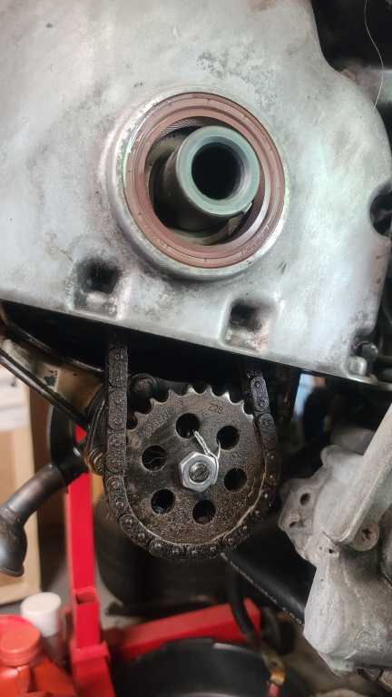

                  Second order of business: I got the safety-wire oil pump nut on and installed, as well as finally smacking in the front main seal using a custom tool I made that fits around it.
                  I just took some old engine oil around the main seal, my tool, and a rubber mallet, and *tap tap tap*ed it in with no issues. No idea why I had procrastinated or felt intimidated by this seal originally.

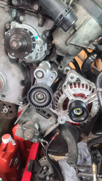

                  Next up was another kind of expensive part I wasn't really wanting to spend the money on: the alternator.
                  I went with the Bosh 120a alternator. Thanks to Amazon returns, this one was like new for $180 or so and looks to be perfect!

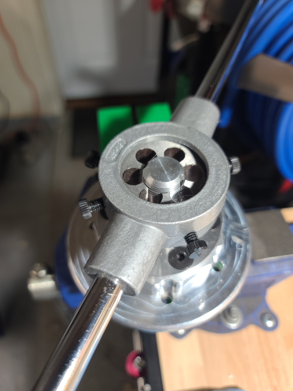

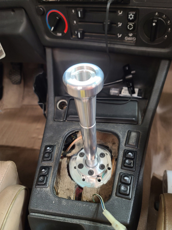

                        Recently, I got the Garagistic Chassis mounted shifter installed.
                        You know...things are a lot easier if you just install them when you get them and don't leave them around for months or maybe a year, allowing the threads to get dinged, requiring you to buy a tap/die kit 😂
                        First time using a die/tap kit, and I'm happy to report I didn't crossthread the die and perma-goof my shifter lmao
                        As required for the chassis mounted shifter, I installed new trans mounts. Went with 95A and HOLY cow what a difference it makes.
                        NHV out the wazoo compared to the OE ones. I have some 85A mounts coming. Ruby is a cool-cruisin' vert, not a full blown race car lmao

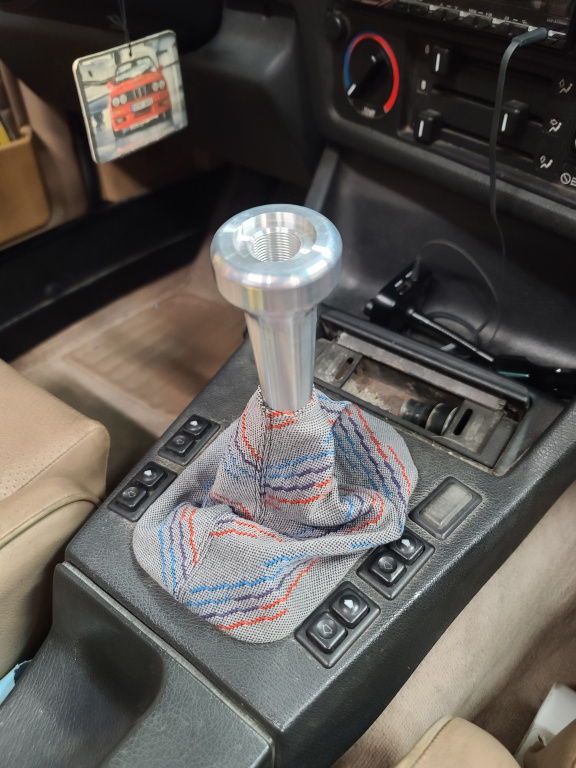

                        My father in law was pleasantly surprised that I finally installed the shift boot he gave me for Christmas YEARS ago 😂
                        For some reason I had always imagined it being this HUGE PITA to install, but I just used some 3M adhesive spray on the boot ring, and pressed the new boot on
                        Click image for larger version  Name:	20250624_131836.jpg Views:	0 Size:	187.3 KB ID:	10141540
                        This is with the short option for the chassis mounted shifter, and I'm tempted to order a medium length one just to see how it feels.
