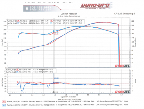

    Hi People, attempted a remote tune session, only got one iteration down until we realized my TPS signal was all screwed up. Some wiring issue it appears.
    However, it is winter in Colorado, first tune is a baseline tune, second tune had some timing pushed up in the 3700 rpm region.
    Report 215 peak hp at the wheels, 195 peak wheel torque... With more to come.

    well from the engine specs i'd be expecting bigger numbers. id still expect to be pretty cammy kind of delivery almost a dip in the 3000rpm rnage with the exhaust setup. the Uk 3L with 288 had that with RHD itbs and its pretty common

    Originally posted by digger
    much better result, heaps more torque. it would drive a whole lot better than the peak hp difference suggests
    the dip at 3700rpm will be in part due to X-pipe location IMO
    The dip is because the base timing map I use on strokers pulls timing at ~60-100kpa/3500+RPM, just like the stock ECU. I then use the dyno to increase it until we find MBT. I wouldn't be surprised if there's another 15-20wtq still left on the table. We made 202wtq with a 2.8, 272 cam and lesser 9.4:1 comp. It's always safer IMO to be conservative on the street tunes, then ramp it up - specially when remote tuning.

  • digger
    replied
