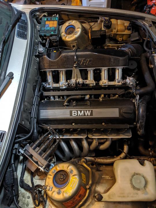

  • mrlucretius
    replied
    Dbilas ITBs for sale (SOLD).
    RHDs are installed.
    Butt dyno says lost a touch on the topend, but feels much better midrange.
    Also ICV is up and running.
    Waiting for a new tune and some dyno time.
    Stay posted!

  • mrlucretius
    replied

  • bradnic
    replied
    SUB'D. I have plenty of dbilas info on my vert build thread. digger will confirm the bores are too big for stock displacement. I'm installing a 3.2 metric mechanic motor in my vert this fall. keeping the dbilas setup for now but if I run into issues RHD with CF plenum will replace it.
