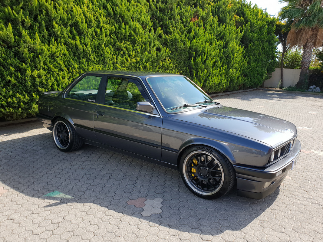

    Hello to everyone.. I am from Greece and my car is a '89 coupe 316i.. I bought it 2 years ago as you can see it in the first photo..It's not finished yet, there are a lot of more things to do..
    Specs: 318is M42 E36 stock
    D2 Coilovers
    325i brakes
    LSD Medium Case 3,64
    Sparkling Graphite Colour (A22)
    M-Technic interior
    318is look
    ASA AR1 Wheels 17x8 - 17x9 Black Matte
    Smoked Lights
    OMP Dished Steering Wheel
    Μy first car:
    '89 Ε30 Facelift 316i (M42b18 E36 swapped) COUPE
    BMW Sparkling Graphite , Lenso BSX Gold 16x7.5/9.0
    D2 Sport Coilovers Drift Spec , M Technic Interior

    Quite the transformation there compared to the first photo. Looks nice! Welcome to the forum.
    • laidback93
      • Nov 2016
      • 435
      Wow what a looker. Love the look you've chosen.
      90 Bronzit 325is
      16 Black Sapphire 340i M Sport
      • 2mAn
        SeƱior Mod
        • 21076
        Whoa!... Other than the taillights, it looks awesome!... I think a candy red type taillight would be better fitting

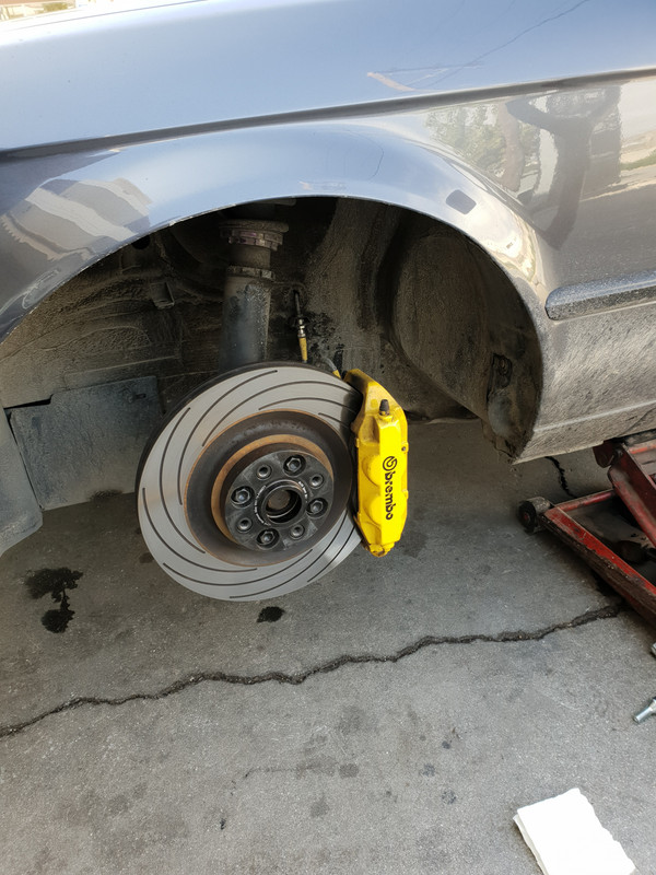

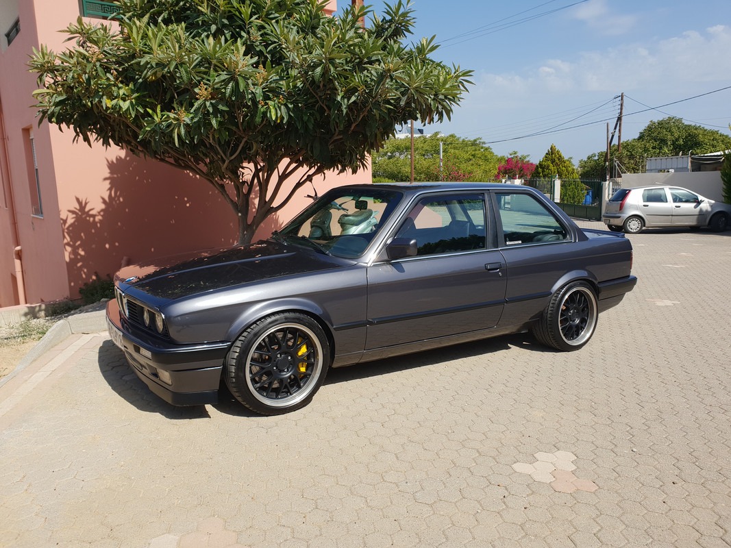

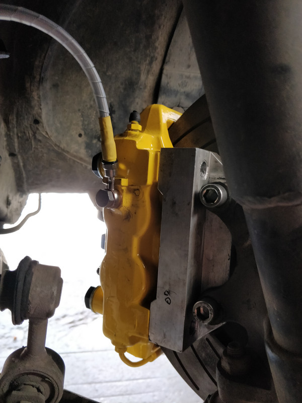

                I recently upgraded my brakes!
                In the back i replaced all parts with new but stock
                For the front i bought a set of 4pot Brembo calipers from Renault Megane RS 225 and Tarox F2000 323x28 rotors from Seat Leon Cupra R with Ferodo DS2500 Pads..
                The result is here, and now the brake quality is waaaay better,even without ABS system!!

                  Can you post some more pics of the brake setup?
                  • Dimitris4978
                    • Sep 2016
                    • 9
                    Of course.. Here are all photos i have from the brake upgrade..

                      Nice! What about the brake rotors themselves?
