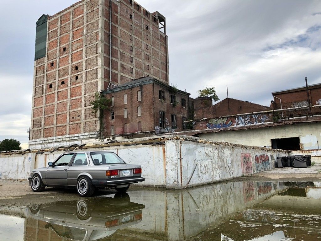

    Getting around to a build thread, soon to come. Project hasn't really begun, Project far from done.
    But it has been enjoyable to get the car out and putt around.
    Enjoy!

    A proper car in a proper location.

      Great pics!

        Nice shoot, nice car!

          whats your suspension setup for the turbines? they look great

            MCS 2 Way remote, Turbines / msystem’s are 17x8 205/50R17
            These are kind of like filler wheels. I robbed them off my 318Ti. Once I get my rear toe and front caster sorted I’m going to get it on the scales and do another alignment. I have 17x9 et30 apex arc 8 with 245/40R17 waiting. 205 isn’t enough tire.
            I Have like 1/32 toe in on the rear and 12* caster up front.
            I swapped eccentric subframe to posi lock (IE) serrated setup. I just have to yank it out and machine the toe slots a bit more.
            Currently 96 m3 arms, going to try 95 m3 arms. If that gets me to 9* max I’ll be happy. Then maybe consider E46 arms (I’m not a drifter) for widerbody figment. (+54mm front track)
            They’ll go back to there home hopefully soon!
