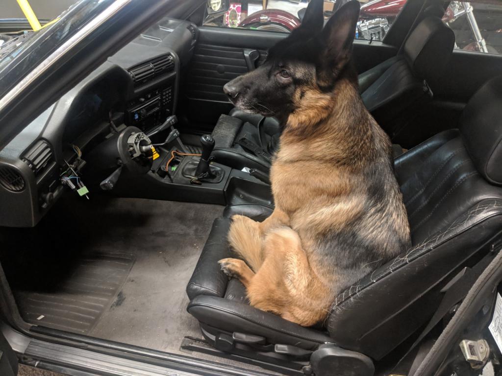

    I actually just finished lowering the steering column! Just needed a pilot chamfer and an extractor for the two anti-theft bolts. Took about 5 minutes after disassembly and planning. Easy!

    All right, enough already. Who wants to see my little German bitch?

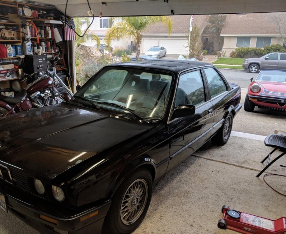

    And here's the ride too! :hitler:
    "It wouldn't be there if it wasn't..." - Milton Berle
    1988 325iS - M20
    • e30davie
      • Apr 2016
      • 1788
      Cool, but whats going on with that Alfa!?!

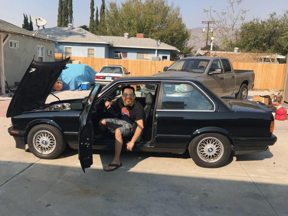

          Heres the pic he sent me when he first bought the car... just look how happy he is
          Car has a nice stance too

              Lol Simon! Holy cow I look stoked lol
              Hey Davie,
              To answer your question it is a 1978 Niki Lauda Spider Veloce 2000. Fully and faithfully restored bumper to bumper by yours truly except for the paint. That car is done and completely stock. Won't be changing a thing on it either as I think it is an engineering marvel in its original form! I did keep a thread on it on AlfaBB but I was terrible at keeping it updated. I was really good at asking a fuckton of stupid questions, though...
              I'm actually still really good at that now that I think about it...

                Gorgeous GSD.
