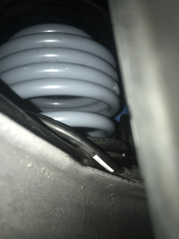

                      I recently installed H&R OE sport springs and bilstein B6 shocks and what you see below is how the rear springs sat with the weight of the stock 4 door on them. I couldn’t live with it so I put the stock rear springs back in. Car felt really strange to me. Jeffnhiscars told me they were supposed to be like that, and I do believe him to be correct, but I just couldn’t live with those springs on the rear.
                      I absolutely love the sport springs on the front though. I also installed the IE 22mm front sway bar. My car really didn’t end up any lower and the feel and driving manners are just fantastic.
                      I’m also of the opinion that the pre facelift e30’s look better lowered a bit than the post facelift ones. Something about the rear wheel well on the older ones.

                          The rear spring like that doesn't seem good at all. Good idea putting the stock ones back on.
