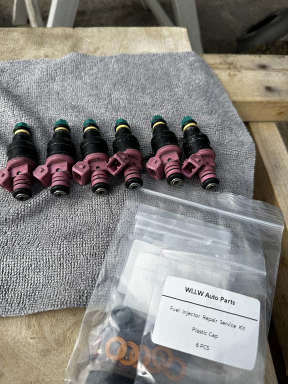

          #64
          Had to update to the 24lb pink injectors, was running out of fuel at top end (she screams to 7100rpm), much better now, she pulls like a freight train, amazing how well the M20 reacts to the stroke increase and compression bump, pulled vs a buddies E30 with S52 swap and he couldn't keep up

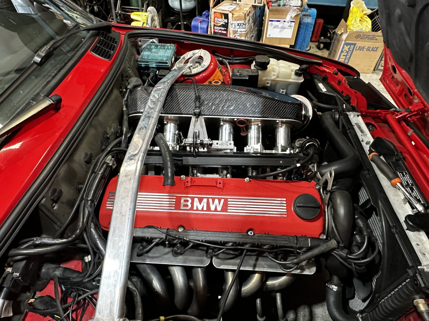

            #65
            Hartge valve cover was leaking a bit, so have to get it fixed, swapped in the stock one with a lick of crinkle paint
            managed to finalize the street tune, cold idle, all the little bits of fine tuning
            she runs amazing now, couldn't be happier
            such a beast
            pulls so hard, very surprising how much difference the torque and compression bump makes
            Highly recommend the stroker upgrade to anyone with an M20, she's livelier then S54 swap e30s for sure
