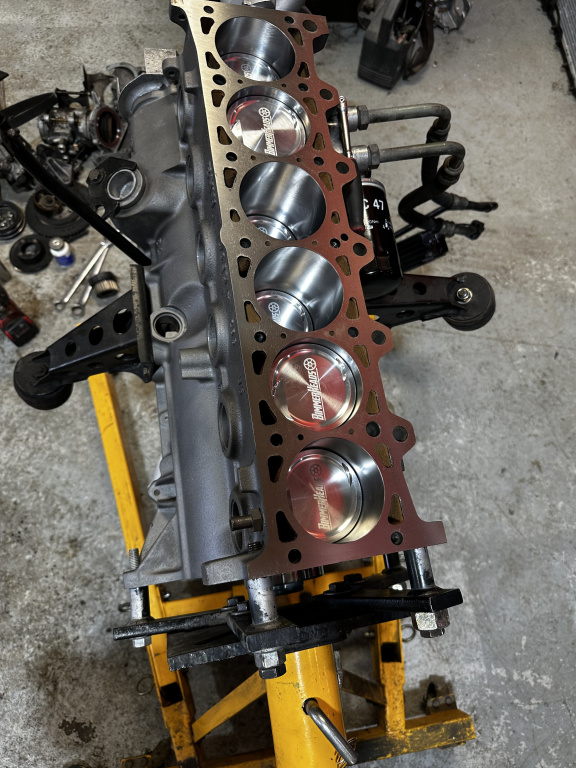

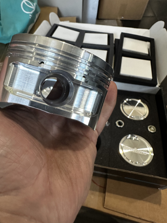

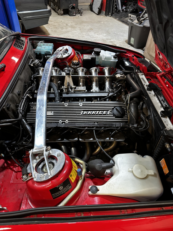

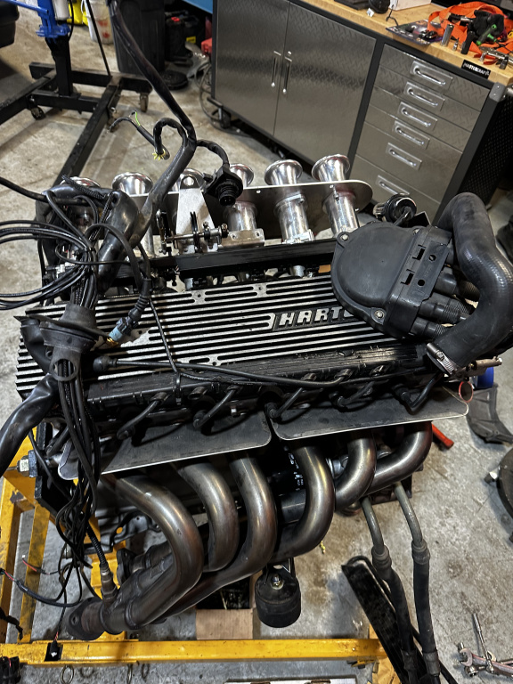

                  #53

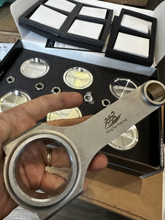

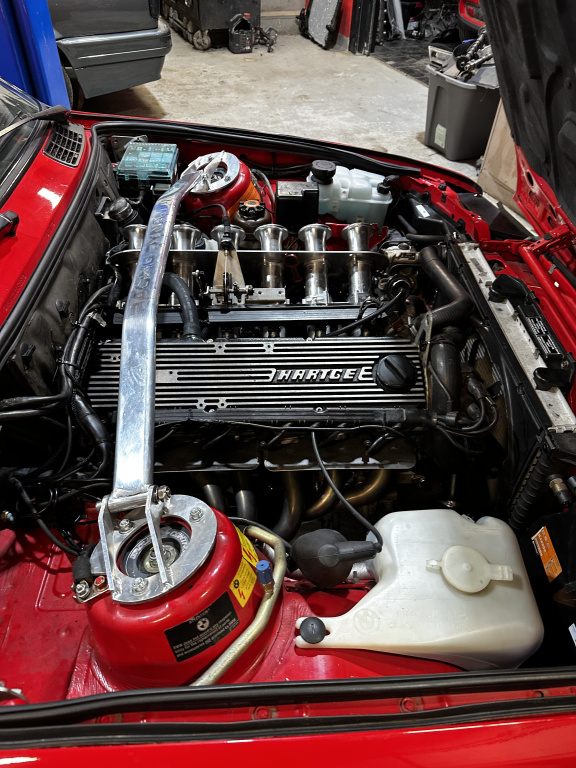

                  Finished my 3.1 build and Install
                  • peteb3
                    • Nov 2009
                    • 163

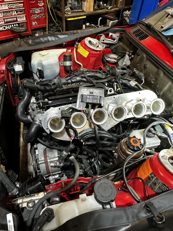

                    #54
                    She’s definitely picked up up a ton of mid range torque

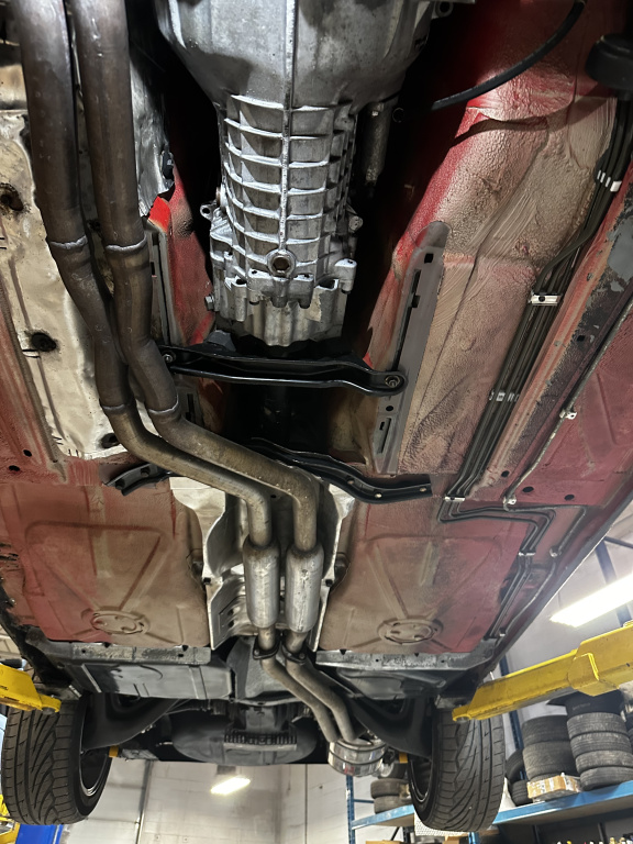

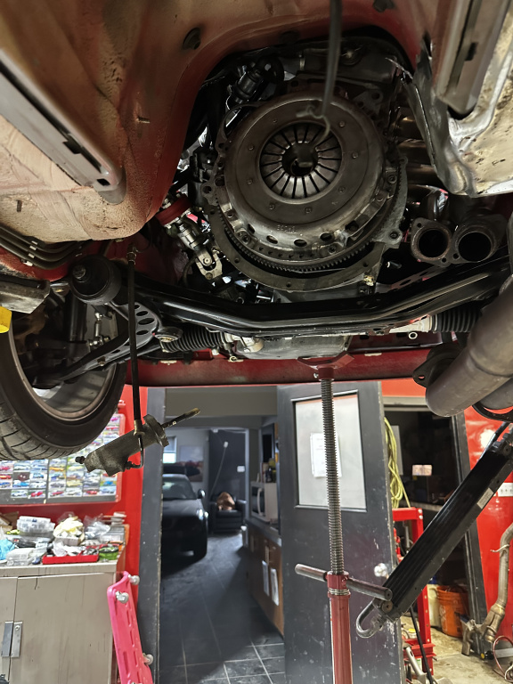

                        #56

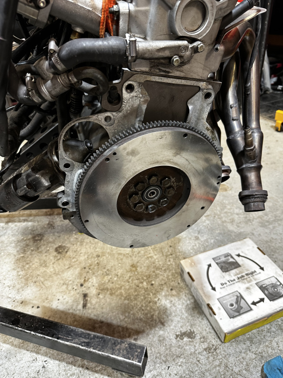

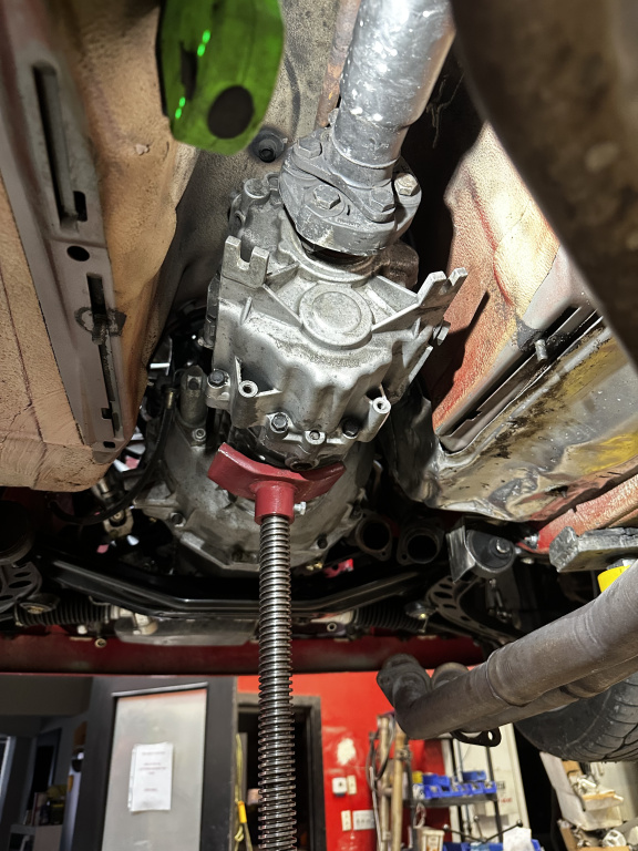

                        Wrenching

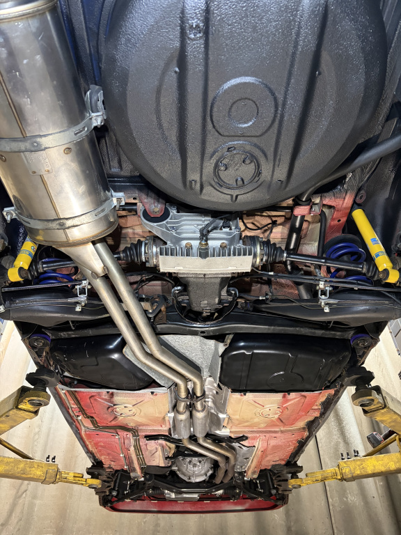

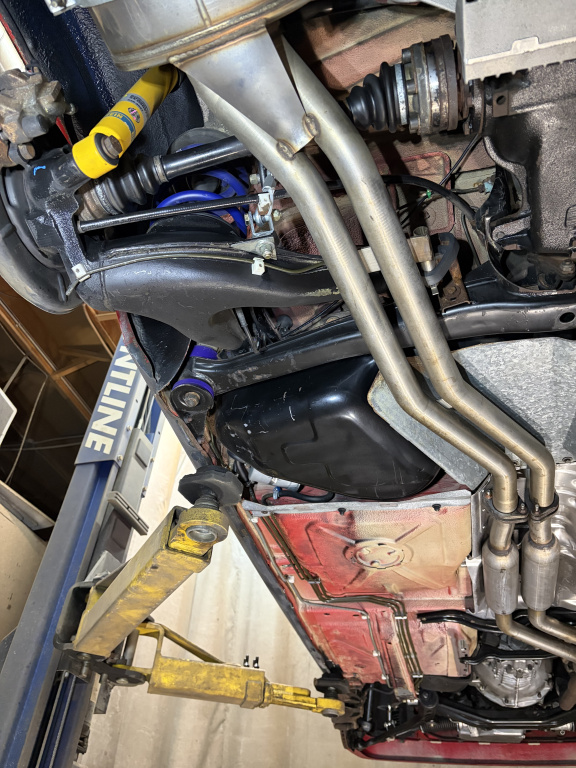

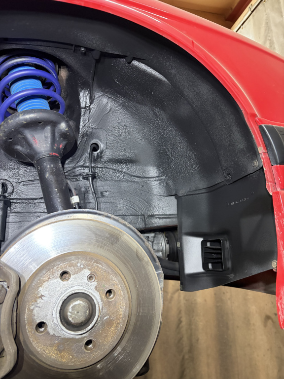

                          #57

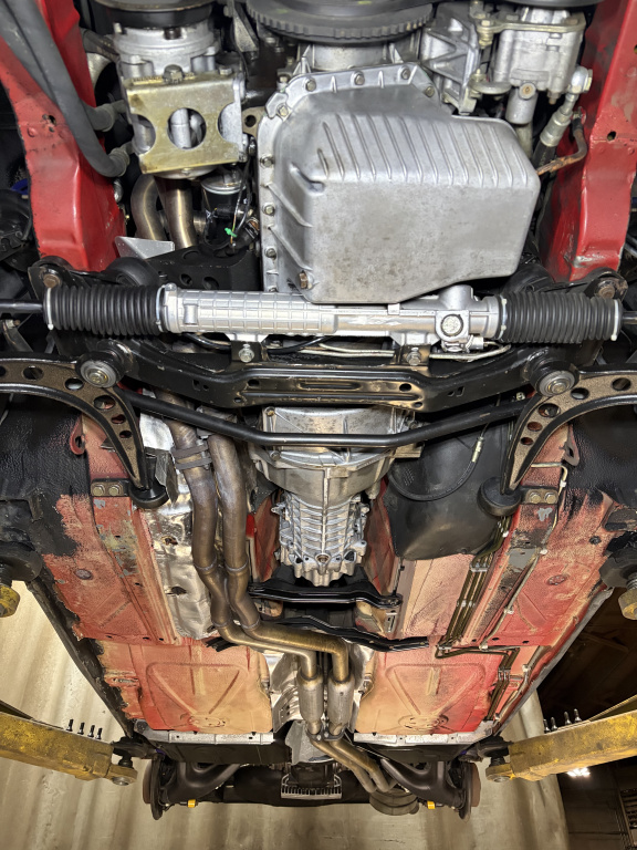

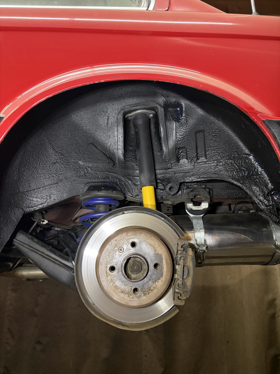

                          Had the chassis dry iced
                          highly recommended

                            #58
                            how is the sound with the displacement change?
                            • peteb3
                              • Nov 2009
                              • 163
                              #59
                              very very mechanical, quite different for sure, the 15mm extra stroke and compression increase sure makes an impact

                                #60
                                highly recommended
                                Did you have to do any rust repairs? Did they coat it with any rust preventative after?
