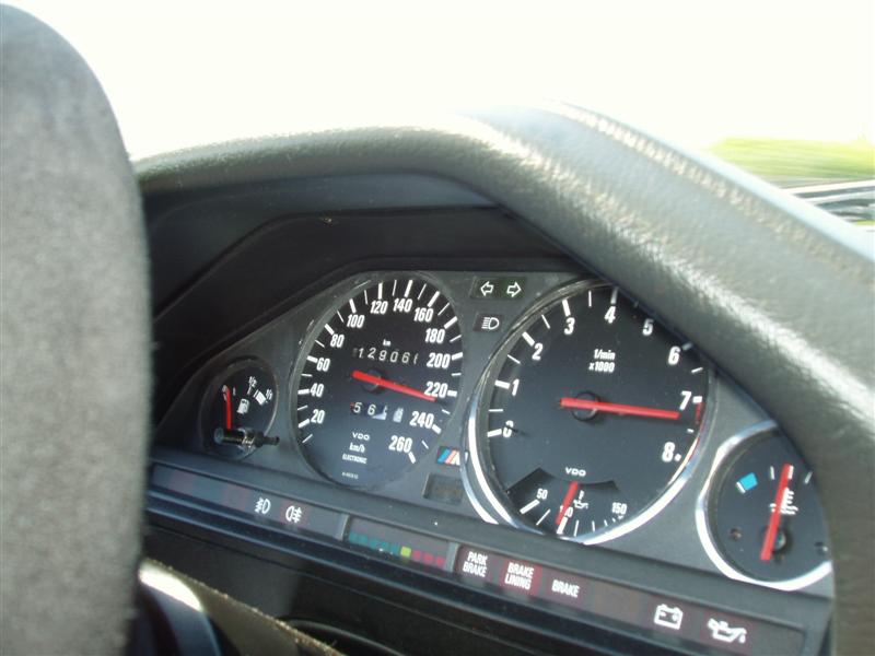

                        As far as my experience with difs goes- My M3 with euro dogleg is 1 to 1 trans ratio. it is stock 3.25 -- I had it honestly on a down hill on the german autobahn doing 265/270kmh at about 8700rpms. It was F***in scary, car was blowing all over the road!!!!!
                        I traded it out for 3,64 and now it is at 220kmh at 7000rpm-- more than perfect for me, I dont care to take the car to too high of speeds but for short sprints nowadays.
                        I also know someone else here that has a euro trans in his m3 and is running a 3,91 in it. it seems WAY to short in 1st gear for me to be worth it, but he can still pull on me like crazy at the 120 mph range.
                        but the M3s S14 can rev higher, so...
                        now, I know that my old M20 car with the overdrive bounced off the rev limiter at 225 at 6700 rpm.
                        In the states, I dont imagine your going to be doing too much HIGH speed driving, so i would set it up for the take off.
                        I would think the 3,73 would be great, but thats just me.
                        never mind the "ring that is hanging off, it was fixed after the pic.

                          I think I want to add chrome guage rings, but it would suck if they kept falling off. I want to add the AC pedals and a nice subtle chrome and black shift knob/ebrake lever. I think itll really update the interior nicely. I cant stand the cheap plasticy knob Ive got in there now.
                          Back to my roots
                          • mikeedler
                            • 6707
                            #43
                            they make alot better ones these days, these where the "prototypes" from about 4 years ago, the new ones clip on. these only came loose the one time, and I think it was cause I was hitting mad V techs yo!!!!!
