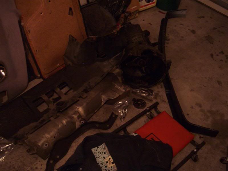

    The pile o' parts...

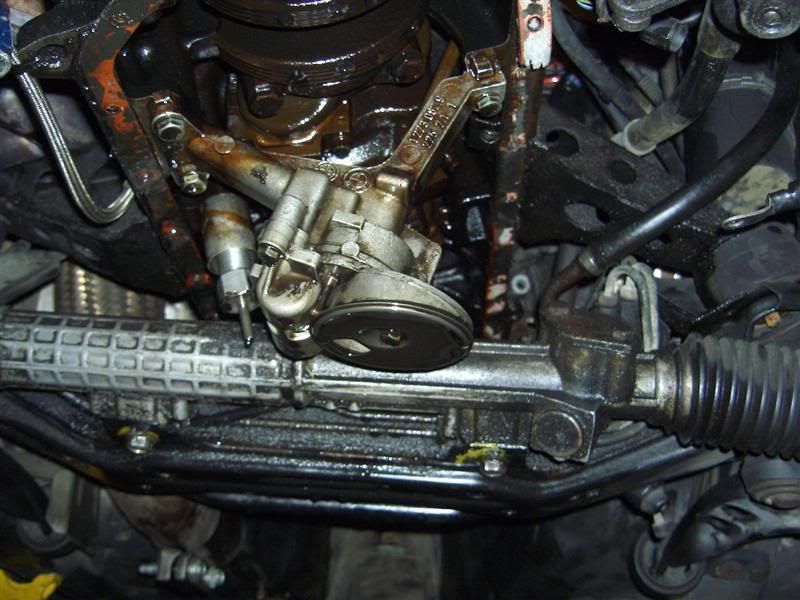

    Pulling the pan.
    The 260 out of the car...

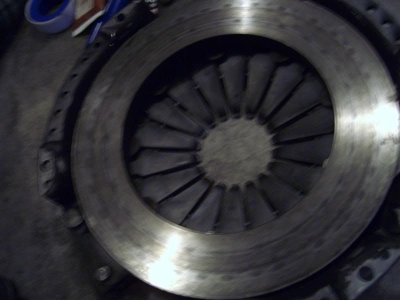

    The stock pressure plate and disk have seen much better days..

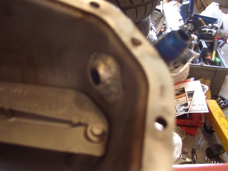

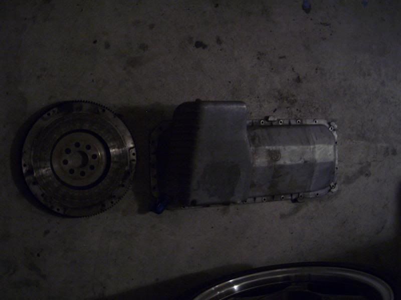

    Flywheel waiting for resurfacing and pan waiting for welding.
    Welded return instead of a bulkhead fitting (CRAP)
    Refreshed pan in and new urothane mounts (My friend Sam showing his appreciation for the project...)
