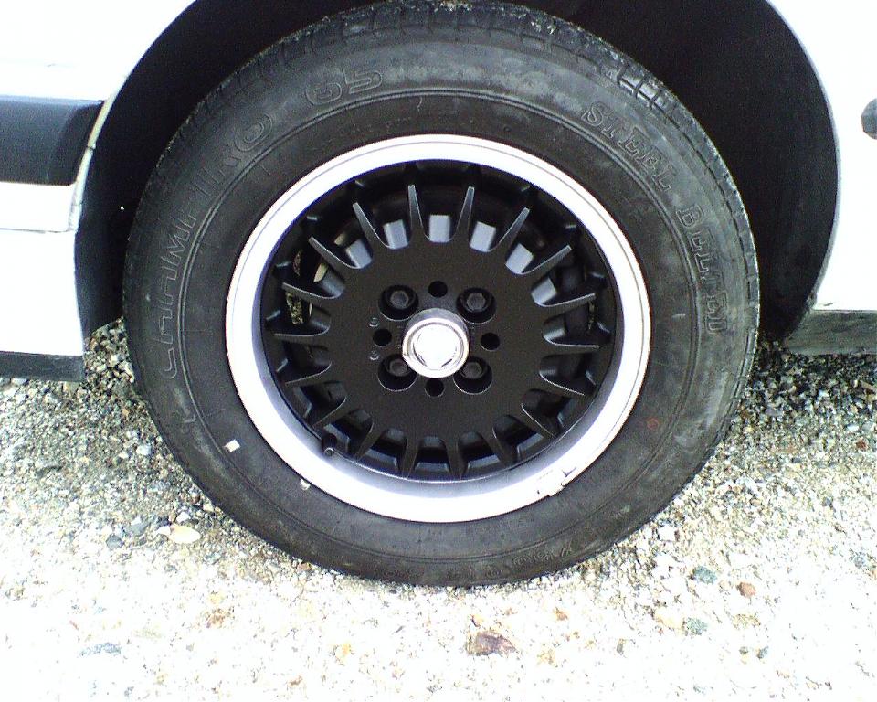

              i just did the black center with a silver lip. looks ok. temporary fix to the ugly.
              def plan on getting something different though.

                    Originally posted by JamesE30
                    Thankyou!
                    No more than 2 days ago I was considering doing the exact same to my bottle caps, and now im inspired!
                    How would you go about painting them, just a rattle can or proffessionally?
                    i photoshopped it on my car (dark grey/green duco) an i recon it looks sweet.
                    Anything to spruce up what i got untill i move on to bigger and better things.
                    if you want it to last.
                    degreaser and scrub HARD with scotch brite. it'll scuff up the clear so the paint has something to stick to. then wash the degreaser off.
                    mask it all off and then use rusto. this paint is tough as nails when dry and sticks pretty well to most anything. they have flat/satin/gloss black (if you use the gloss black you can even spray 1 to 2 coats of automotive clear on to make it last even longer). choose what you want and spray 2 to 3 coats on. anything more will probably start flaking off the wheels.
                    let it dry completely before putting them back on.
                    set aside around a day and a half to do all of this.
                    if you wanna do it right...
                    if not. just spray and go :)

                      this is how mine came out using that^ process
                      This is Satin Black by the way. i love the finish of it.

                            • JamesE30
                              • Feb 2007
                              • 2092
                              thanks jesse30
                              i wanna do it right 1st time
                              so i recon ill do them the exact same as yours, i really like the kept polished lip and center caps.

                              • Jesse30
                                • Jan 2007
                                • 3936
                                thanks jesse30
                                James
                                glad to help. post pics with your results.
