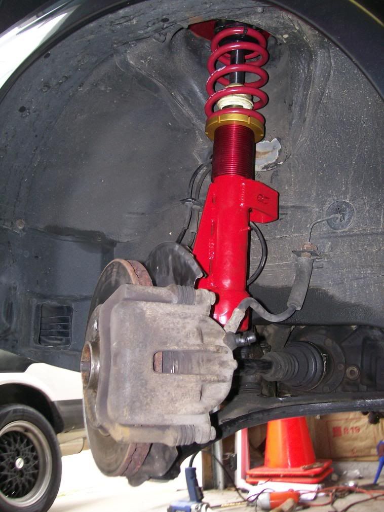

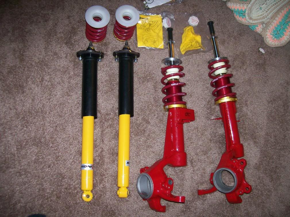

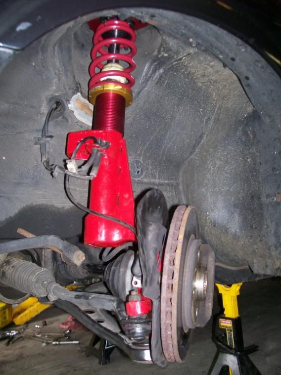

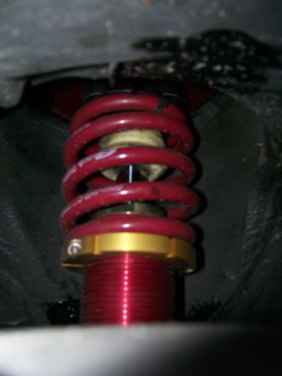

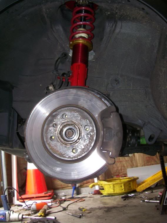

    Hello coilovers.
    GC kit with shorten struts... W/ 525F 650R
    And what this? Looky here

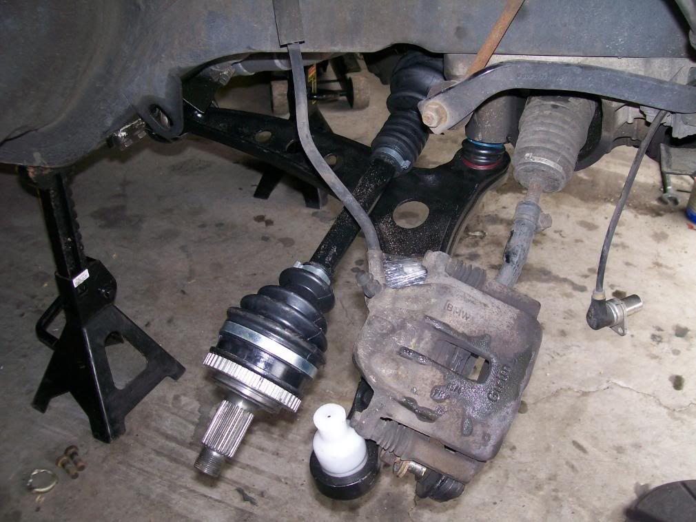

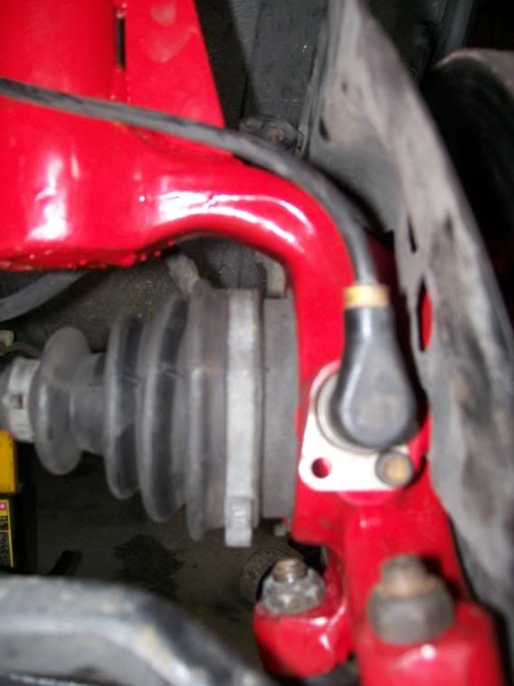

    New R. Axle boot kit. New R Control Arm(L. side was replaced during the summer time.) New wheel bearings also.

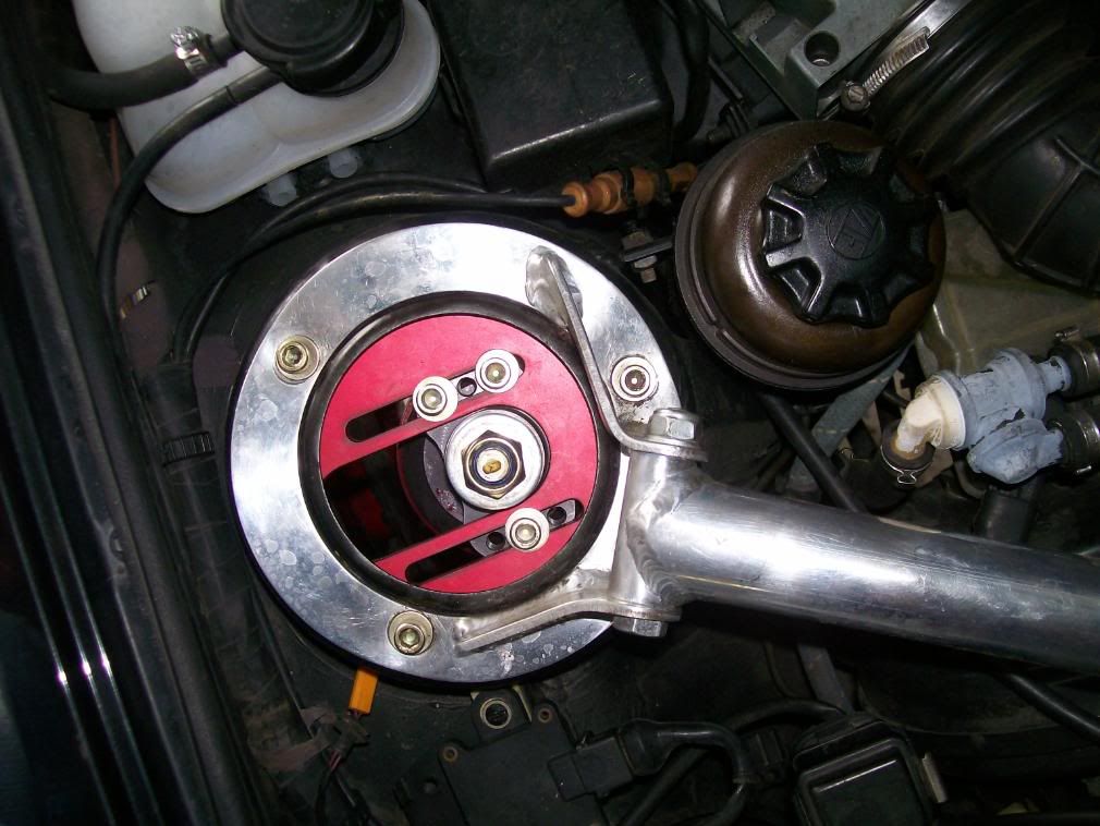

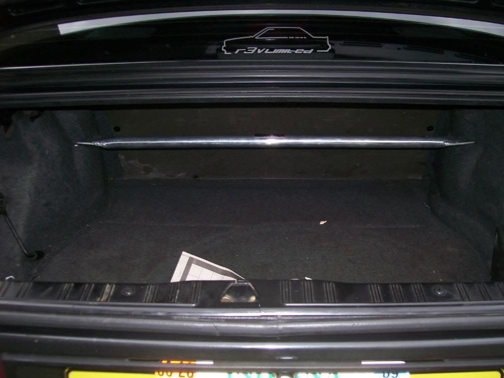

    Rear strut brace w/new koni adj thats adj from top instead of unbolting every time...

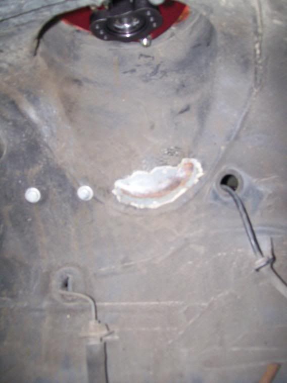

    My old set up made my lower spring perch's hit against the inner fender well????
    Old set up: H@R sports (cut front springs) W/ koni adj.
    This set up rides better right know even though the dampeners are set to soft. Cant wait till I crank them up. No pics of the stance right now.... But I sat the adjusters to all the way up. Its not to "bad" looking. I do plan on dropping it a bunch but first I want to get it on the alignment rack and see were my spec's are at. Just courious how much pos. camber it'll add once I drop the front.

      Who did the work on the strut housings?
      • moatilliatta
        • 6138
        GC - I talked to Jay about them mostly.

                    I'm so getting the top adjustable rear Konis next time. I love my shocks, but that unbolting the rear shit to adjust them sucks ass.

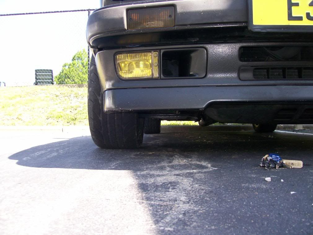

                          Finished pics
                          Current ride high with the adj all the way up.

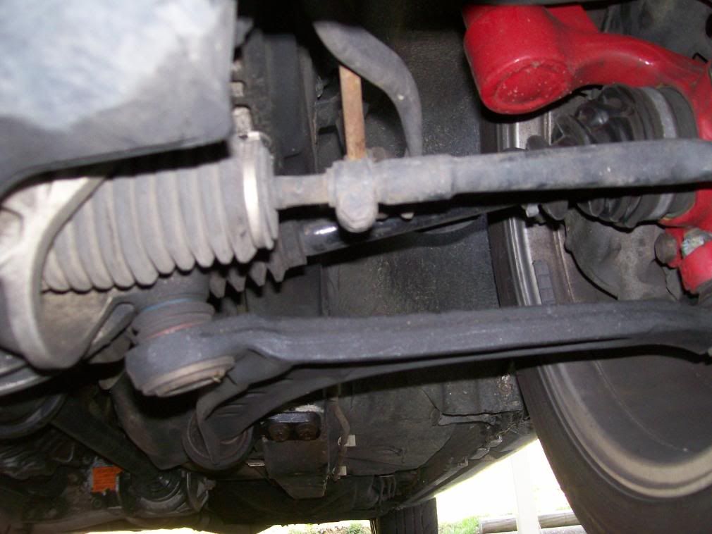

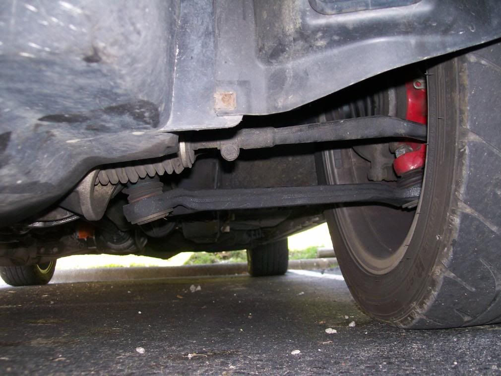

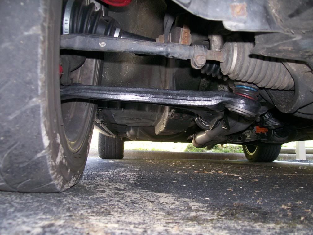

                          Front control arm and Axle angles
                          It doesnt really set low "low" but I am loving the stance more. Still need to get it in for an alignment though..

                              i say slam that bitch and do a quick photo shoot then raise it back up so you dont DESTROY your control arms
