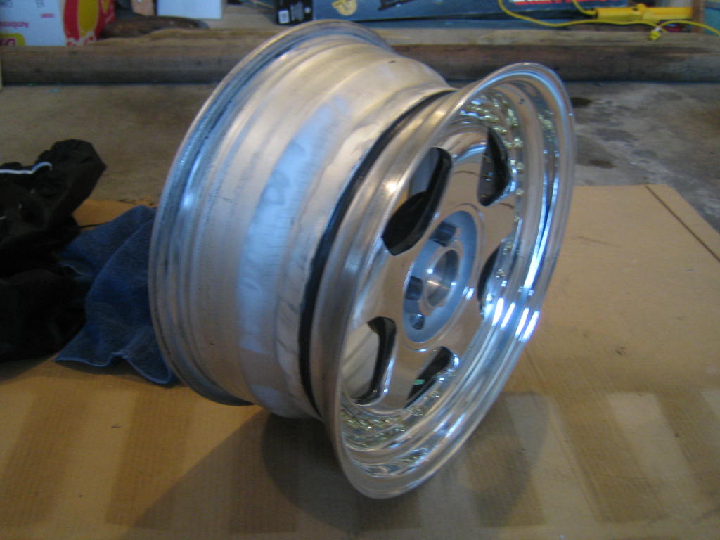

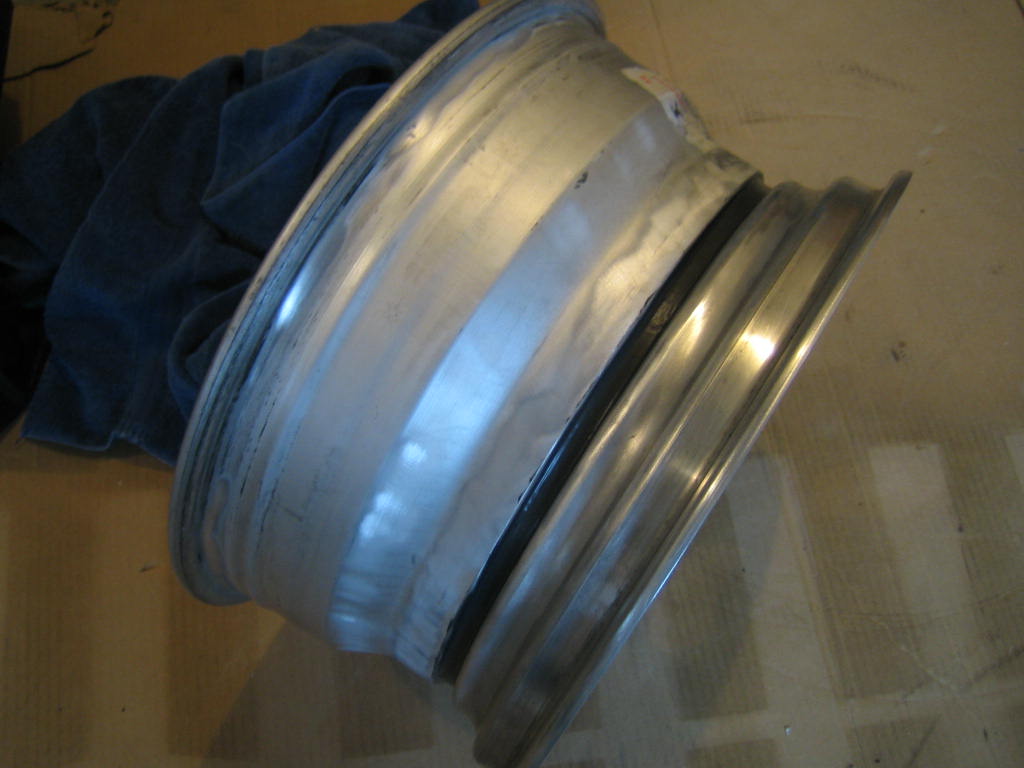

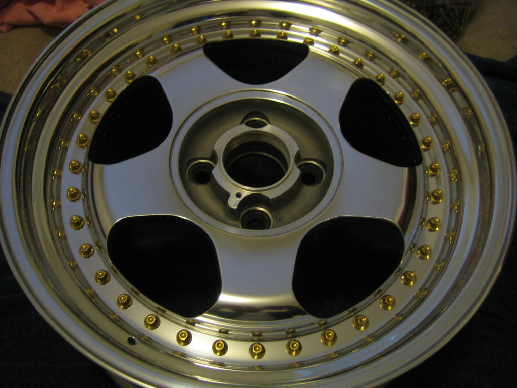

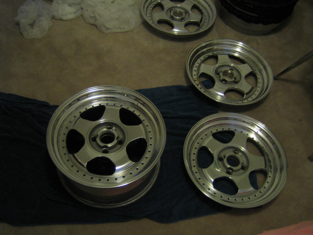

    I didn't seal the faces, got salt on them and forgot to clean the wheels right away. I couldn't polish off the oxidation so I took the wheels apart and sent them in for a deep polish and ordered brand new stainless steel hardware from Germany to put them back together.
    If I knew how much this was all going to cost due to my mistake I would have sold the wheels and bought some 16" 3 piece Hartge instead. :(

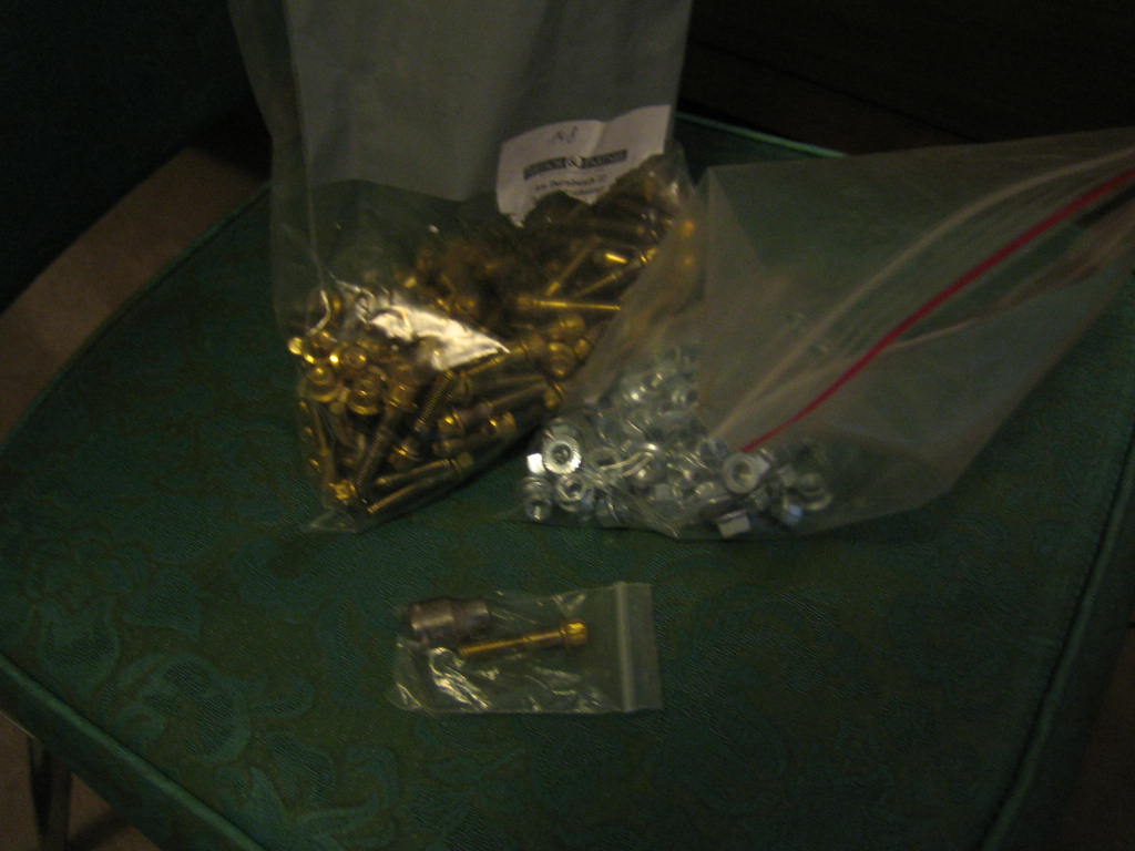

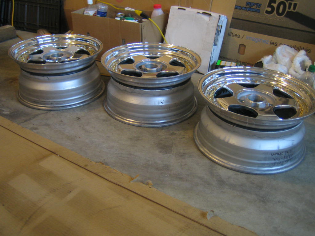

                    It's been almost a year since I had the 3pc wheels disassembled and polished so I thought it is time to finally put them back together.
                    Here are some of the pieces
                    The new stainless steel hardware from Germany

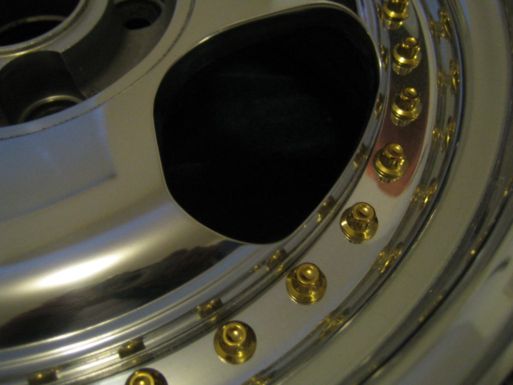

                    Bolts inserted
                    The cheap asian labourer I hired

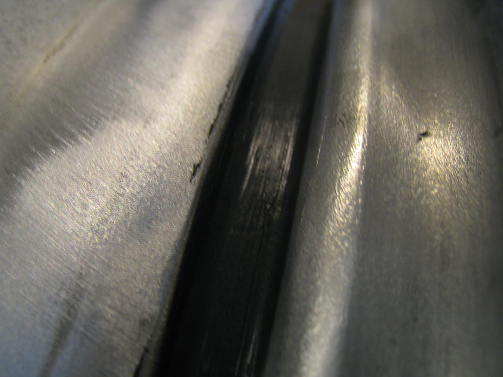

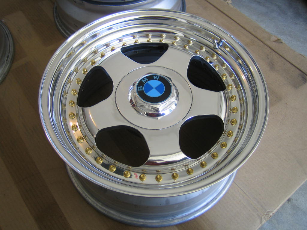

                    Once all the wheels were assembled and nuts torqued I got some RTV sealant to seal up each wheel. Being OCD doesn't really help with speeding this part of the process up

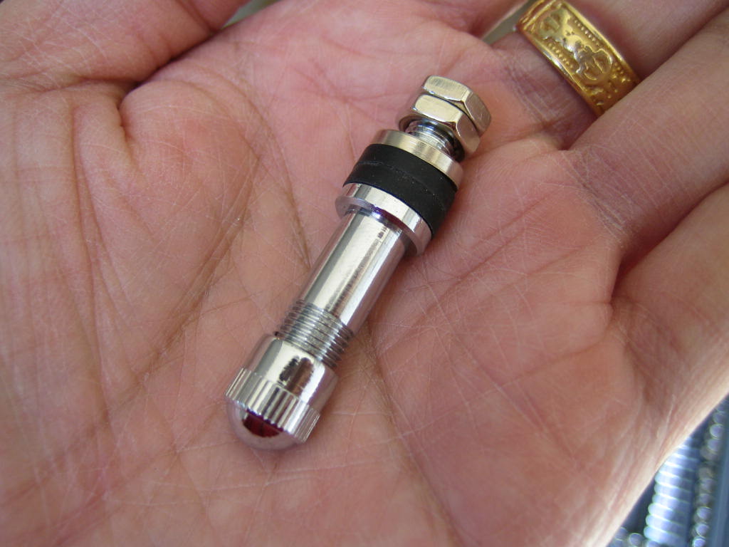

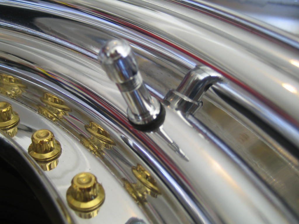

                    The Kodiak lips require a 6mm velve stem so I picked these up at the local Harley Davidsen dealership

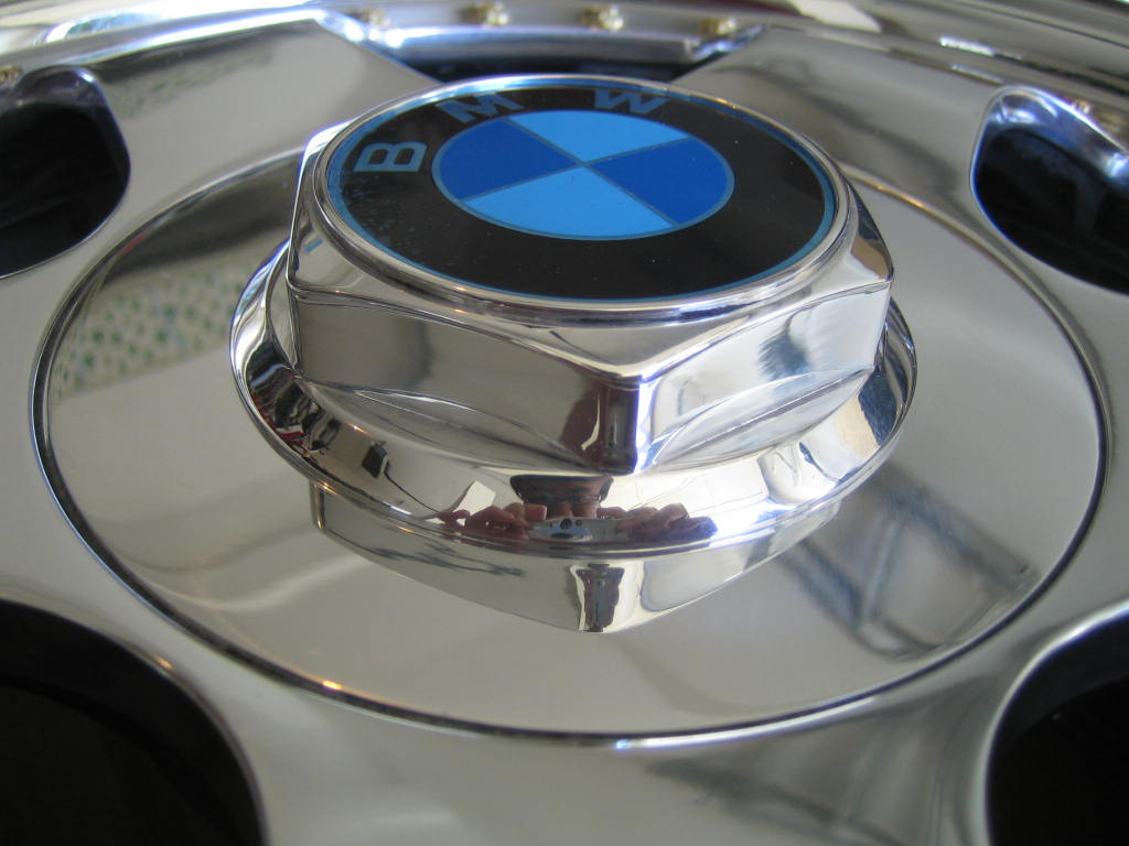

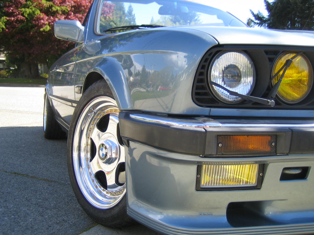

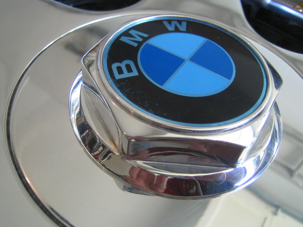

                    Finally get to test fit the centercaps I had made last year as well

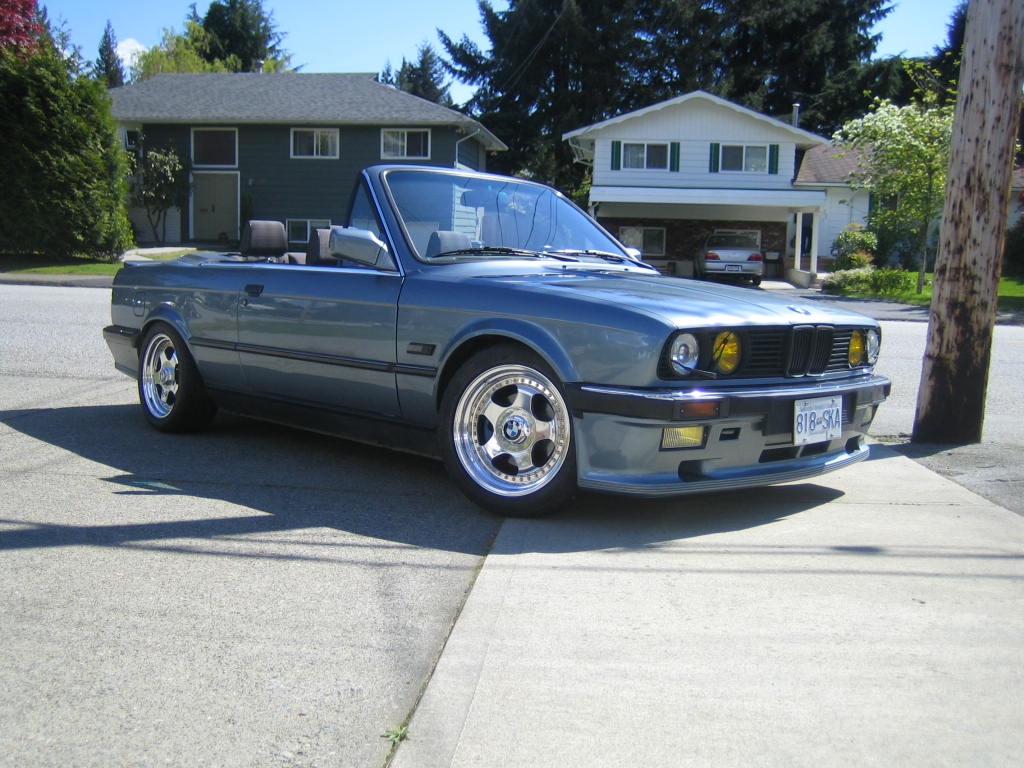

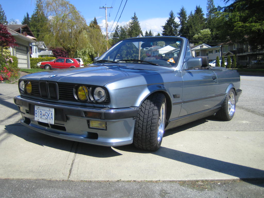

                      I think I liked the old wheels better. Nice car though.
                        clean car op
                        e24 e9 e30
                        IG: peterkaczynski
                          Thsy came out looking nice. Huge difference.

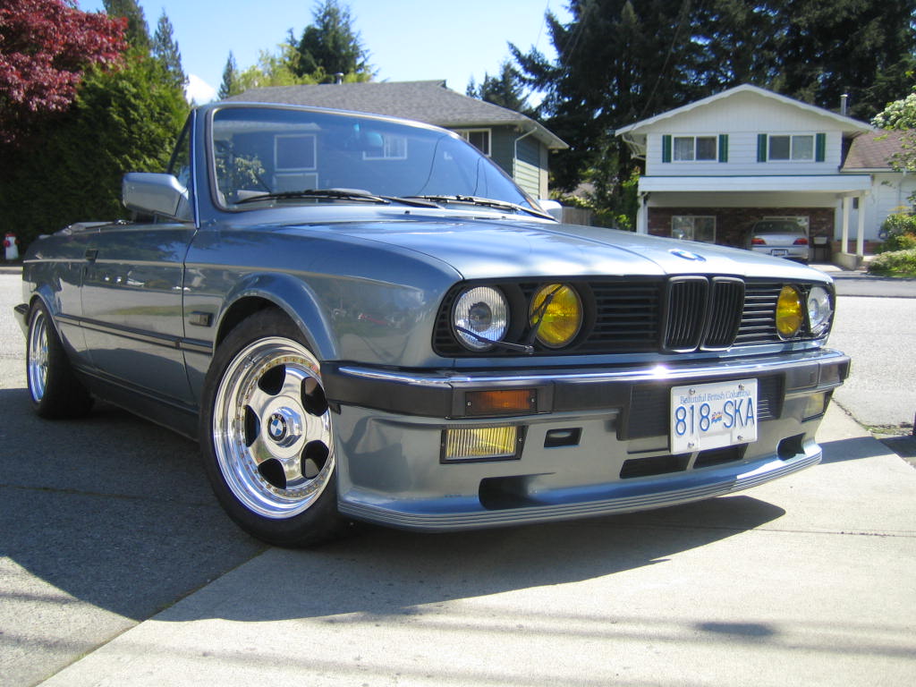

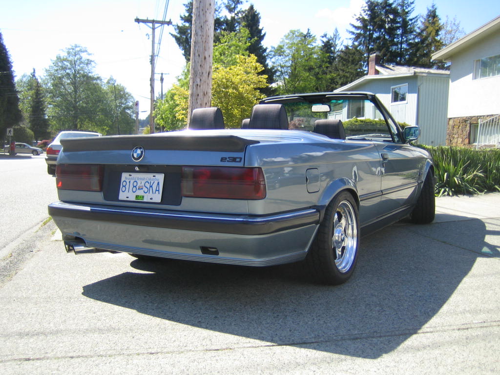

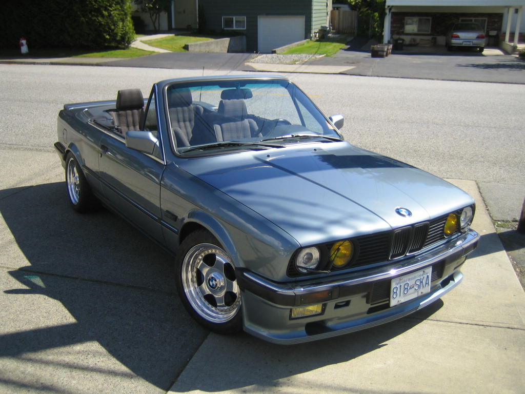

                            The e30 is back in summer mode with its new shoes

                              Looks clean. What exhaust is that?
                                What tires are you running (and what size)? Those look beefy... in a good way.
