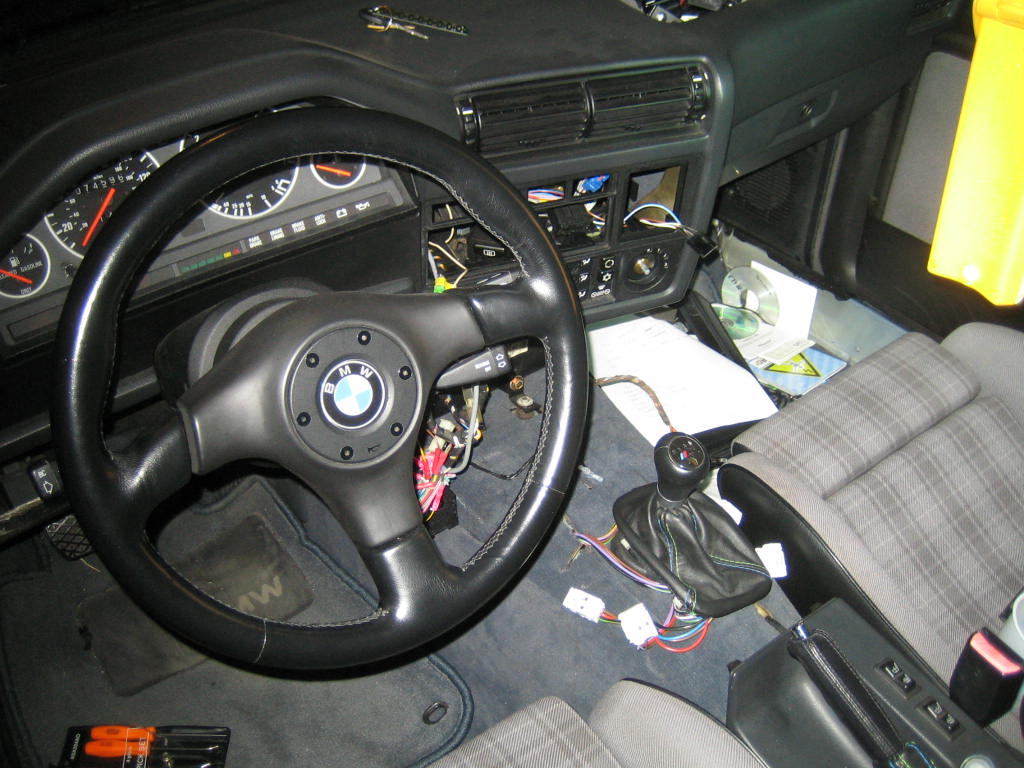

              then I proceeded to take the interior apart to get at all the wiring...
              I realized afterwards that being OCD, a perfectionist, not searching online BEFORE doing the work, reading up on said research made an afternoon install turn into a 5 day and night ordeal.

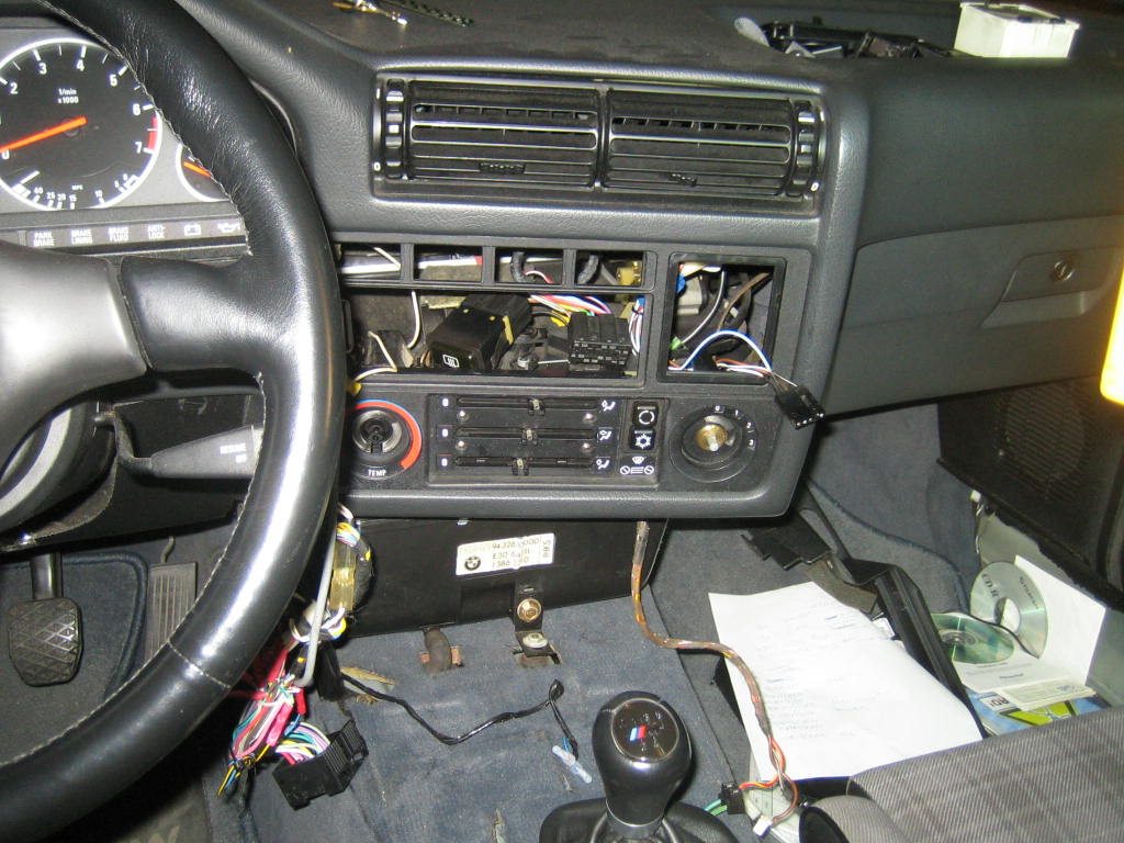

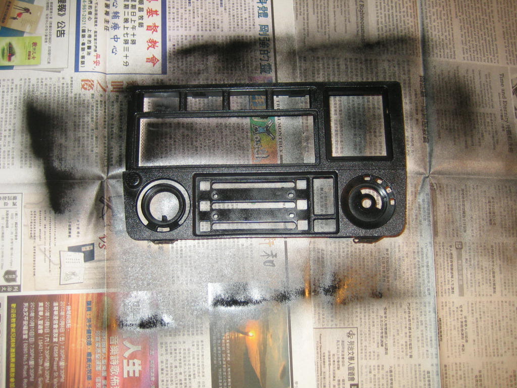

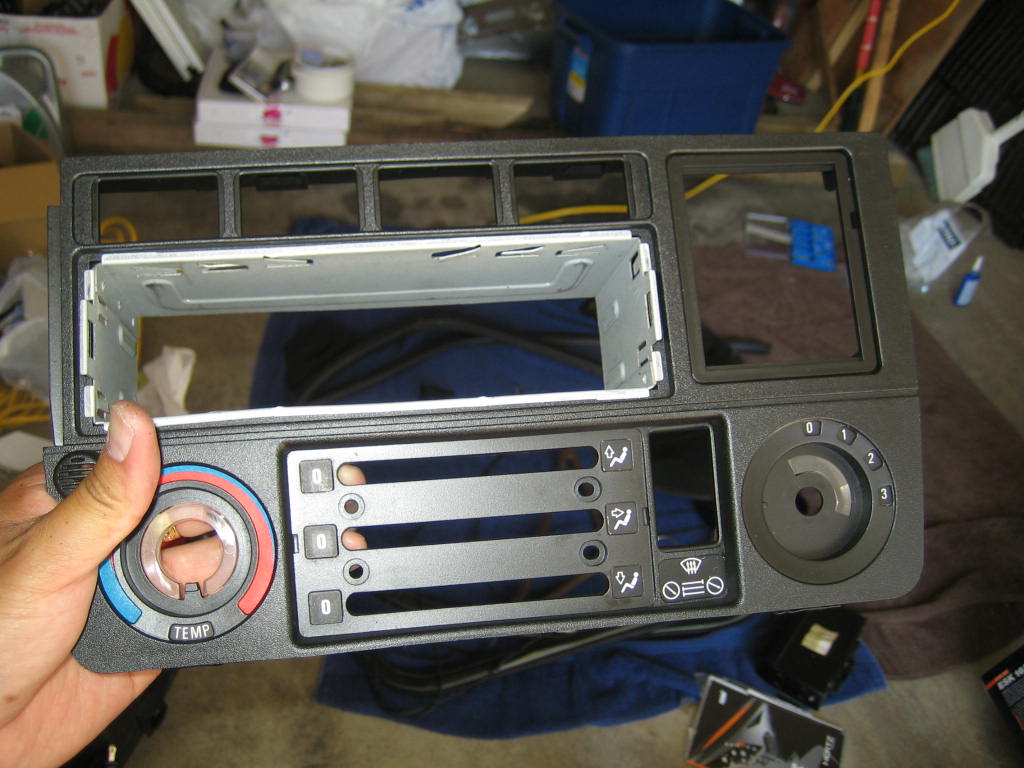

              So in the middle of the night I started removing the center console to take the HVAC panel out
              While the panel was out I decided to detail it
              Black spray paint is your friend for touching up the interior
              I love the random wires I would later decode

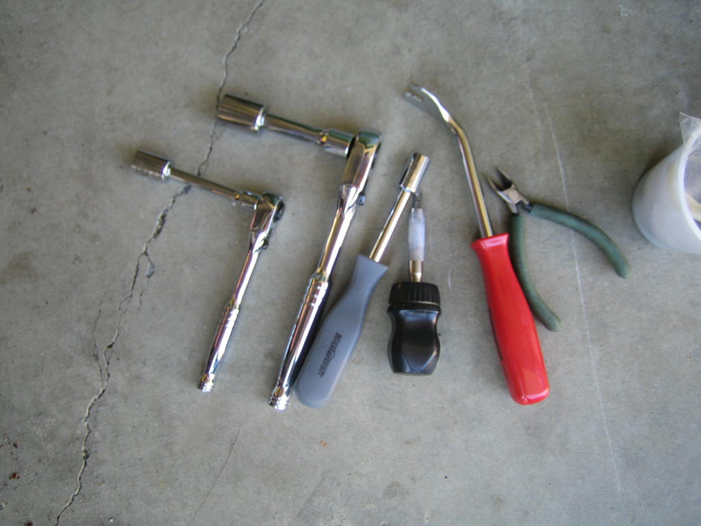

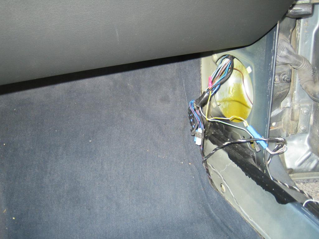

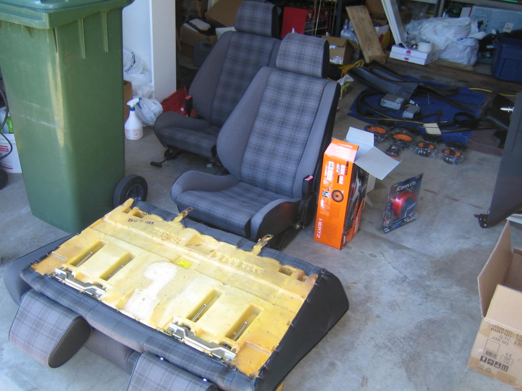

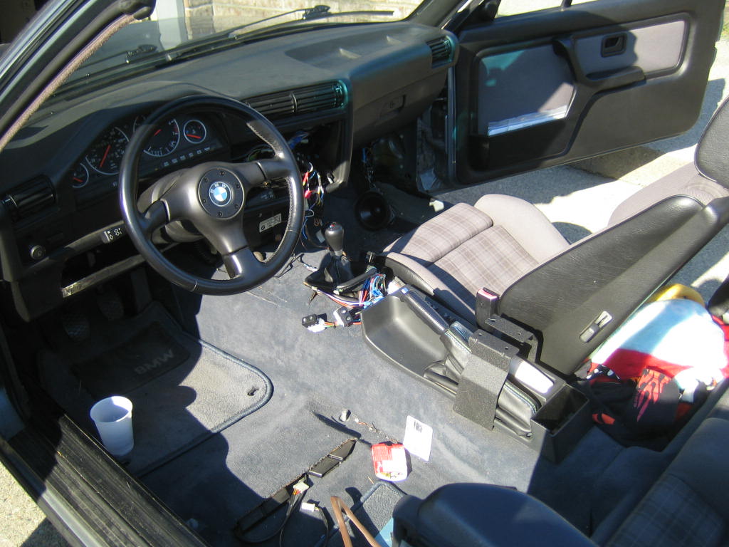

              The next day I start removing the interior and pull out the speakers, having the right tools to remove trim pieces makes things a lot easier

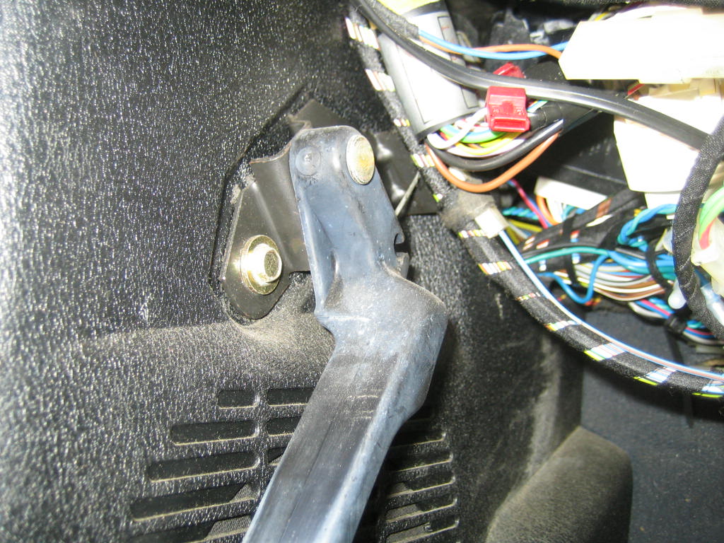

              Hood release gets in in the way on the driver side
              Passenger side

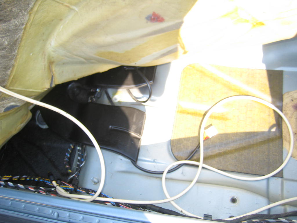

              Rears

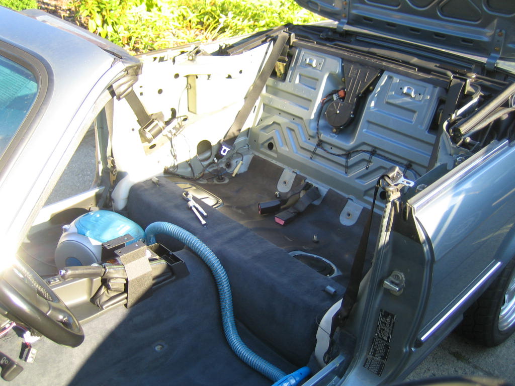

              Might as well clean things up before making a mess

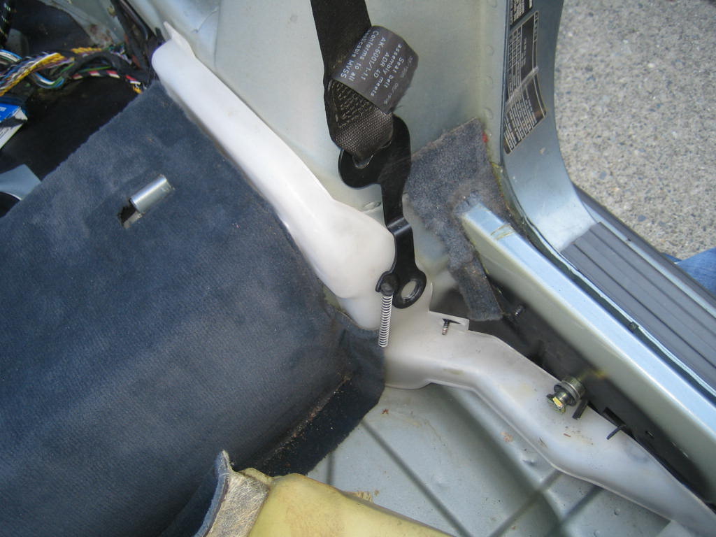

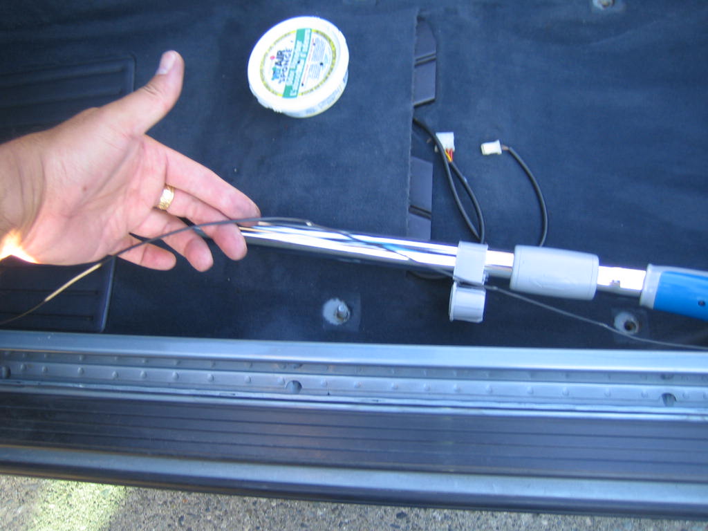

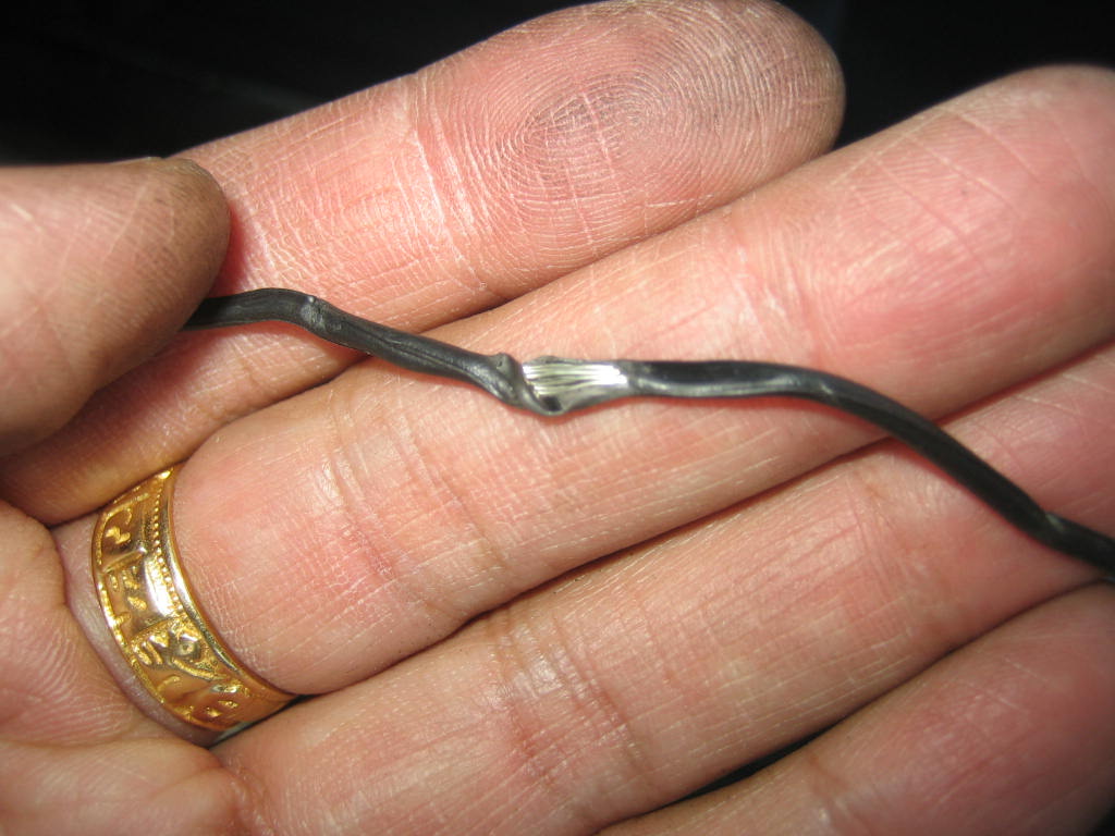

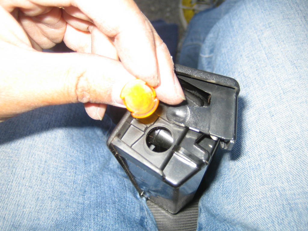

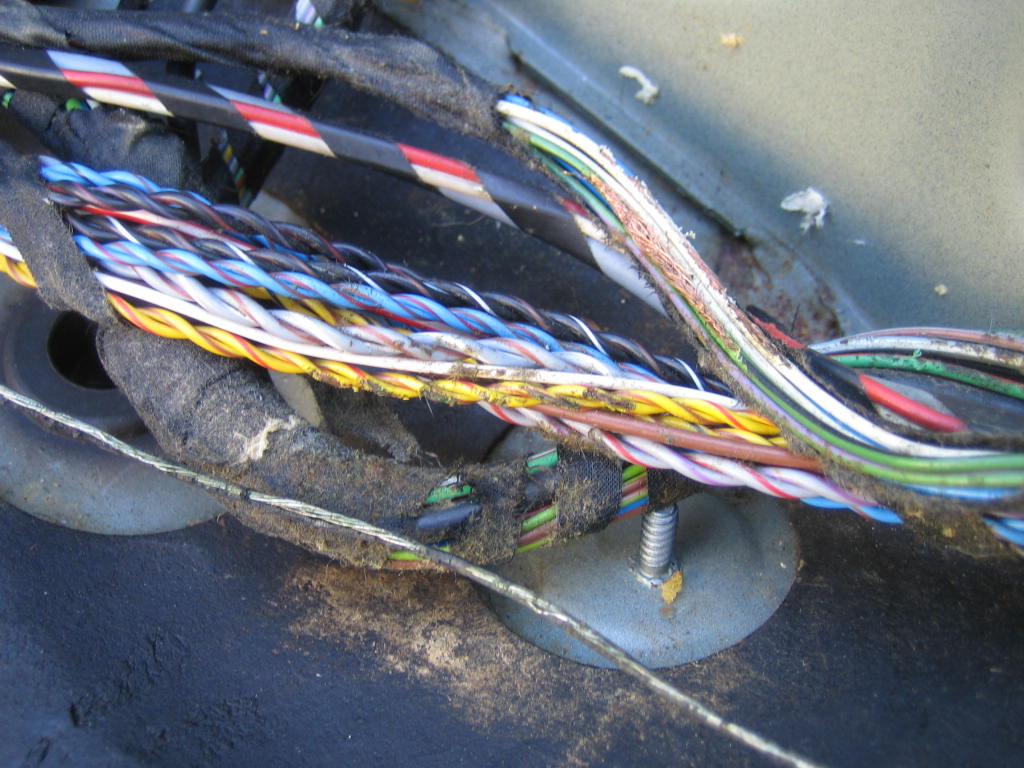

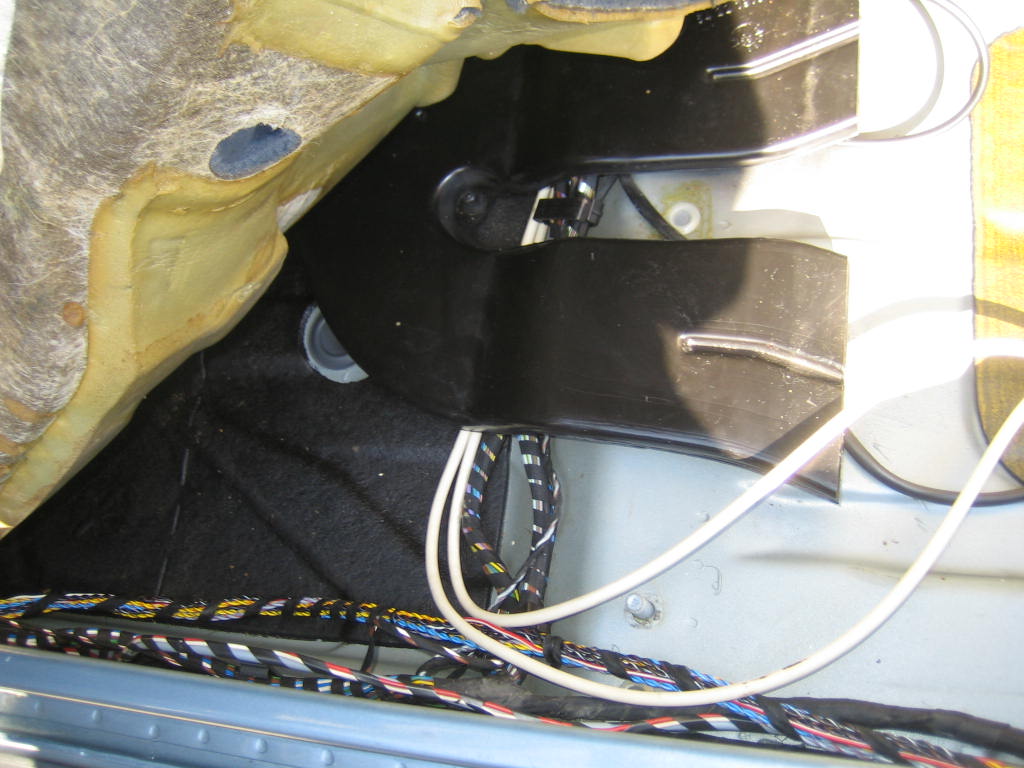

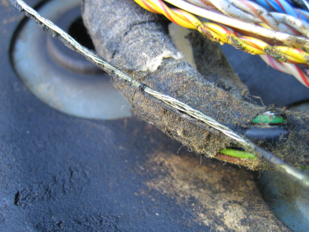

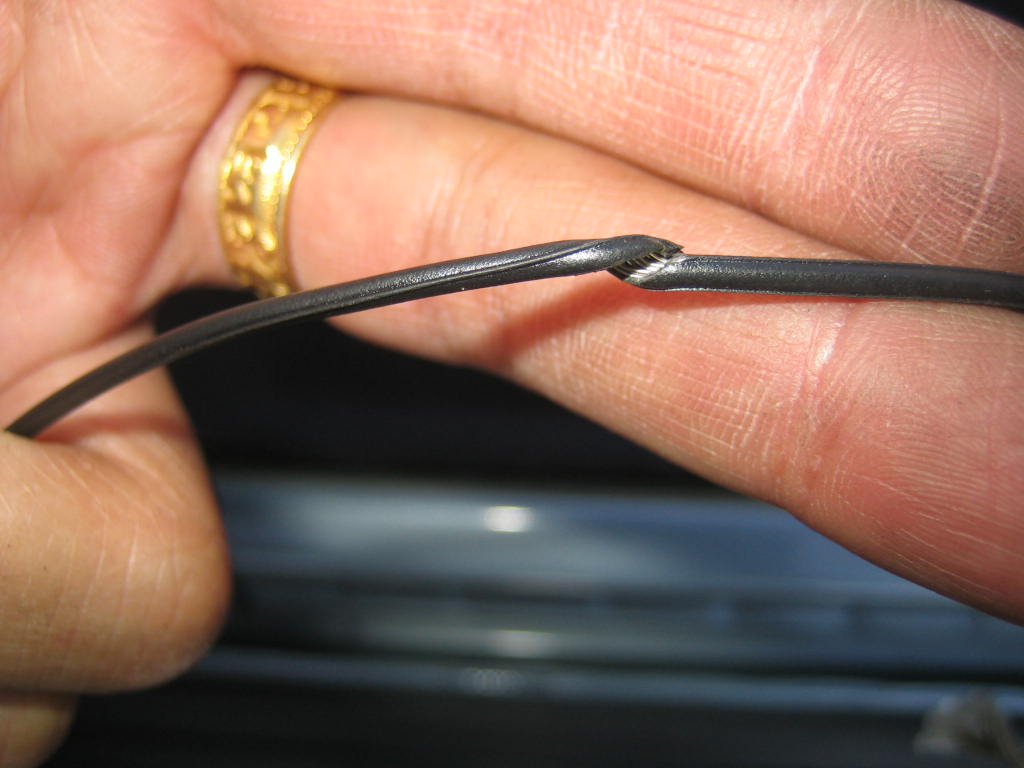

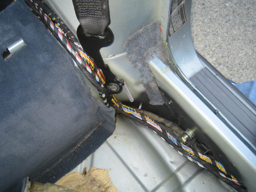

              When I removed the door sill trim pieces I found this long black wire
              I traced it and it was connecting the trunk switch pin to the alarm. As you can see in these pictures the insulation got pinched open and the wire was grounding to the chassis and causing the false alarms I was getting for a very long time.

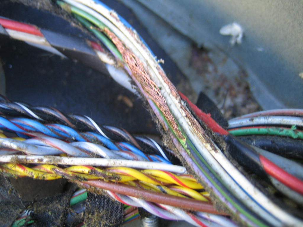

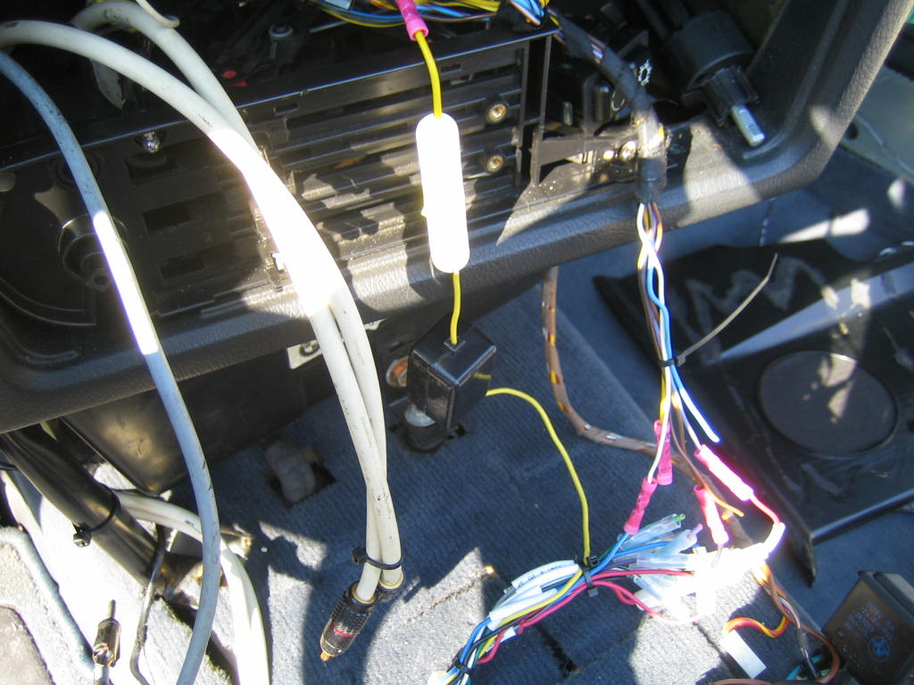

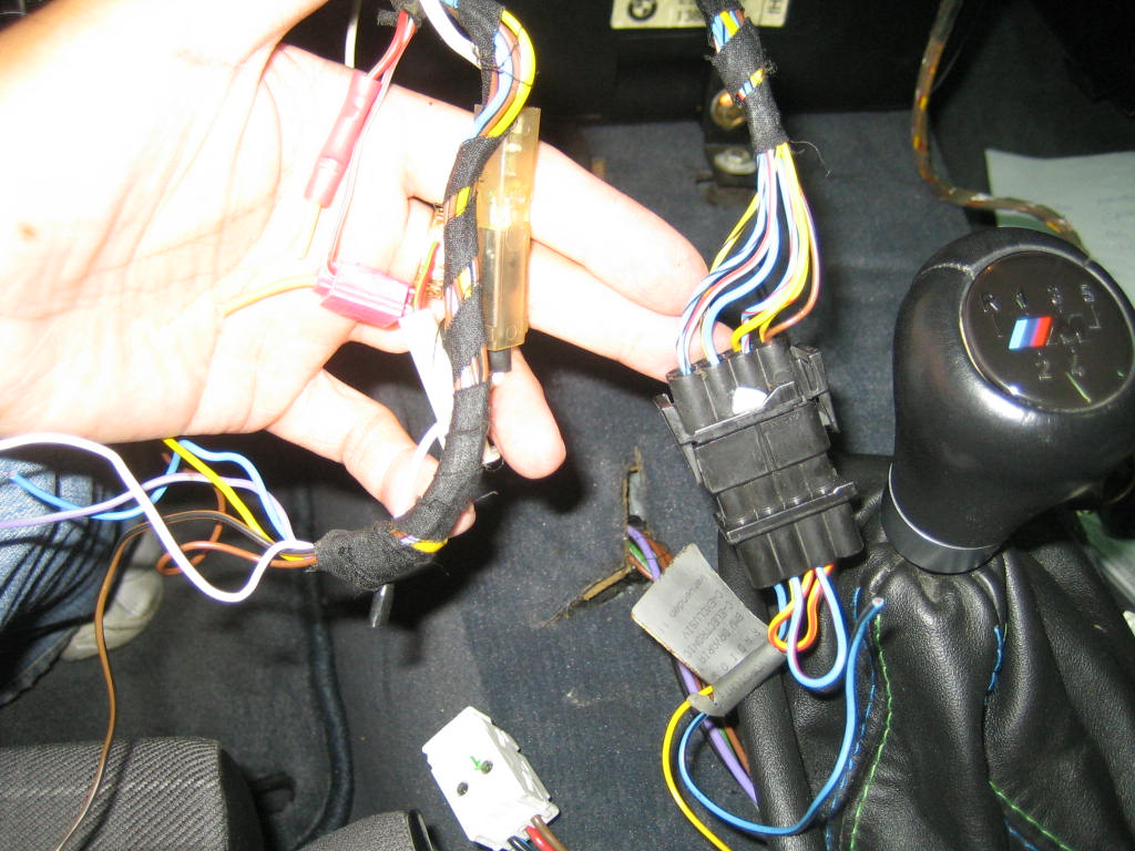

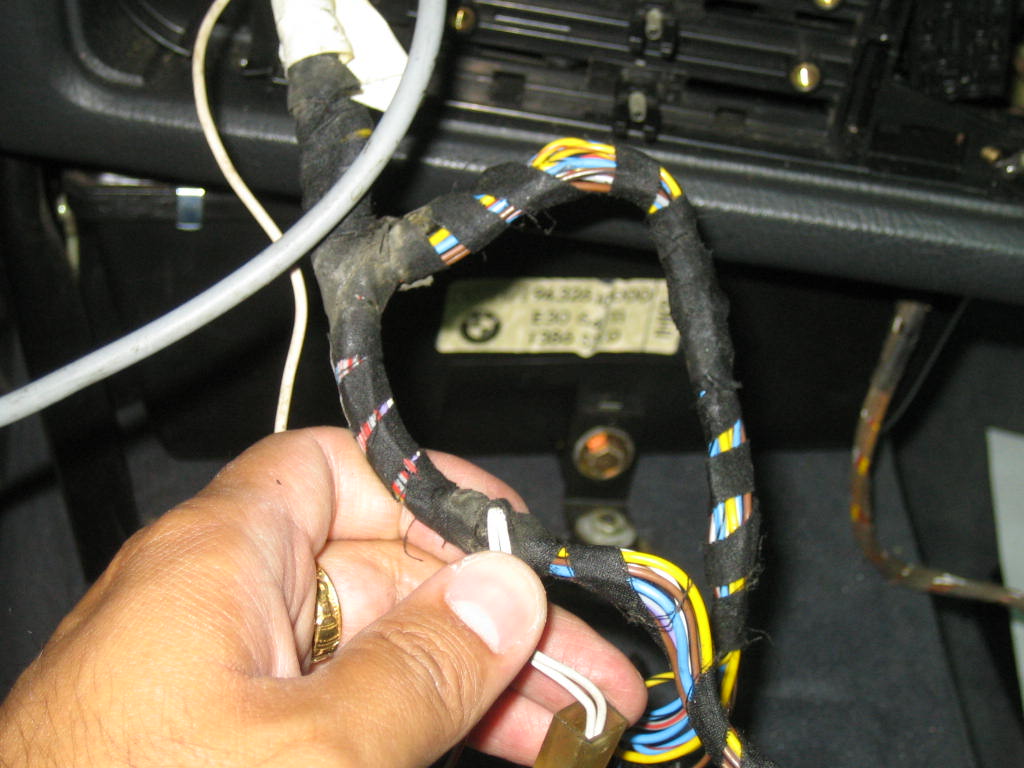

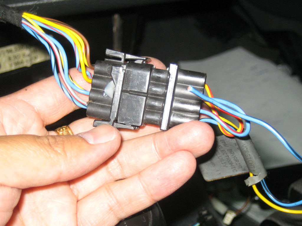

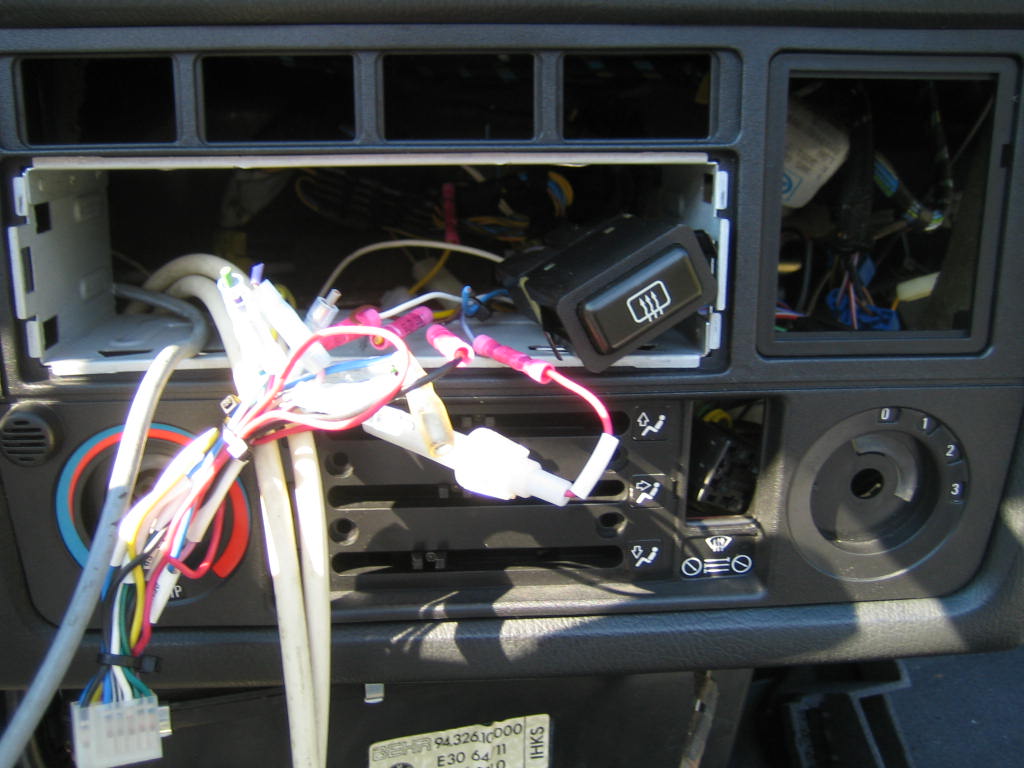

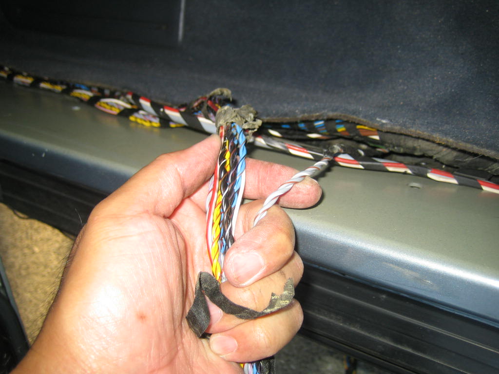

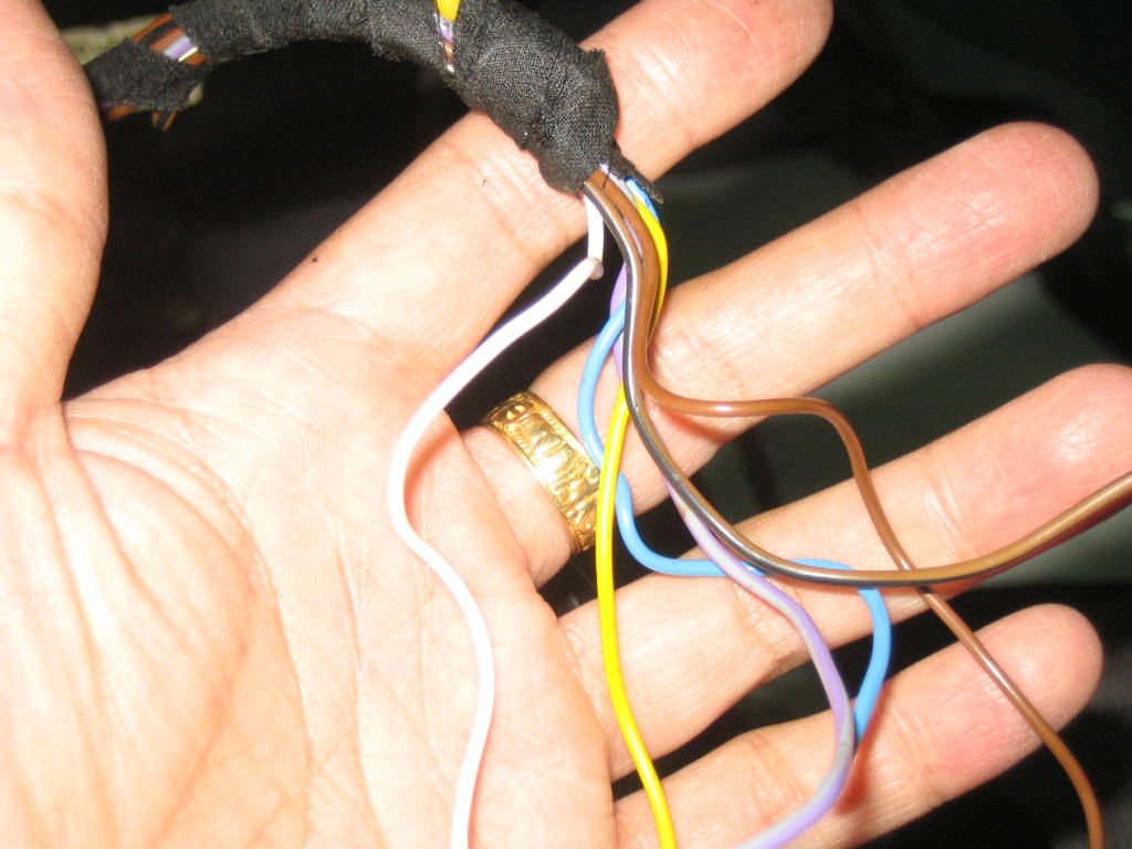

                Here is a bunch of wires that were exposed after rubbing against the metal post in the background, so had to do some quick patchwork.
                So this is where I wish I did some research, took a look at the electrical diagrams and mapped out what these wires were before I started pulling them out

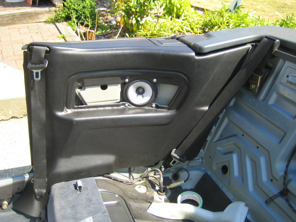

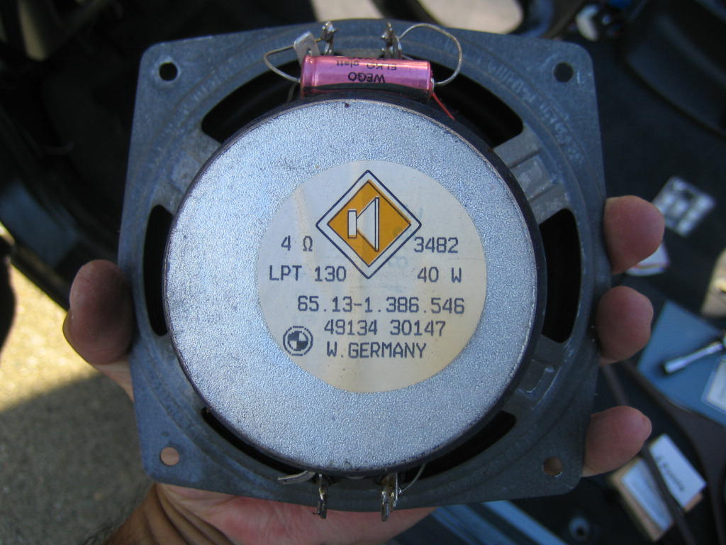

                Turns out they are the speaker wires that go to the stock speakers. I decided to reuse the wiring instead of running new speaker wire and found out afterwards it is much harder to put the wiring back into their snug locations than pulling them out.

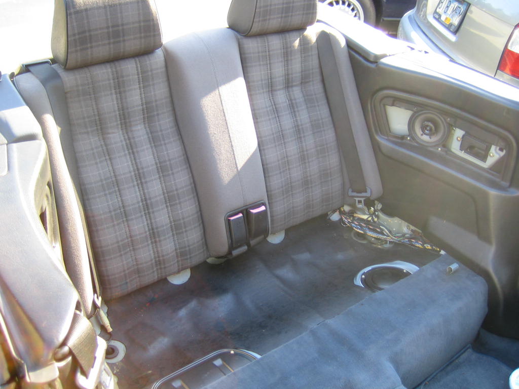

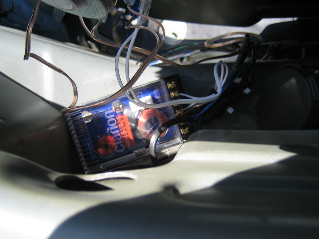

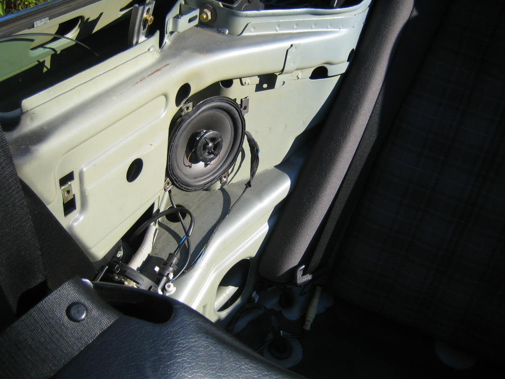

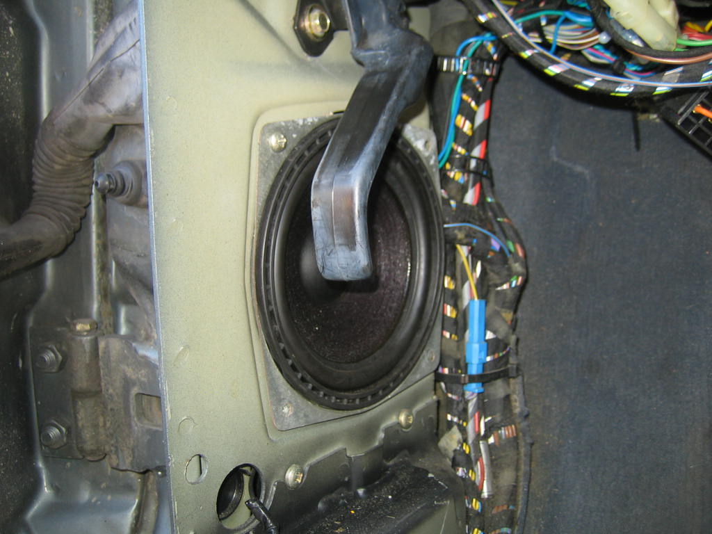

                Installed a set of Clarion coaxials in the rear.
                Beware that just because a speaker fits on the passenger side it MAY NOT fit on the driver side due to the top cover release handle being located there. The speaker was too deep and some metal needed to be cut from in order to clear the magnet.
                Crossover is hidden behind the factory trim panel

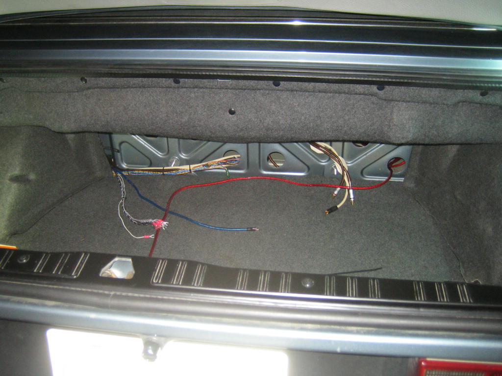

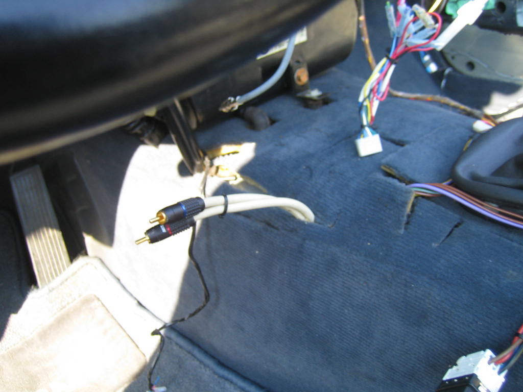

                Running the RCAs... pulled them out, laid them again... this is where being OCD sucks. I did this 5 times and ended up laying the RCAs just like I did in the first attempt.

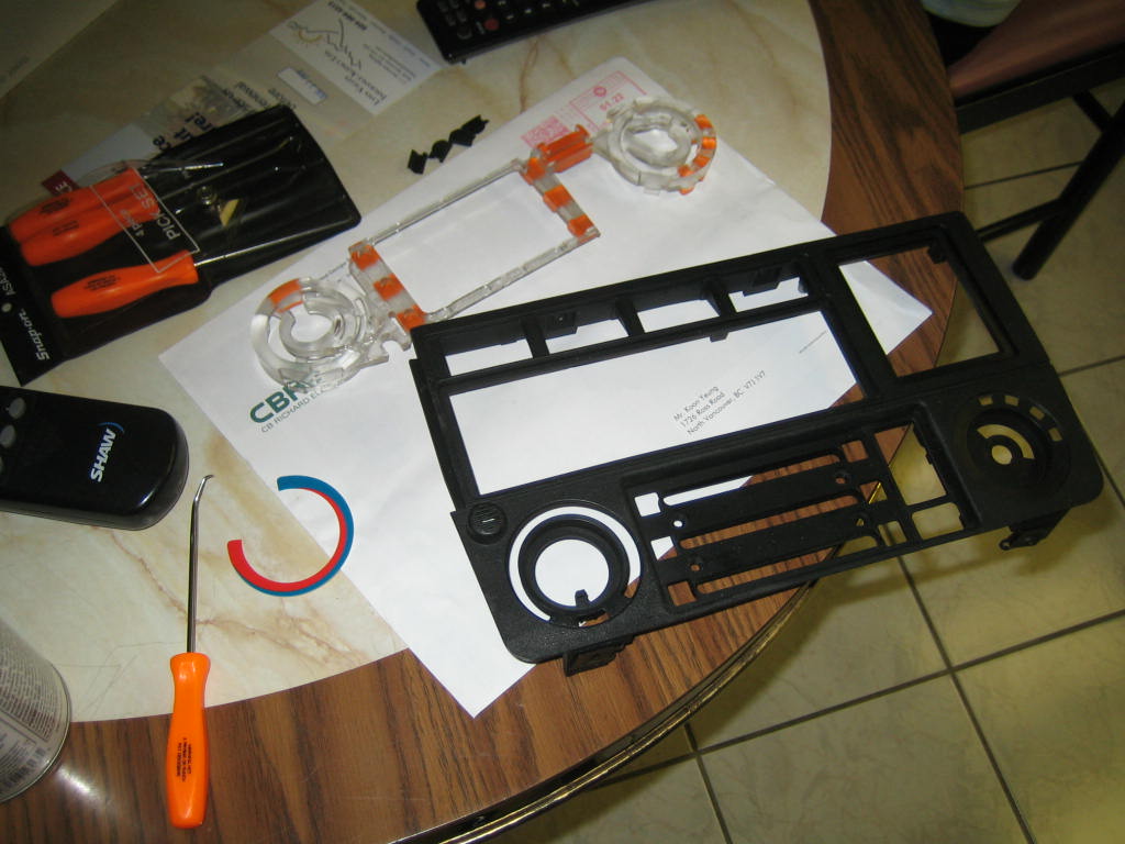

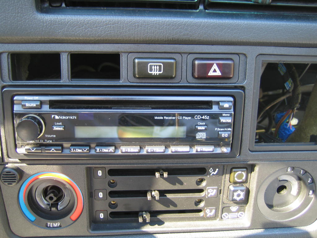

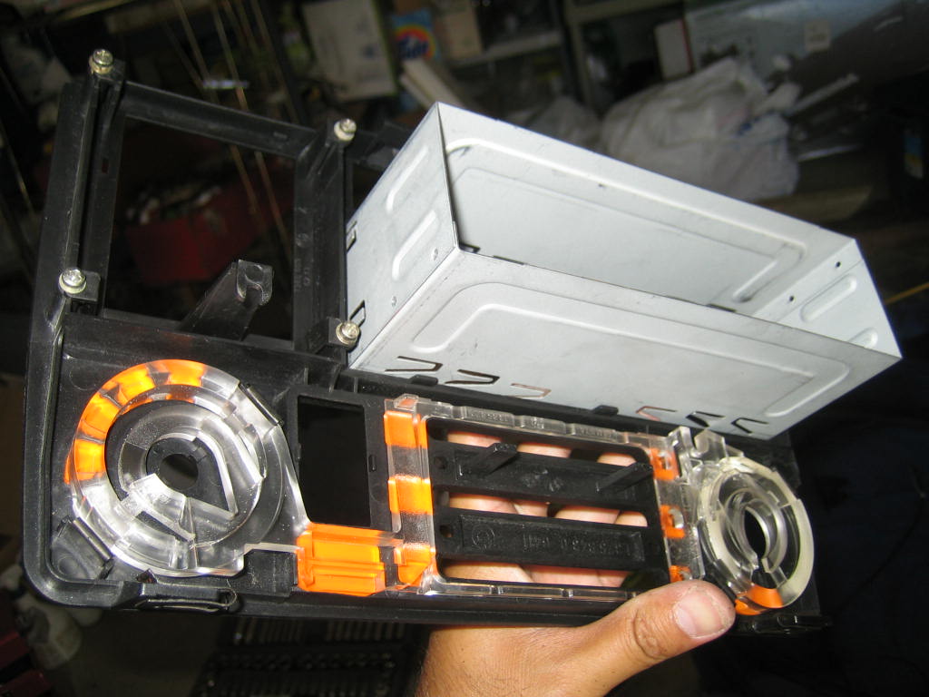

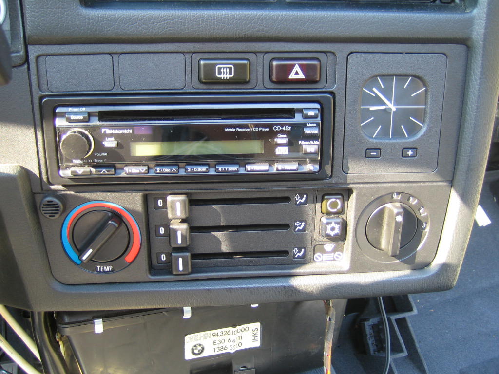

                Installing the cage for the Nakamichi CD-45z

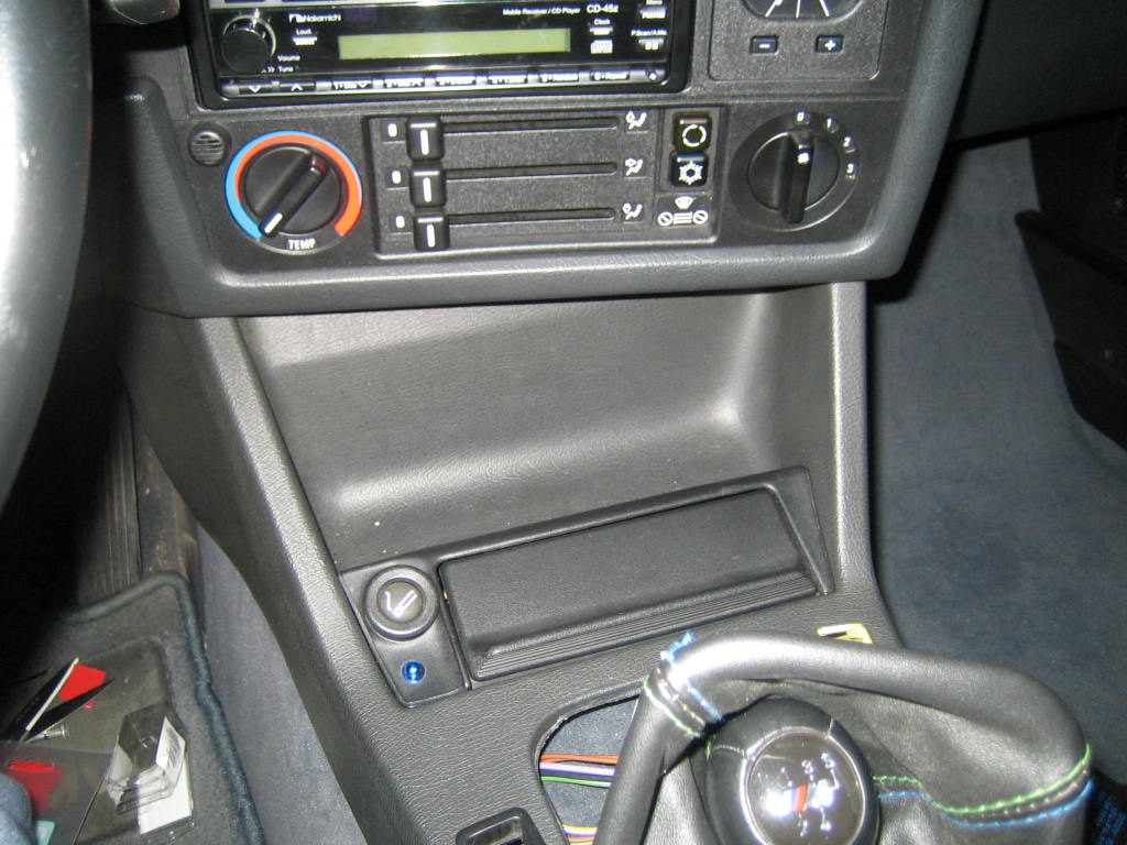

                HVAC panel back in
                Nakamichi deck, clock and freshly painted trim pieces installed

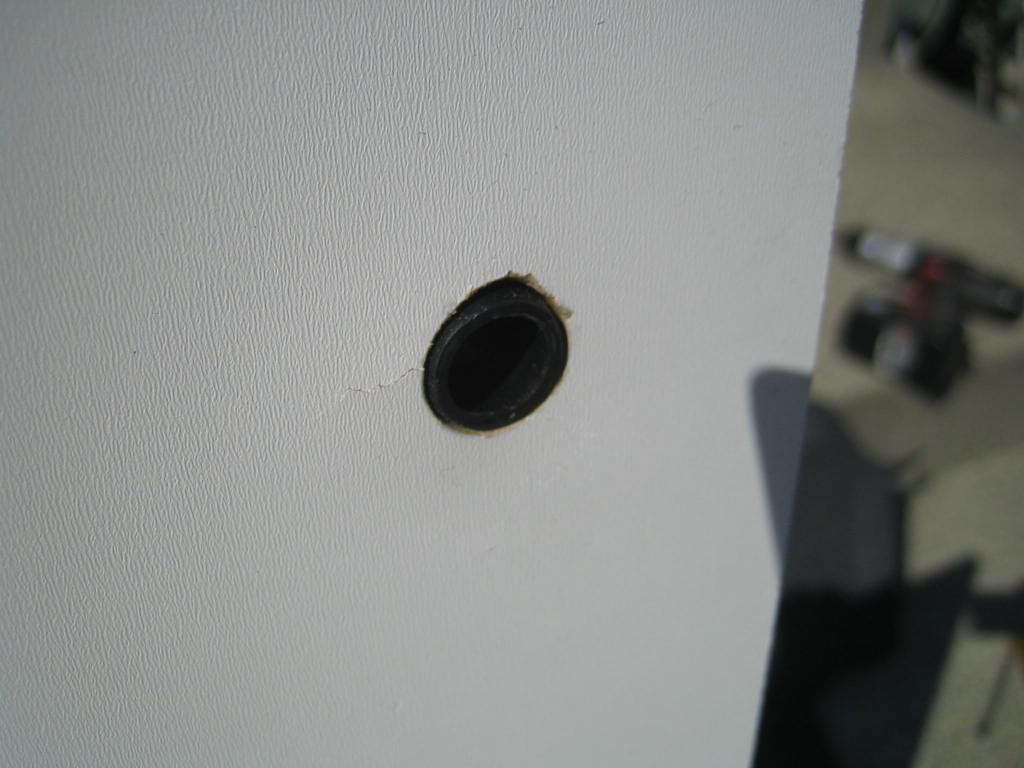

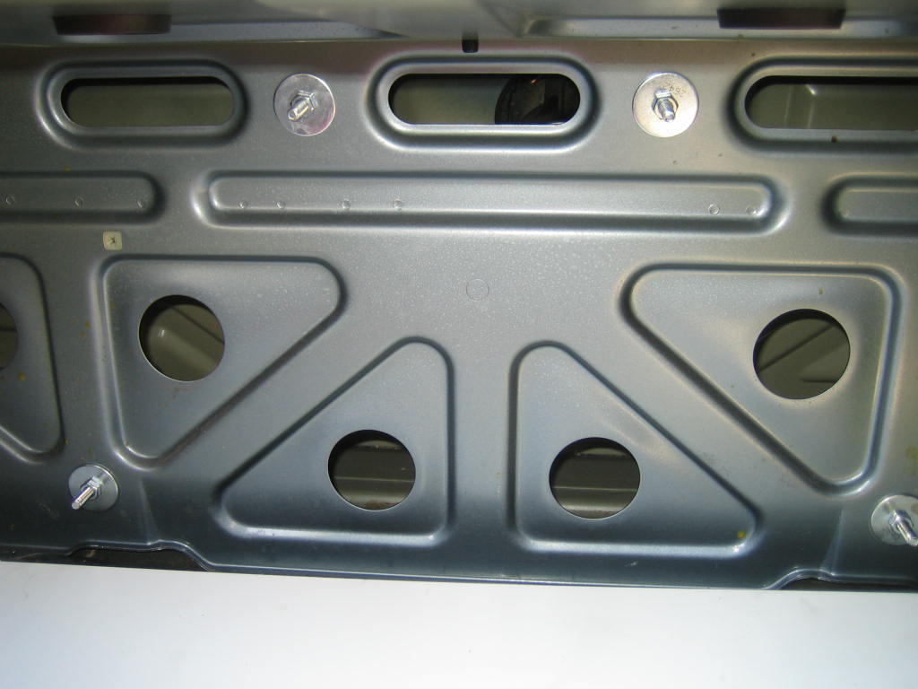

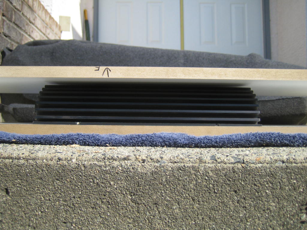

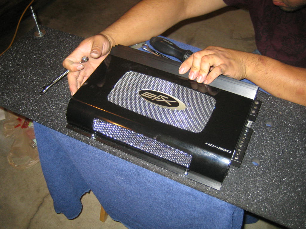

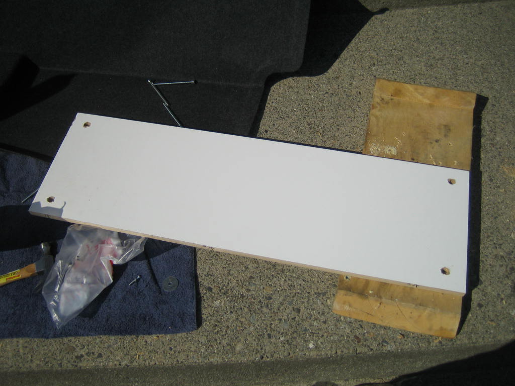

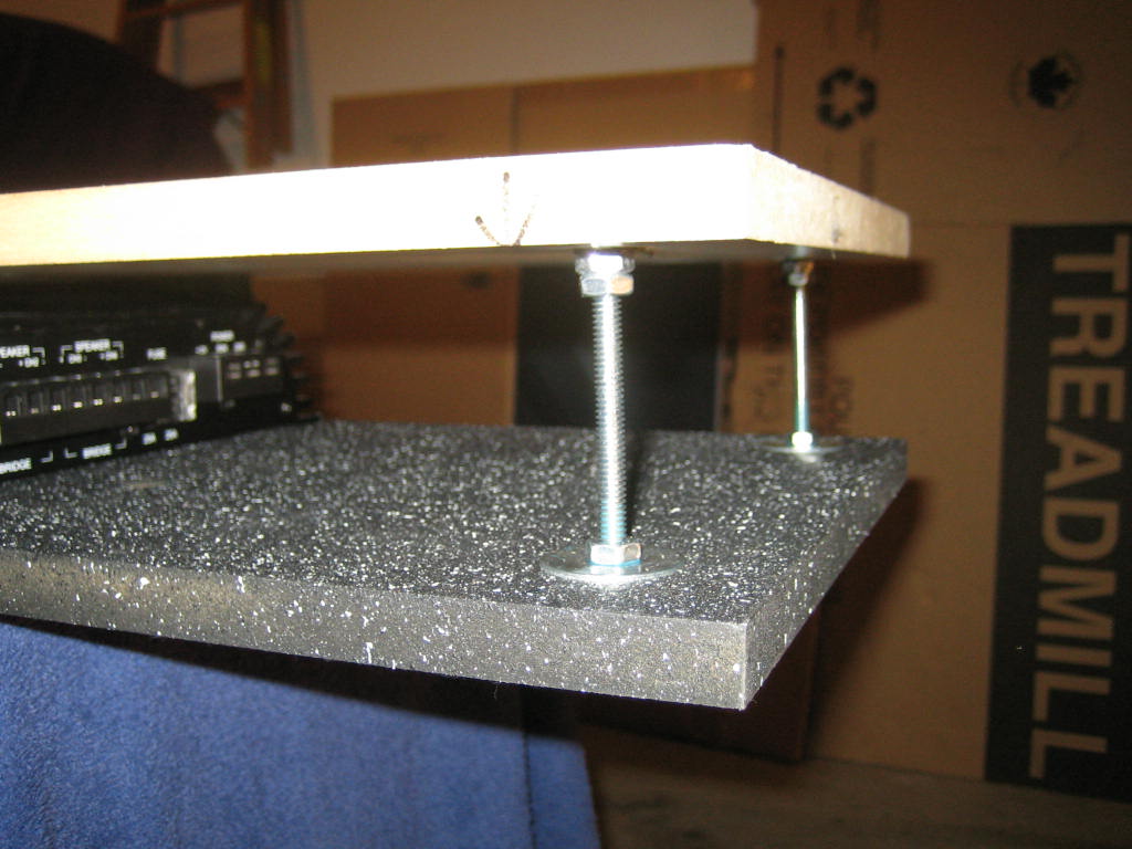

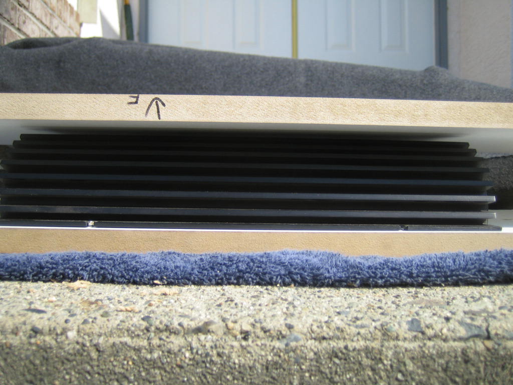

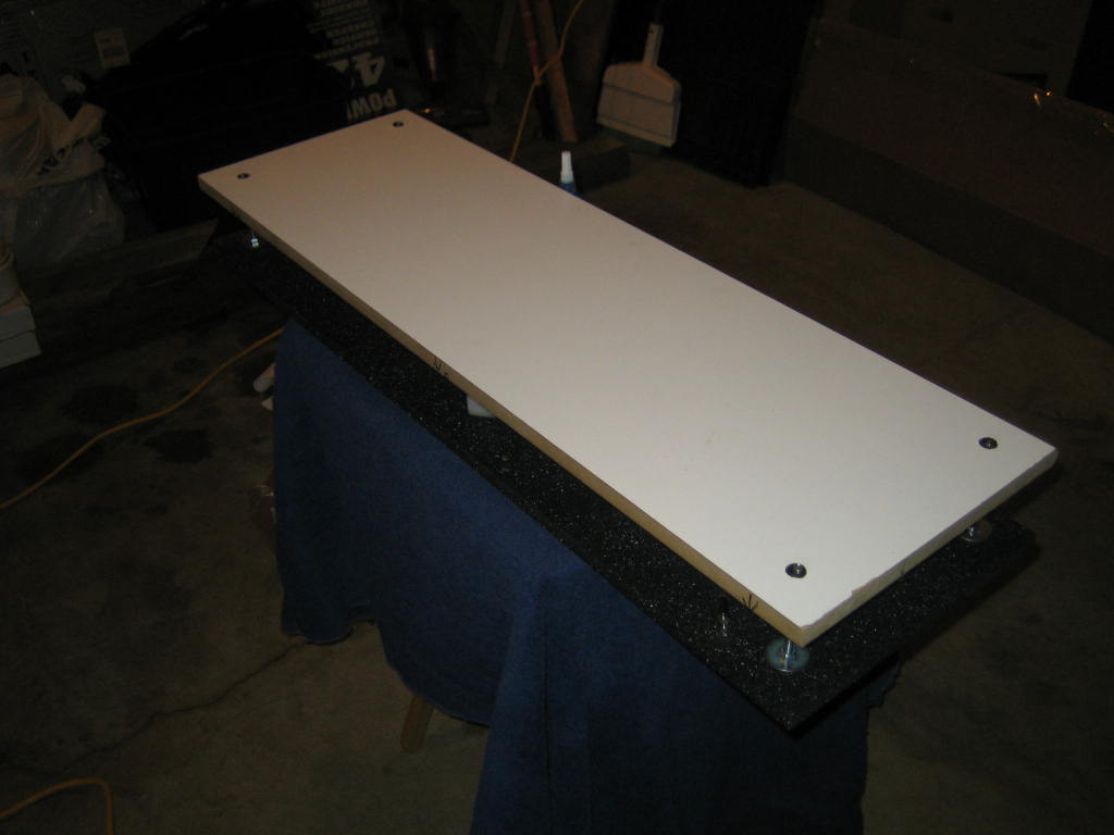

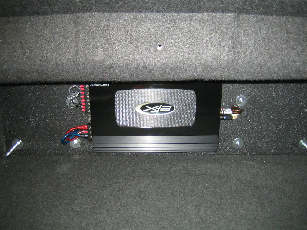

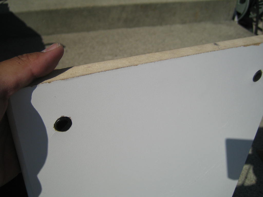

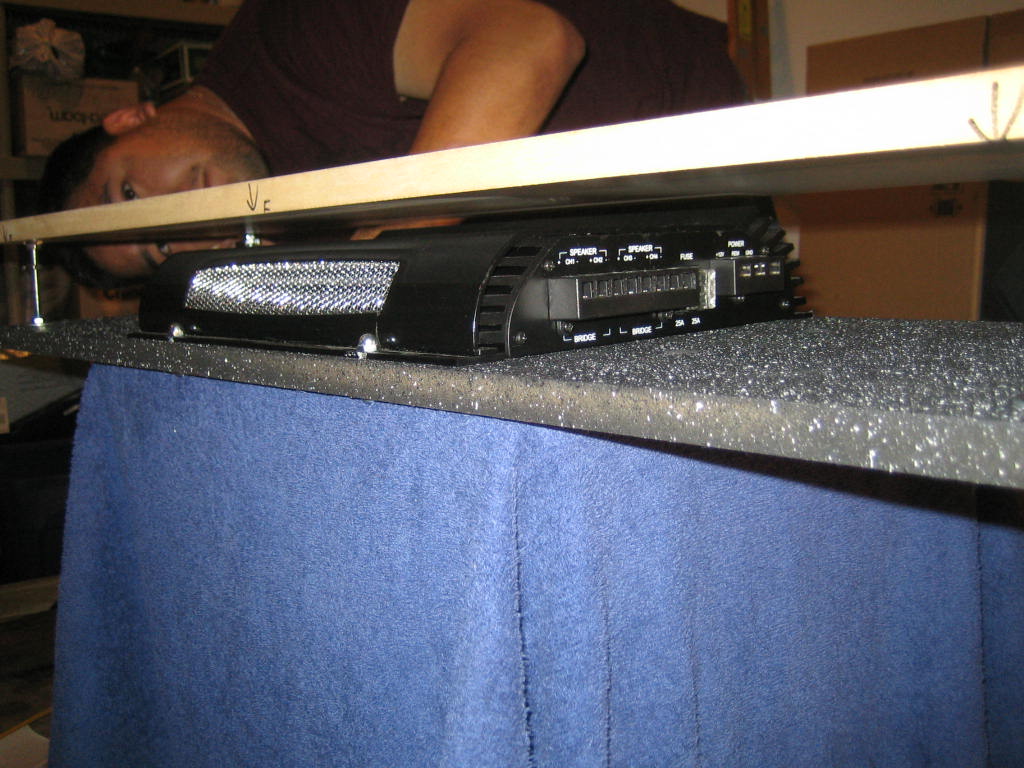

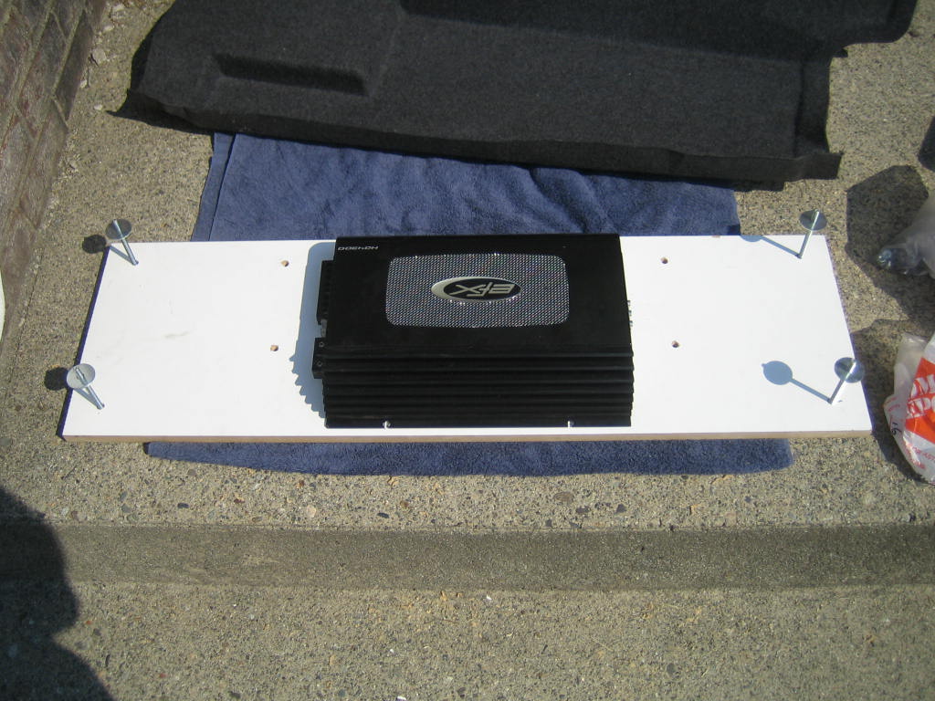

                I decided to build a simple rack to hold up the amp and used some stock locations on the metal for mounting
                The idea is to hide the amp between the rack and a removable front trim piece

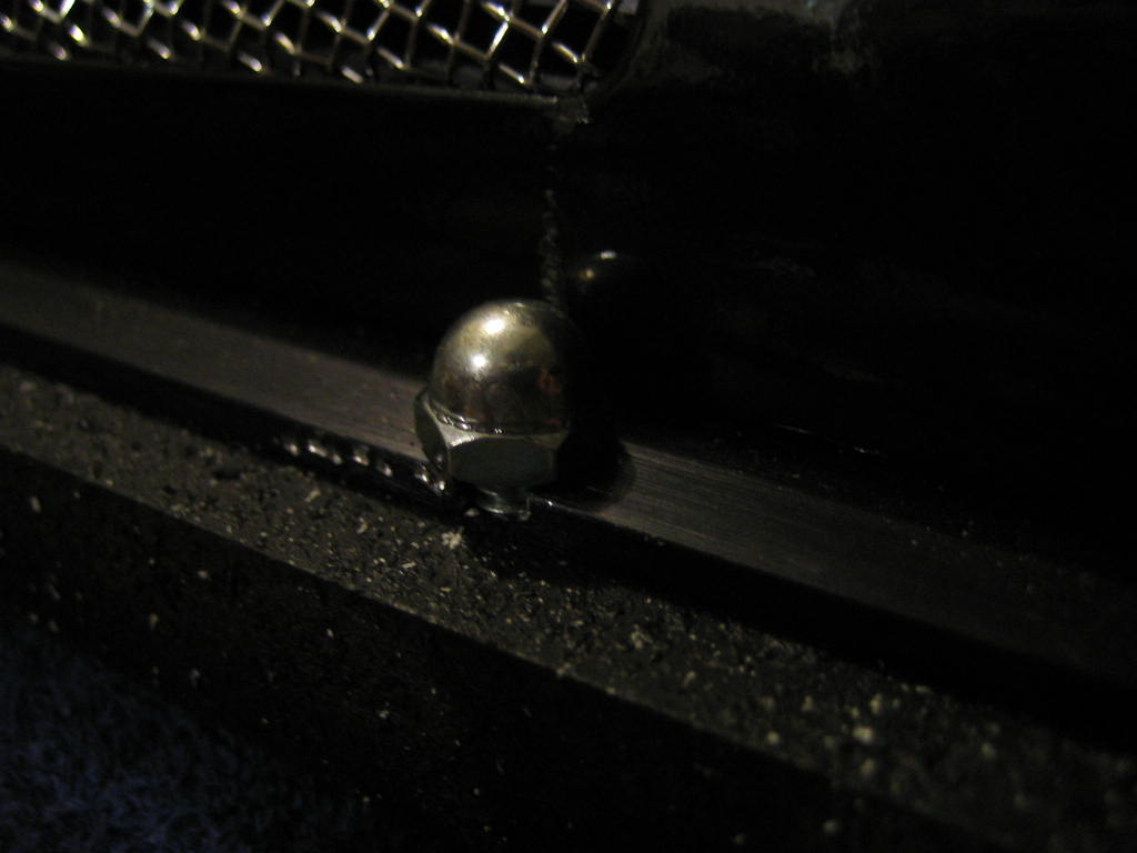

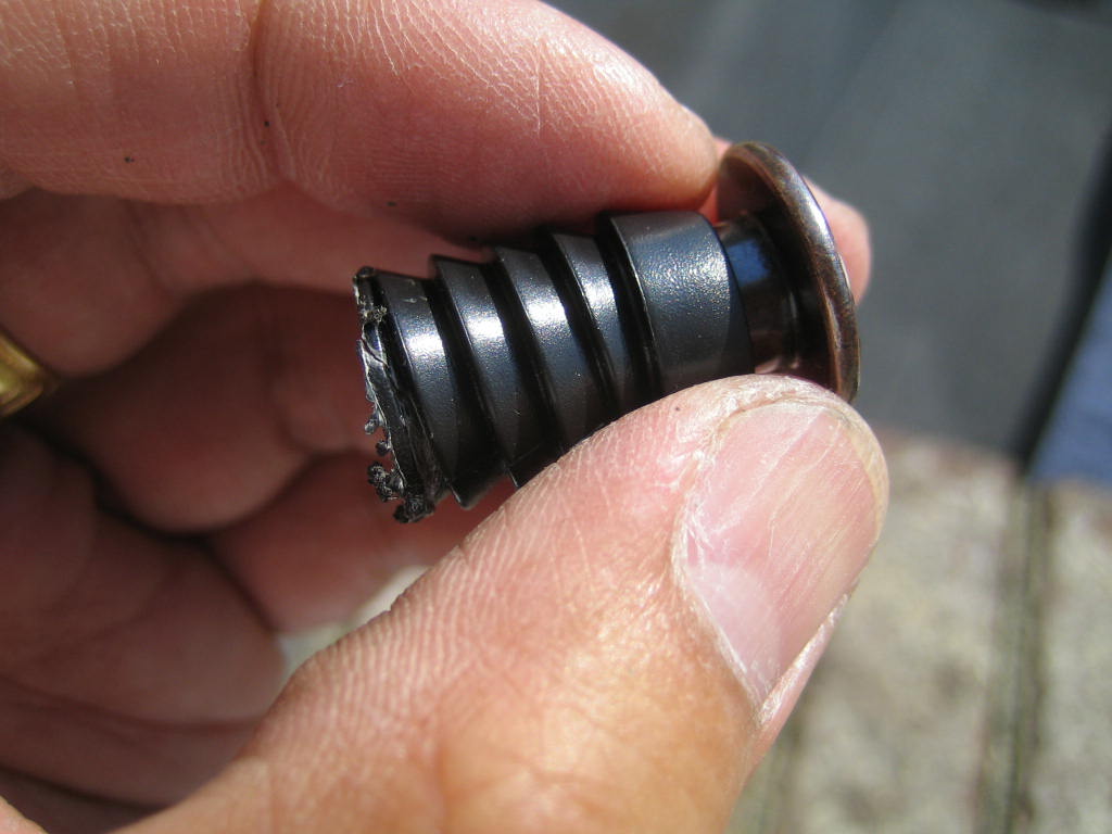

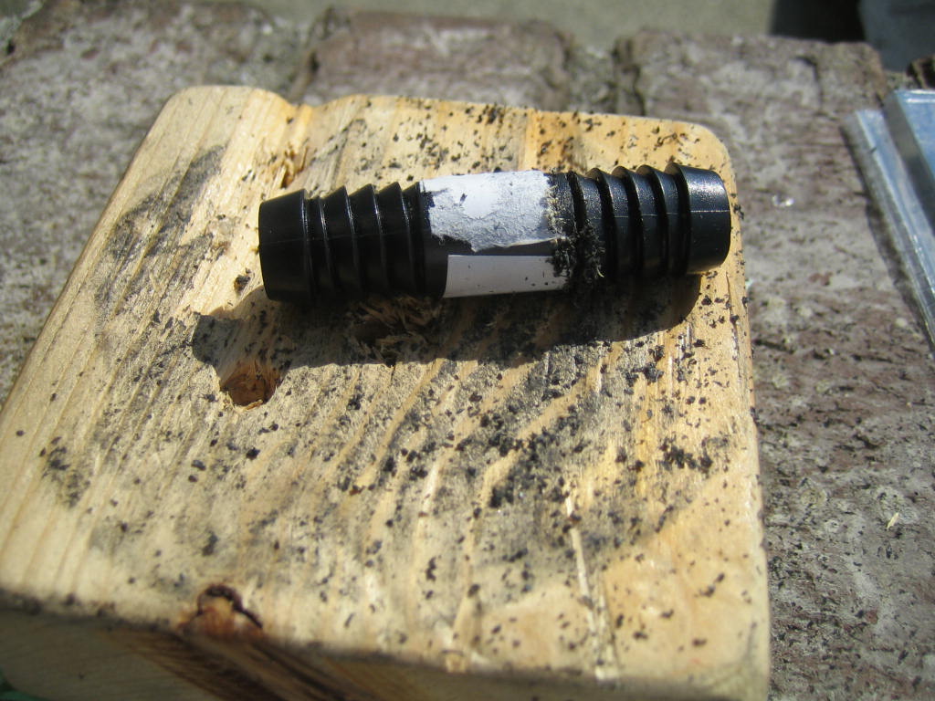

                These are the inserts I made to press into the top piece in order to isolate the MDF from the threaded metal bolts
                Test fit the top
                Bolted down the amp
                Setting the height of the cover
                Wires waiting to be connected
                Everything screwed down

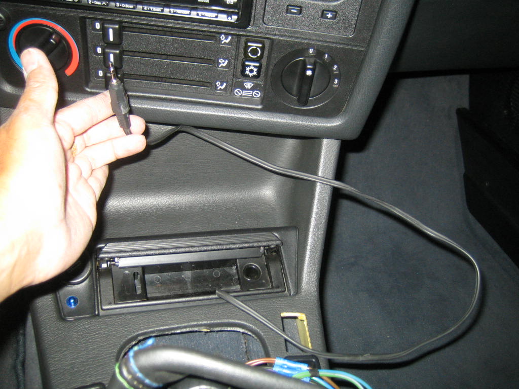

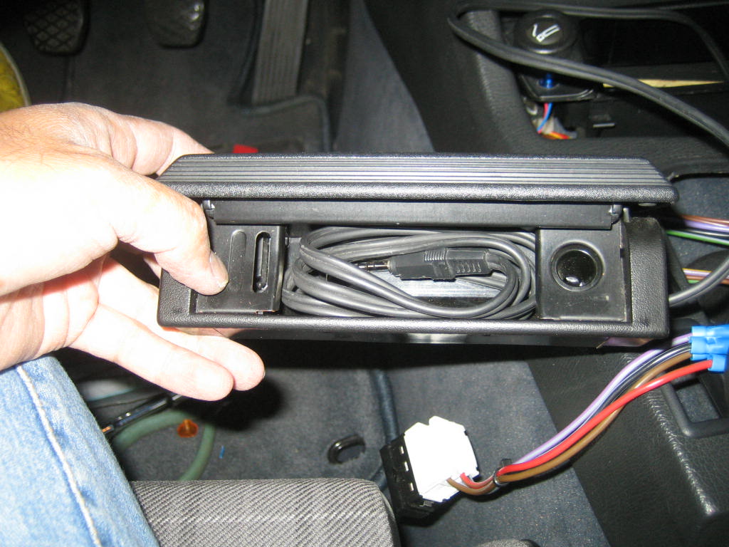

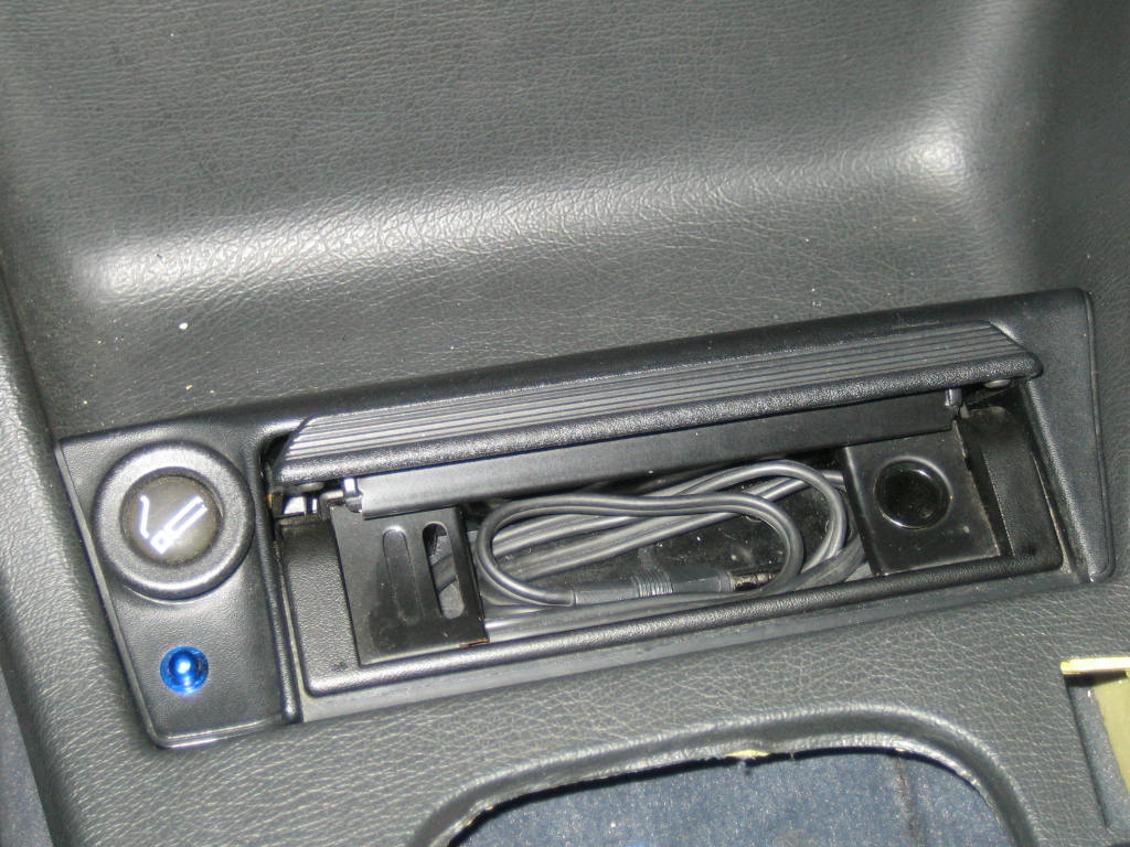

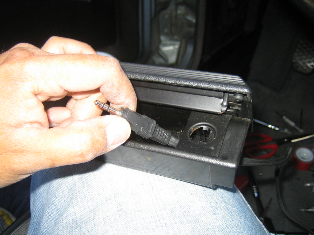

                The last thing I needed to do is wire up a mini RCA input jack so I can plug in an iPod. I decided to use the ashtray as it would double as a storage space for the cable when I am not using it
