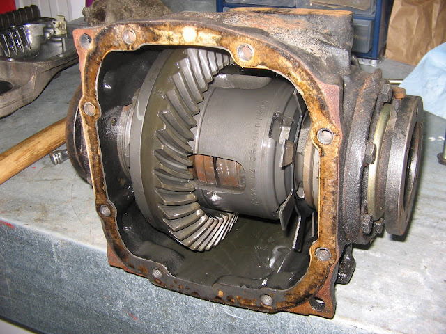

          I started to to work on the rear end. my diff from Diffsonline was hissing a bit, but the oil really needed to be change. Inspected it with prussian blue. Contact is good and backlash is also good.
          Good contact on power:
          Not perfect on compression. I wont touch anything since the inportant side is power side...
          that's it for now, Should work on it this week!

              Worked a bit tonight. Cleaned and reassembled the diff. still required an output flange seal and good diff oil: Motul comp FF.
