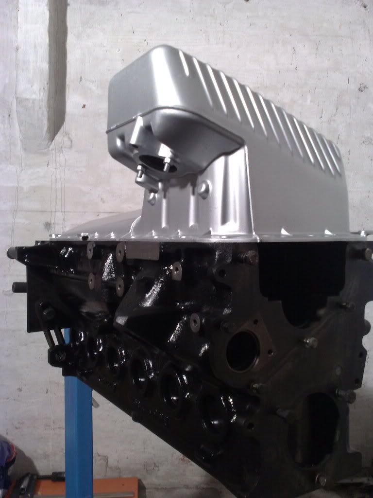

                I don´t use the car that much at the moment and during the coldest winter-months I will probably park it. I am building an engine which will be installed during spring/early summer. Am really looking forward to the final result and especially looking forward to finding out how "she´s" going to sound at WOT. Now for a few pics, this is what I started out with.
                And then the teardown started, didn´t take too long but very edu-mu-cational
                Quick photoshoot of the new crank on the block !
                Block still had honing marks and looked pretty healthy.
                Apply soap and water.
                Sanding, de-greasing and a splash of heat tolerant spray-paint does wonders.
                Then I turned to the head and started removing valves and getting everything cleaned. Took a couple of nights, I´m not stressed and try to enjoy and learn as much as possible in the process. Also....I like taking breaks and drinking beer :D but this is what I ended up with, pretty clean !
                When this was done I drove the block to a local company to get it bored and the top shaved. Am very pleased with the results and will be taking the head to the same company for porting and flowmatching.
                Then I momentarily ran out of cash.....killed time by cleaning all the parts I will be re-using. I sanded and painted most of the parts to make them look as nice as possible. This was a cheap little sub-project and very satisfying to see the results.
                There have of course been some complications but I see it as a part of the job....stroking means you have a larger crank which will always take up more space, this was a known "problem" and was relatively easy to solve.
                This is an NA project that will hopefully put a smile on my face, it will never be worth the money if we talk "Dineros per Horsepower" :)
                Jim and Mary at MetricMechanic supplied internals along with other smaller bits and pieces, go-fast stuff
                The engine will of course end up in my Touring, my family-wagon.....the car the Griswalds would have driven had they been germans :D

                    Loving it!! What kind of crank are you using and whats the bore? Are you building the 2.8 liter stroker that MM offers?

                        Am building an engine similar to the 3000 Hi-Flo Rally Engine, the work done on the head isn´t the same but hoping for similar results since I will be doing StandAlone instead of chipping. Plus some other minor things that will free more horses.
                        The crank comes from an M52B28TÜ and is in good shape, the bore is 86mm with MM 3200 Rally pistons with a 10,5:1 compression ratio.
                        During break-in period I will be using chip, VEMS install and dyno-tuning will be done after break-in.
                        I am a student so things go slower than I´d like them to :) but summer of 2010 is the current plan, hoping that will stick
