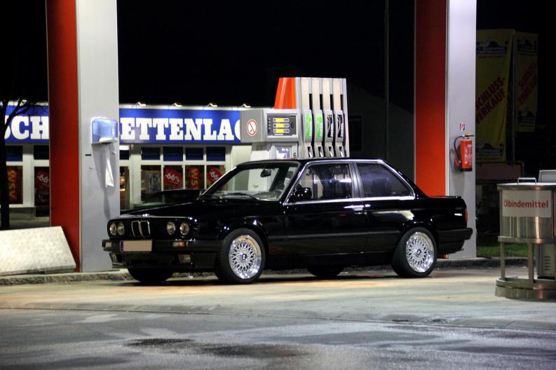

    E30 Touring - third heart transplant
    This is my new daily,
    a 1993 BMW 316i Design Edition Touring, Roadtripped it back home from Dresden (im from South Bavaria)
    Bought it from the second owner, who replaced parts like:
    • swap to M3 Steering Rack,
    • new Suspension
    • new Brakes
    • new control arms
    • new seats
    • engineswap M40B18
    and many more.
    Changes i did to the car:
    • M Tech 1 Steering wheel
    • Becker Navigation System
    • fixed the central locking unit
    • removed rust and conserved the body
    • repainted the whole body
    • 7.5x16" & 9x16" wheels from a mini
    After that i changed back to the original suspension in the rear, got it registered and inspected. Drove it for two months, did a Roadtrip to Zell am See and Saalfelden twice. When returning from my last trip the engine self destructed. The intake valve of cylinder 1 fell out the cylinderhead and it's remains ruined all cylinders & pistons. After that i bought a used M42B18 from a E36 318ti from 1995. The swap was a simple plug&play (except for the EWS2)

                      Yes, originally i had the 15" BBS Kreuzspeichen(as seen in my first post) which i sold for cheap to another E30 owner who had to get his car inspected and needed them for his historical vehicle license. Currently i could get a set of Borbet A's in 7,5x16" which need new paint... I will probably buy them next week after work, they're only 80€
