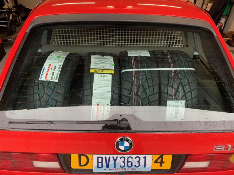

                The car was for sale for a little while to fund a safer rig since we are expecting our first child. After much reflection and conversing with the wife, we decided to keep the touring! I think the plan now is to just buy a newer, cheaper daily driver just in case I don't have the X5D that day.

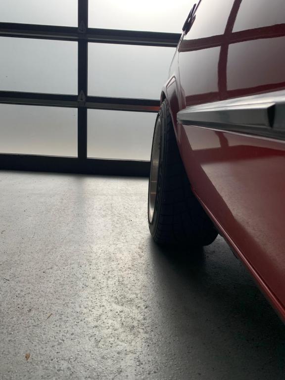

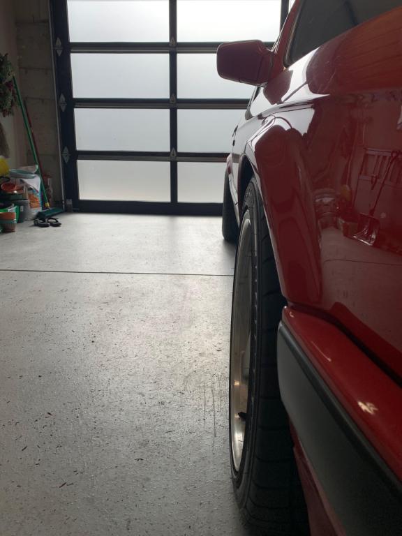

                Since then, I've proceeded to get new tires all around for the Avez's
                Toyo Proxws R1R
                205/45/r16 for the 16x7.5 fronts
                225/45/r16 for the 16x9 rears
                I love this shot photo. Tourings are so damn awesome
                Click image for larger version  Name:	IMG_6094 (1).JPG Views:	0 Size:	74.7 KB ID:	9976640
                Click image for larger version  Name:	1.jpg Views:	0 Size:	85.6 KB ID:	9976637
                Click image for larger version  Name:	2.jpg Views:	0 Size:	51.4 KB ID:	9976638
                I wanted to run 245/45's, but they don't make that size in the Toyo R1R. Overall very happy with how the fitment turned out.

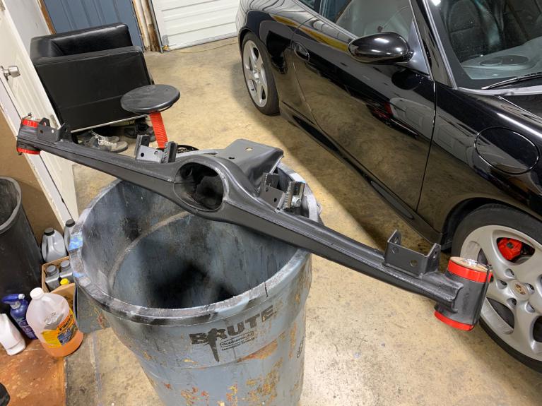

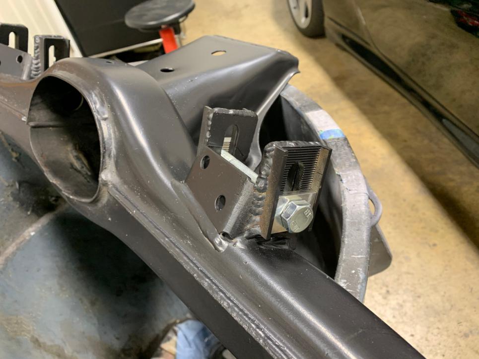

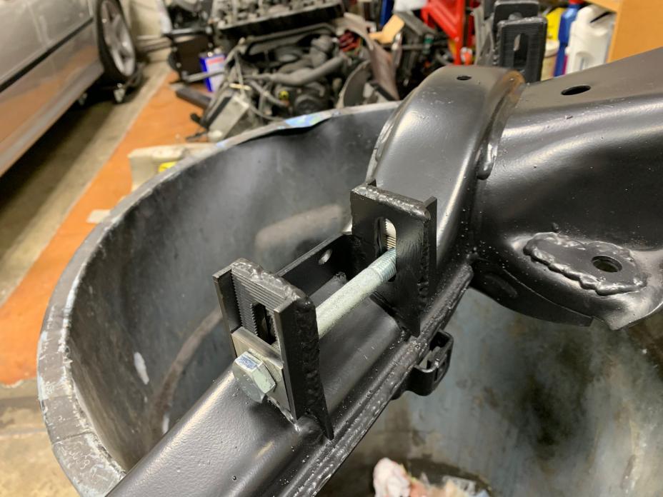

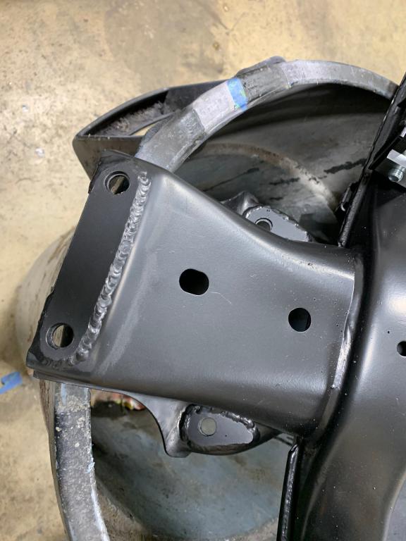

                        Rear End Update!
                        I've been sitting on my rear subframe refresh for a bit, but I am finally getting some traction on this.
                        I sent the subframe off to a buddy of mine adam.nonis to get the camber adjustments welded in. While he was at it, he generously sprayed it with "STEEL-IT". First time hearing about it, but it sounds like some really cool stuff.
                        The new style Camber adjustments from garagistic seem to be very well made. The new design implements serrated teeth on each mounting bracket to effectively lock in the desired angle.
                        I also opted to upgrade to 80a poly bushings for the subframe mounting points. I'll be doing Lemforder Rear Trailing arm bushings since I really don't want the added noise from the poly in the trailing arms. I think this will be a good compromise since this is strictly a street car.
                        Adam was also able to weld in reinforcements for the Differential mounting points. I'll be installing a Garagistic Differential Stud kit as well.
