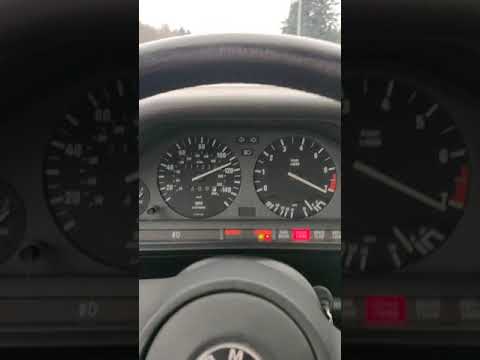

    Since few will agree with this, here's a quick 3rd gear rip! 3.25LSD out back with a G260
