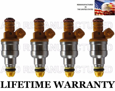

        Where did you get your injectors from? I've got the L Jeronic on my 1974 o2.
        dlm ny country
        • HENNAROT318i
          • Jul 2021
          • 28
          #34
          Got them on eBay
          https://www.ebay.com/itm/142043582098
