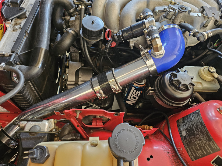

        Then dealing with the throttle body hose and iac. CATuned doesn't have a silicone boot for my 1990 in stock. So I went to siliconeintakes.com and bought:
        - 2.75 to 2.5 reducing 90 degree bend. Black is out of stock but I will be ordering it as soon as it's back.
        - Silicone port system to tap the elbow
        - and a 1/2in NPT to 3/4 in barbed 90 elbow to run to the iac.
        And then clamped it all down. 1" hose stretched over the iac fine and fit the 3/4 barb too.

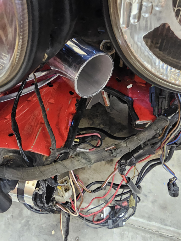

                          Spent some time cleaning up the cut I made on the driver's side for the intercooler pipe. There are some nice Dremel attachments that smoothed out the metal. I then split open a rubber tube and glued it around the edge. Not super pretty but better and I'll feel better about stuffing wires down there.

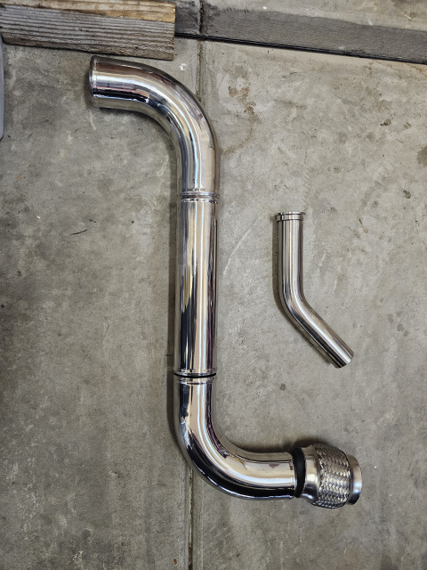

                            Just got these delivered. The welder never showed up so I still need a downpipe and one of my intake pipes welded. Scheduled a spot on Wednesday at the muffler shop for the 3" back to the muffler.

                                Exhaust shop wouldn't do the work without a downpipe. And they wouldn't do a downpipe for me. So I found a friend that could do it.
