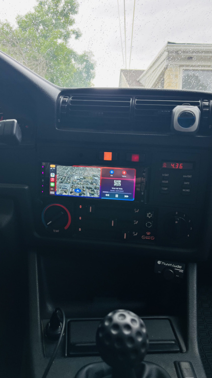

    Reinforced f/r subframes (adjustable rear), all new bushings, LCA's, lollipops, cooling system, oil cooler and mounts, adding a washer reservoir, single DIN CarPlay (not period correct but looks good and is nice to have), replacing both seats with Sparco GT's.

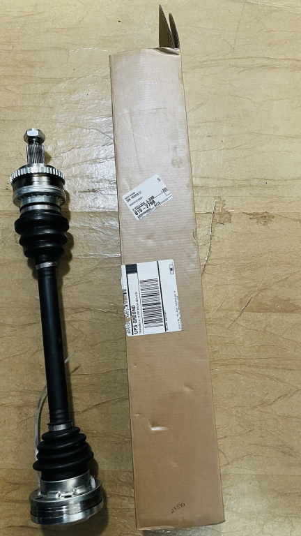

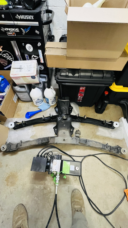

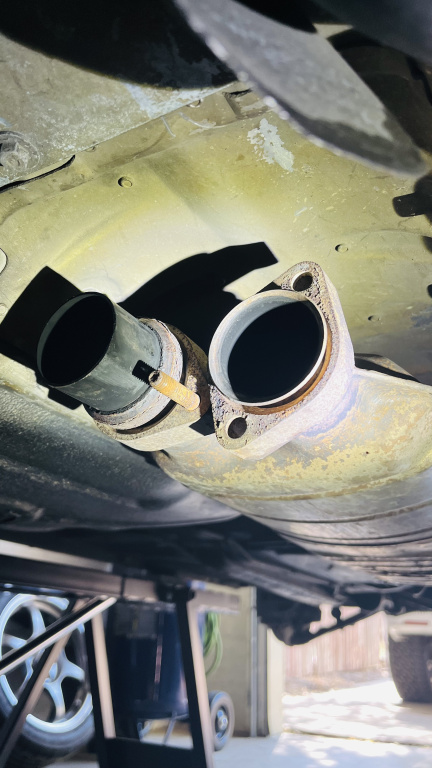

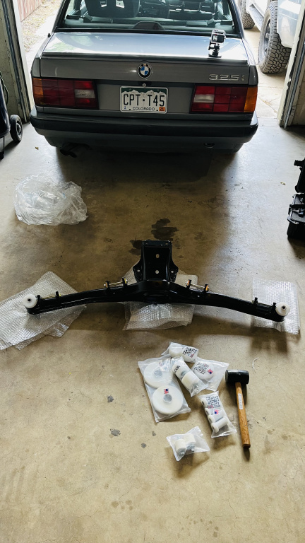

      Rear subframe, diff, and CV's are out. New subframe with new bushings and diff with new bushing and gasket, new CV's, sway bar bushings and links about to go in.

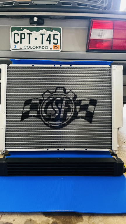

      Cooling system is pulled out and getting ready to do the timing belt (all associated with this), v belts, valve adjustment and valve cover gasket. New expansion tank and level sensor just got in a long with a washer fluid bottle/level sensor/pump.
      Will tackle the front subframe, motor/transmission mounts, LCA's control arm bushings, sway bar bushings and links, upper strut mounts this weekend. Its 100 degrees today 🔥

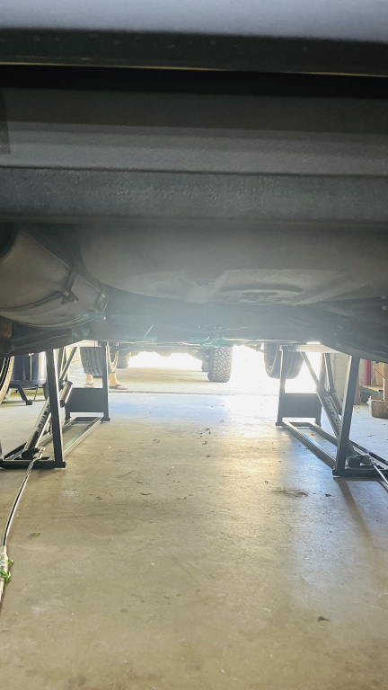

        Sometimes, it’s the little things 👌🏽
        • 2mAn
          Señior Mod
          • 21093
          That looks awesome and also sketchy

            Those cupholders are one of very few things people have designed/produced for e30s in the past few years that seems like a genuinely good idea/implementation.
            Love the quickjack as well

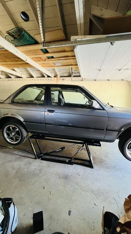

              Thanks! I really like the cupholder. Out of the way when not needed and there at the same time. My cousin has the door card ones from Pelican. Pretty nice as well but not hidden unless you take them out.
              The quick jack has been awesome. I do all the maintenance on my sister's vehicles and this makes it a breeze.

                  All bushings, hoses, seals, front/rear subframes, LCA's, sway bar links, all the belts, CarPlay, swapped/installed. New front lip spoiler clips/mounts (pain in the but to remove the old ones haha). Oil cooler, aluminum radiator, expansion tank. Even added a washer fluid bottle as it doesn't look like she had one for the last 10-ish years haha. Pulled the 4.10 LSD and swapped in a 3.73 LSD as she was screaming on the highway. Input/output shaft seals ordered, detent cap/seal ordered, shifter seal ordered as I can't exactly see where the transmission leak is so I'll replace them all and clean up the transmission when she's out. Replacing all the shifter bushings as well. Overall the car is really clean. Alex did a great job and has been a great help since I've taken ownership. Upgrading all lights to LEDs. I'll post more here an dIG (Flatwerx) as I'm going for a restodmod, my way. No track, no drifting, no autoX. She's being overbuilt for backroad, cross country trips.
