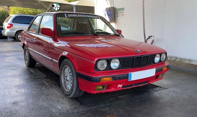

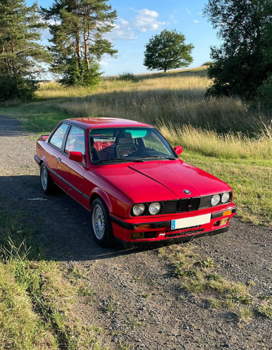

    So I decided to buy my current car: a BMW E30 318i coupe from 1989.
    Original Specifications:
    • Product date: 1989-04-27
    • Color: Zinnober Rot
    • S339 Shadow Line
    • S704 M Sports Suspension
    • S481 Sports Seat
    • S680 Radio antenna, manual
    • S510 Headlight aim control
    • S520 Fog lights
    • S219 Leather-covered sport st. wheel 380 mm
    • S286 BMW light alloy wheel BMW styling
    • S300 Emergency spare wheel
    • S311 Light-alloy wheels Star-spoke style 69 brilliant
    • S324 Light alloy wheels ellipsoid-spoke 107 with mixed tyres
    • S350 Two-piece wheels Star-spoke style 108 with mixed tyres
    • S819 National Version Spain
    • S850 Dummy-SALAPA
    • S199 Equipment for leaded fuel​
    Click image for larger version  Name:	EtnTyFx.jpg Views:	0 Size:	164.2 KB ID:	10125687

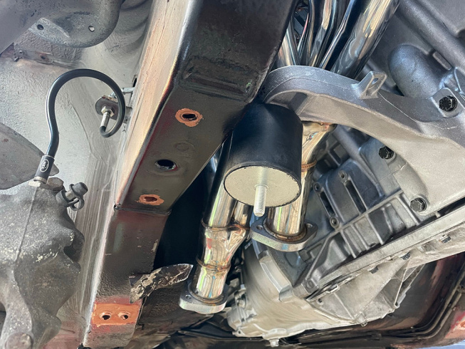

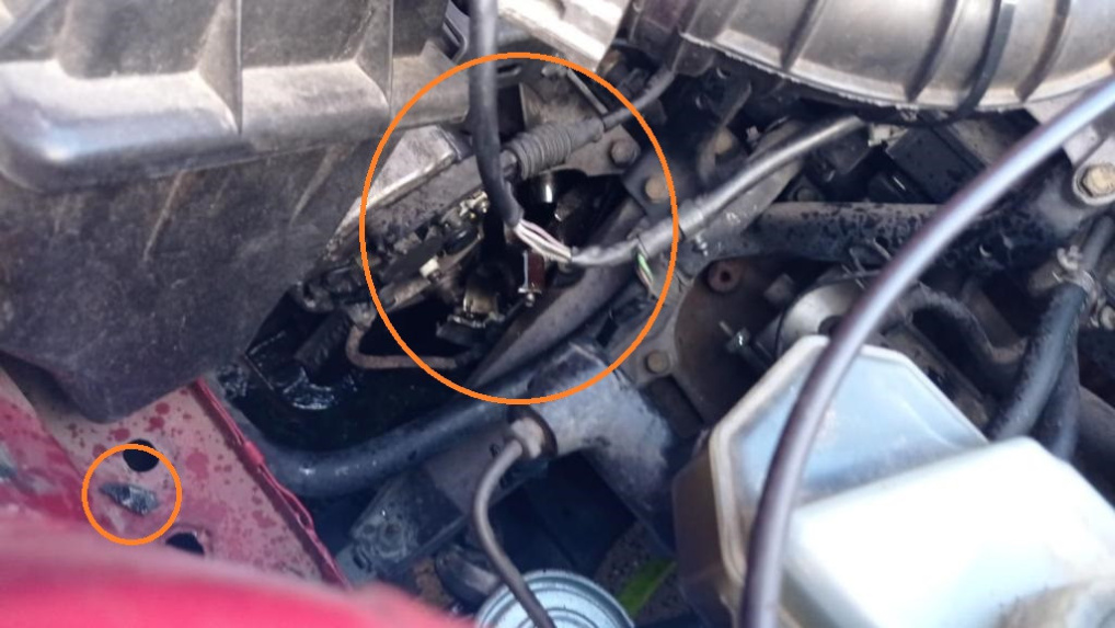

        Due to the engine failure I had to speed up the process. I was inexperienced for an M52 swap on an E30, I had seen many swaps in Spain done in a lamentable way, things not very well done, and the way I stay calm is to do them as best as possible.
        First: engine mounts, I did not like the idea of using eccentrics, because in my opinion the engine does not end up centered in place. I found the website 300mm.de in Germany. They make a motor mount and sell universal motor and gearbox mounts with the spacer in the middle (so you can use almost any mount in the future).
        Second, a spacer to keep the brake servo from touching the intake. Solved with a Chase Bays by USA kit (from your country), eliminating the brake servo.​

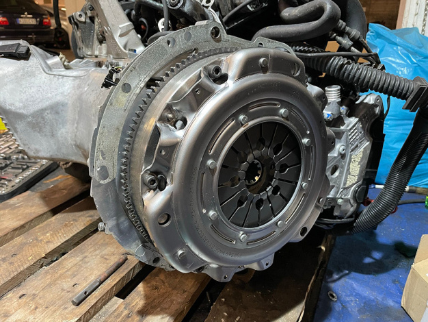

        Then I started to buy everything: engine, gearbox, gaskets, seals, hoses, elbows, clutch kit, bearings, etc.
        Once everything was ordered at home, the friend from Bonn and the Swiss friend organized to go to a "semi-public" parking lot to change the engine. We also took the opportunity to install a M20B25 in my friend's E30.
        We all took a week off to finish the cars. The plan was: joint help for the big stuff (getting the engine in and out) and then, as we needed help from each other, the third friend would give us a hand.
        Here we go!

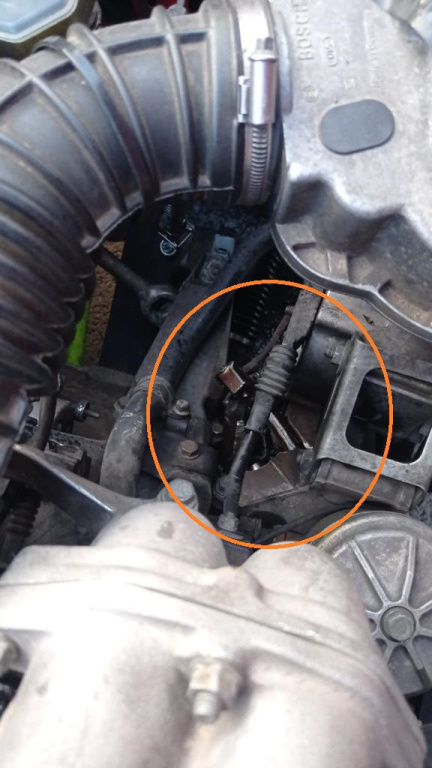

        I hired a trailer to pull my car to the parking lot, and once there, we parked in our respective spots and got to work.​
        Engine out! You have marked with red circles where the connecting rod wanted to take his vacations.

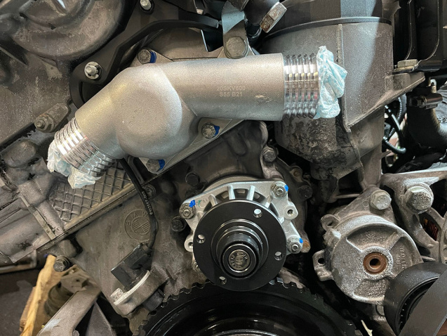

          ​This was the process of restoring the engine:
          Thermostat and water pump:
          Click image for larger version  Name:	B3cjgFE.jpg Views:	0 Size:	172.8 KB ID:	10125696
          Click image for larger version  Name:	qXnkxhO.jpg Views:	0 Size:	173.9 KB ID:	10125697

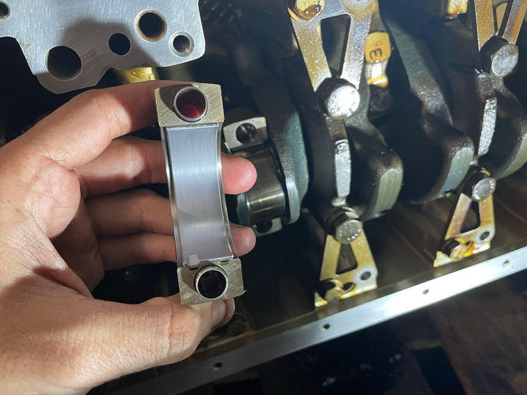

          Connecting rod bushings:
          Click image for larger version  Name:	bmyQShu.jpg Views:	0 Size:	177.8 KB ID:	10125698

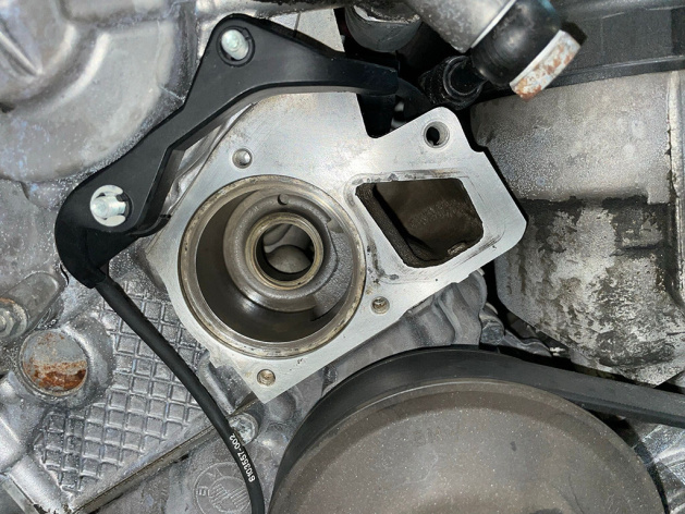

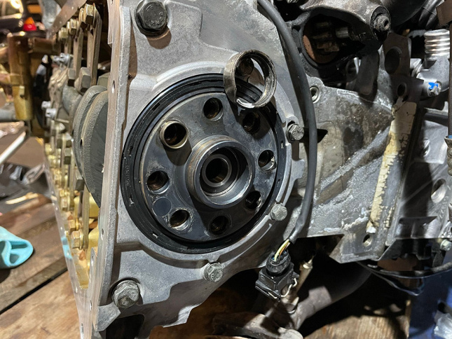

            Crankshaft seal and bearing:
            • MauR_95
              • Aug 2024
              • 47

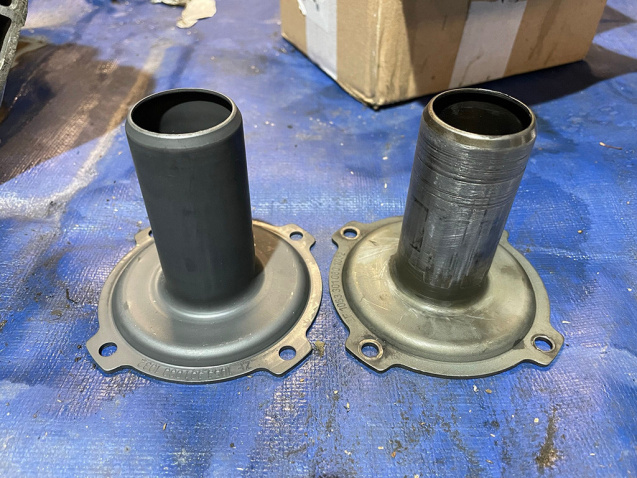

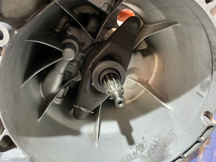

              Gearbox:

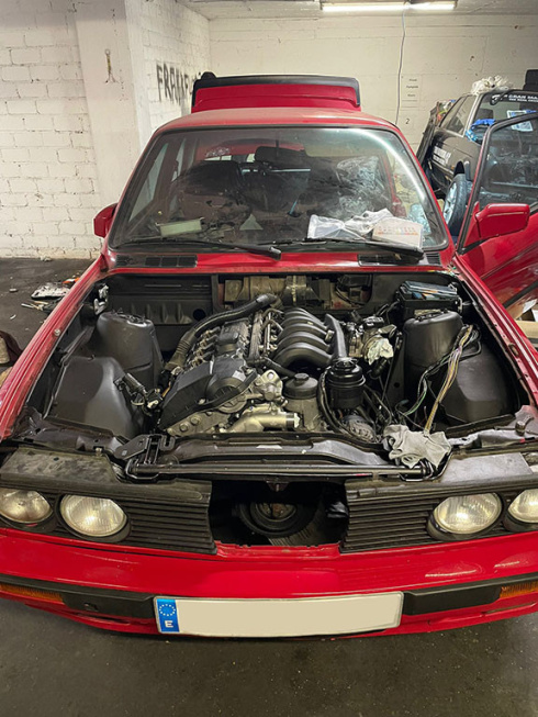

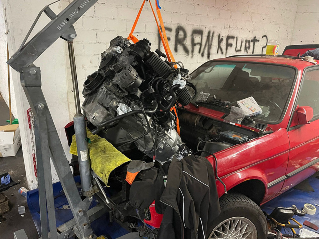

                  Let's ride it!
                  Click image for larger version  Name:	dBuFicy.jpg Views:	0 Size:	181.0 KB ID:	10125708
                  M52B28:
                  Click image for larger version  Name:	p3tSXTk.jpg Views:	0 Size:	172.3 KB ID:	10125709
                  To be continued...

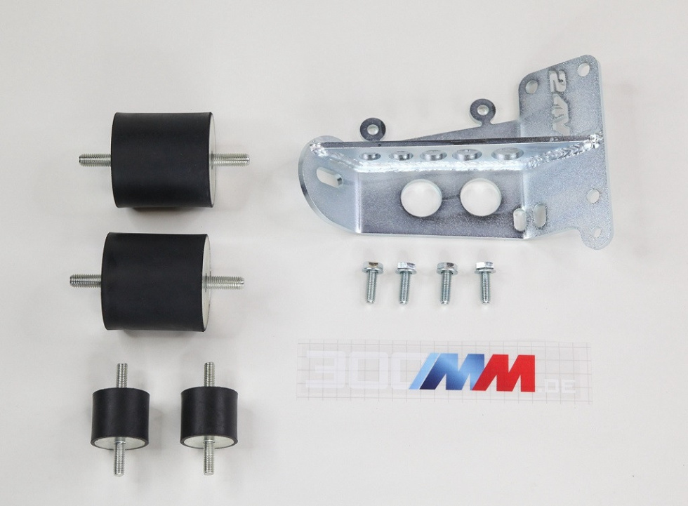

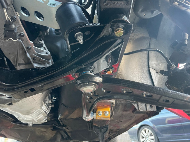

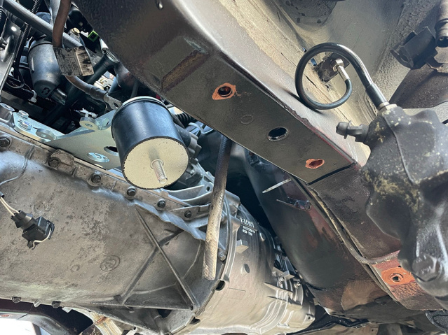

                    Kit mounts 300mm.de:
                    Take the opportunity to buy Meyle HD wishbones, together with IRP eyeball control arms.

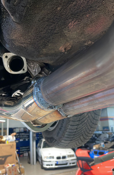

                        The only thing that was missing for me to be able to move “legally” in Germany was the exhaust, I had to find someone who could weld it for me. That didn't limit me to do the first tests on the autobahn and roads without exhaust.
                        To be continued...

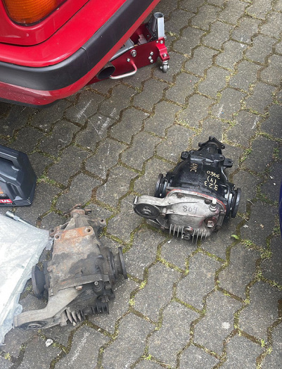

                          I also bought an LSD E36 3.23 ratio, adjusted to my taste.
                          Click image for larger version  Name:	WLMrDMs.jpg Views:	0 Size:	151.4 KB ID:	10125724

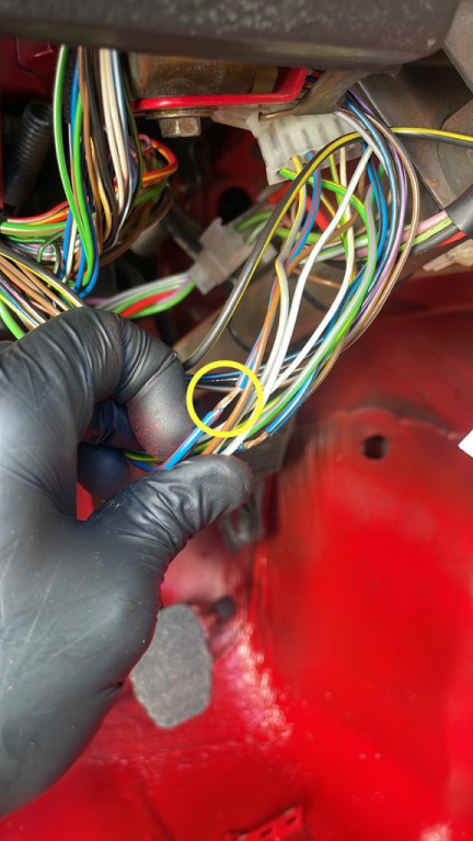

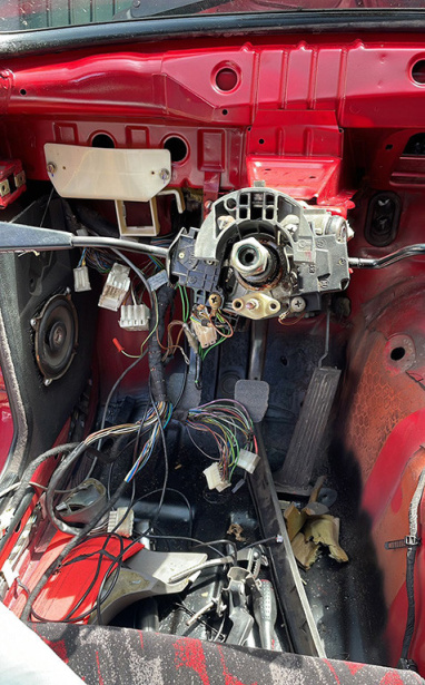

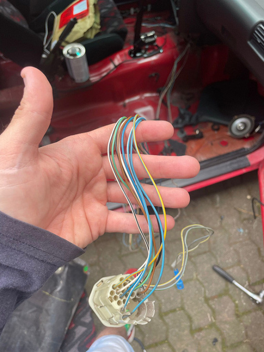

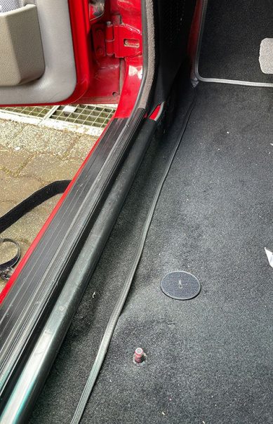

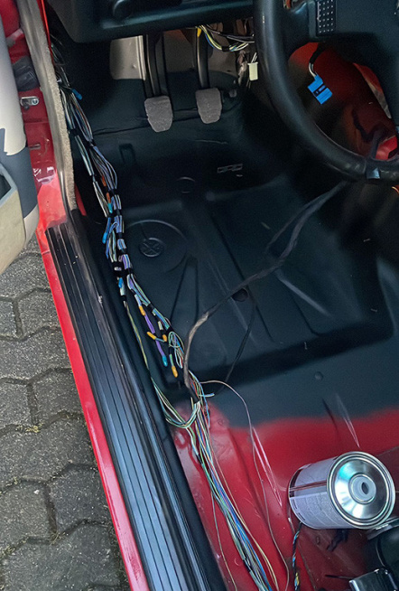

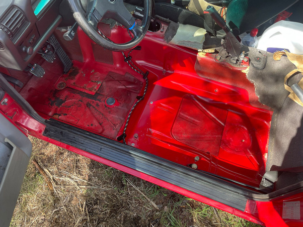

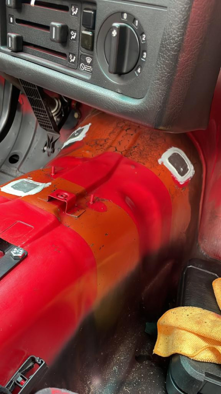

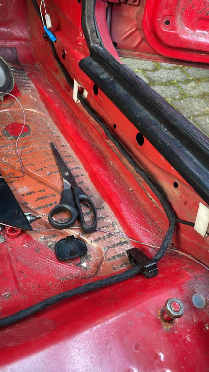

                            Some time later I started the installation of the car. I had to leave the interior well; I bought: black universal carpet, an aluminum plate to cancel the heating box, acetone to clean the glue of the wires and a lot of insulating tape.
                            The process was simple:
                            - Strip all the wires.
                            - Clean all the glue off the wires.
                            - Override the systems I was no longer going to use.
                            - Make sure all the wiring was okay.
                            - Tape all the wires.
                            - Plug the holes in the heater box.
                            - Clean all sheet metal from the floor.
                            - Install the carpet.
