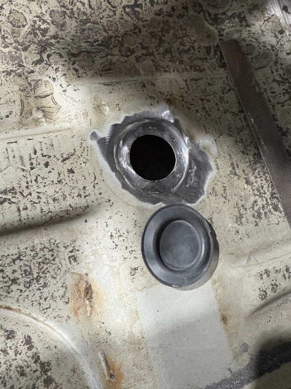

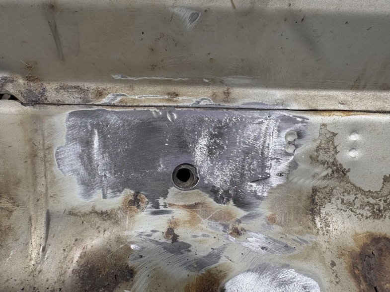

      Had to fix this body plug hole, I forgot to take a photo before but it was rusted about half way around the diameter of the plug.

        E90 floor plugs are a direct fit (41007140847), if you need one.

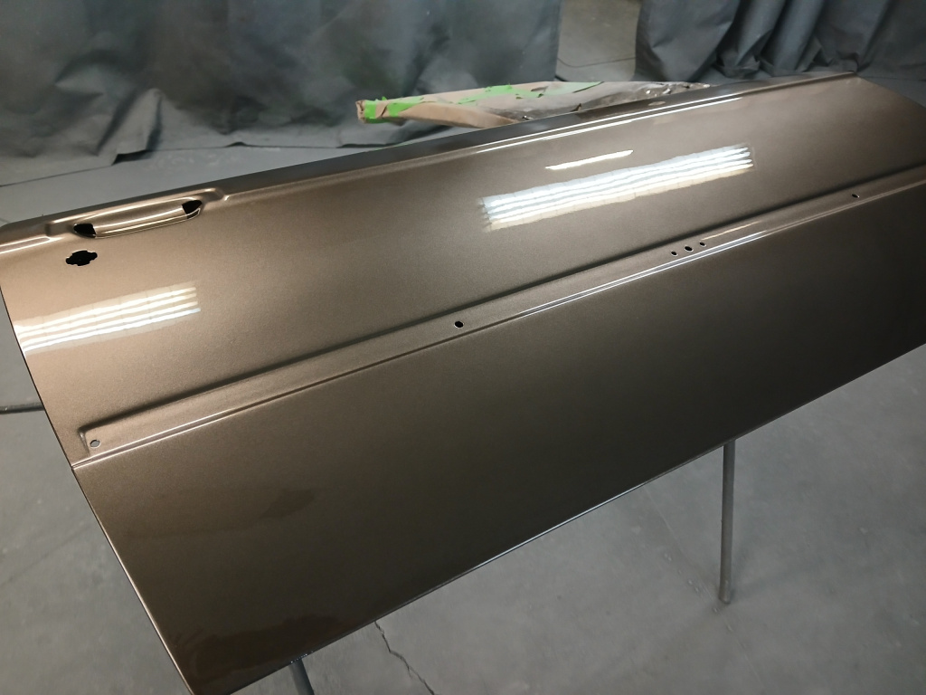

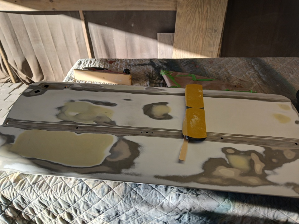

          This door was a complete POS. No rust but plenty of dents, my paint guy was cursing me, not sure how it's gonna turn out lol.
ID:	10168808 Click image for larger version

            Paint guy said he got the door looking pretty straight, looks good enough for me!

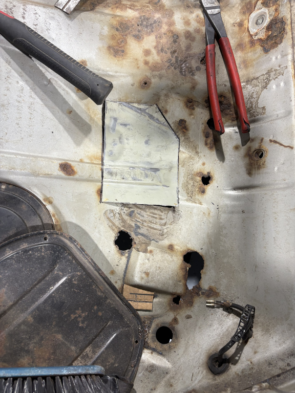

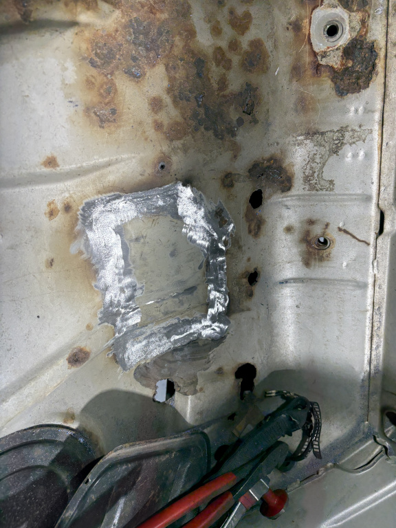

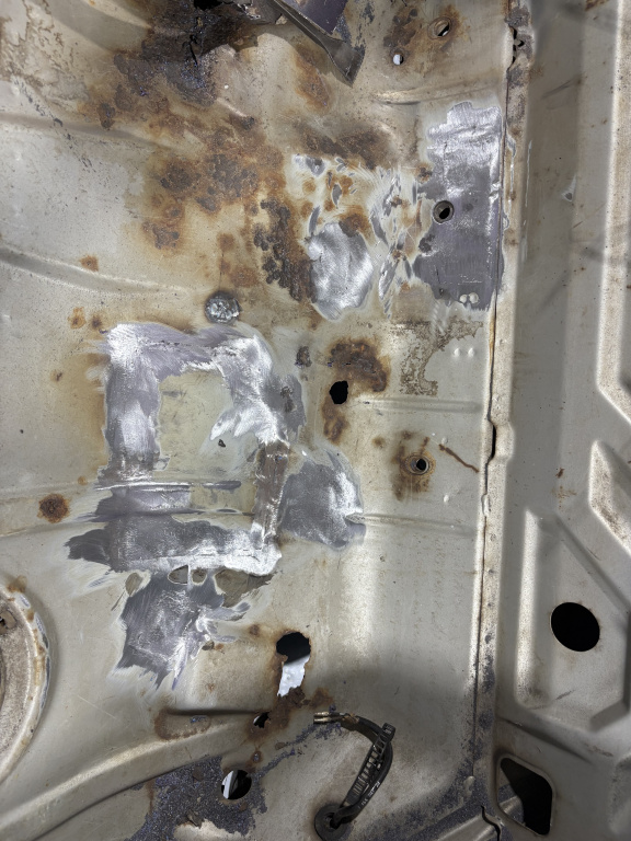

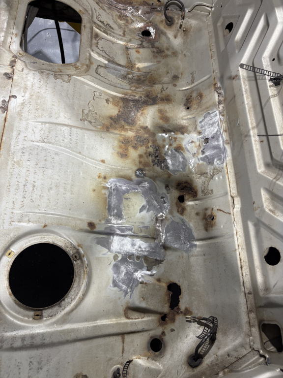

            Took a section from the floor pan that I cut out so I could use the pressing and match this are under the seat. Ultimately no one will ever see it but it was an easy fix tonight. Now to work on the EIGHT other small holes lol I have to get them done this weekend and at least primed. Still messing with finding an undercoat that looks factory. I might have to just suck it up and buy a bottle of schutz.
ID:	10168865 Click image for larger version
