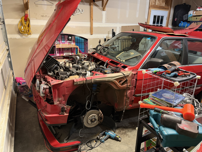

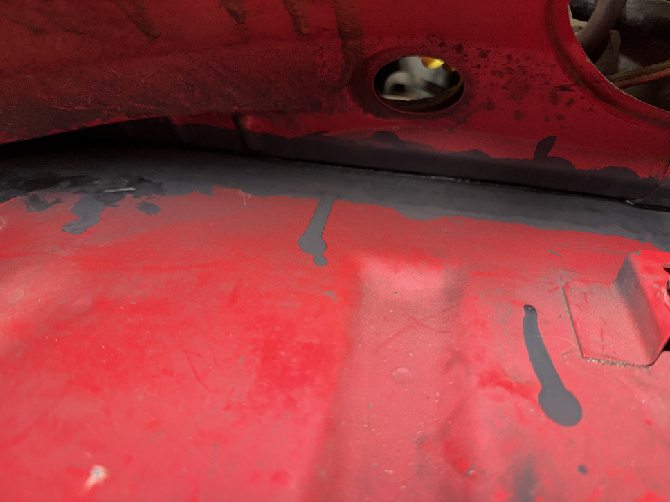

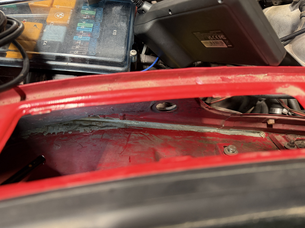

    First weekend in, and I was working on mounting and wiring in some E90 seats when I discovered the driver's side footwell was fully saturated from the previous night's rain. I traced the water intrusion to two points, the rocker drains had been pinched shut and were overfilling into the floorboard and the seam sealer inside the cowl drains had cracked there was a small rust spot and seepage on the firewall directly behind the dash. Rocker drains was a quick fix, followed by a flush and some Dinitrol Cavity Wax.

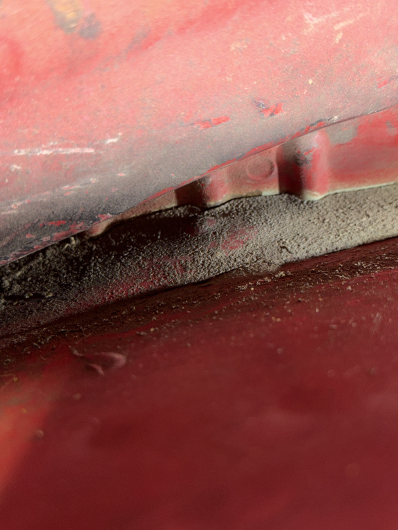

    First step to remove old seam sealer was give better access to the cowl drain on the driver's side. So off came the front bumper, fender, blower motor and wiper linkage. With a heatgun, flat head screw driver, chisel, and some picks it was surprisingly easyish to remove all the old seam sealer.

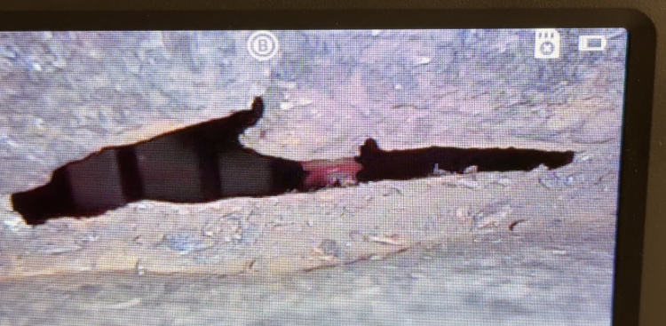

    The rust inside the frame portion of the drain did not look great through the small hole, so i fed an inspection camera in and after cleaning out the old sealer and hitting it with a wire brush Dremel wheel it looked rough. Click image for larger version

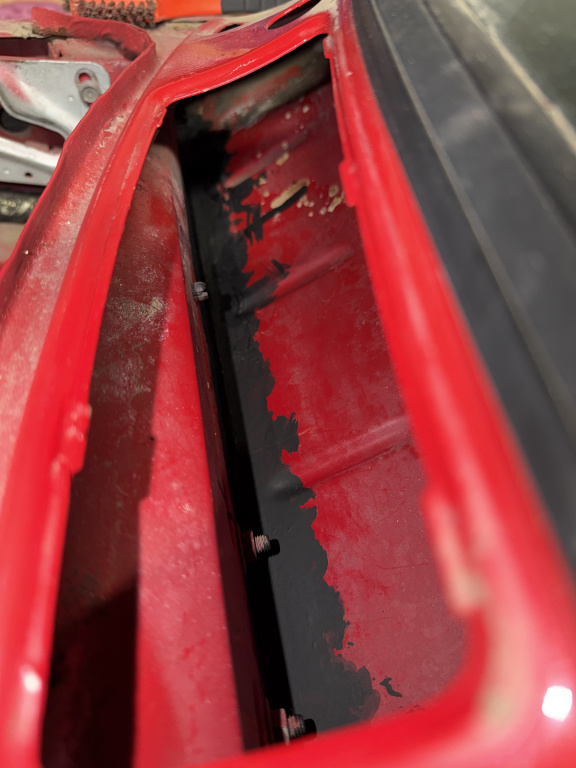

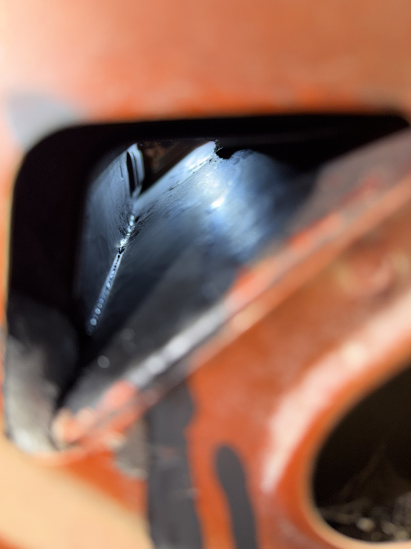

    Primer has been applied to all of the bare sections of metal where the seam sealer was removed, now just waiting for it to cure properly and hopefully seam sealer on Monday.

              Seam sealer is in, looks about as far from pretty as possible, but it's sealed and covered up with cowl vent covers.

              Thankfully putting the blower motor and wiper linkage back in was quicker than taking it all out ("correctly" remains to be seen with further testing).
