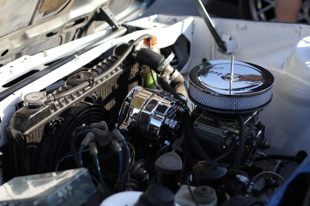

                        GM style ford alternator conversion. the belt slips on the pulley now... stupid chrome. sounds like a super charger, in an annoying way.
                        I went ahead and ground a bunch of useless material out of my spare intake manifold, took out stupid things like the shutter valve, welded some holes shut with the TIG, and made me a carb adapter like so:
                        It's not perfect, but it works.
                        intake manifold comparison:
                        And boom! holley 465 swap:
                        I finally got rid of the vacuum leaks and I'm getting it tuned decently. The car runs better than ever, I kid you not. Now if only I could manage my stupid belt squeak. I'm attempting to de-chrome my pulley in bleach, part of it is pitted now, so I might just need a bigger pulley for more surface area... preferably one that isn't chrome.

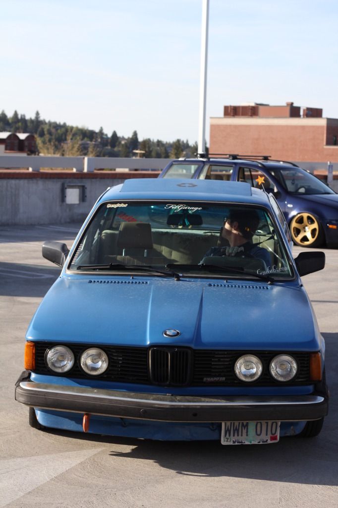

                          couple more pics of it from recent times
                          I also broke the front ring and pinion on this, and I'm putting a cage on it soon. Basically, this means distractions form the E21. I'm also injured too.
