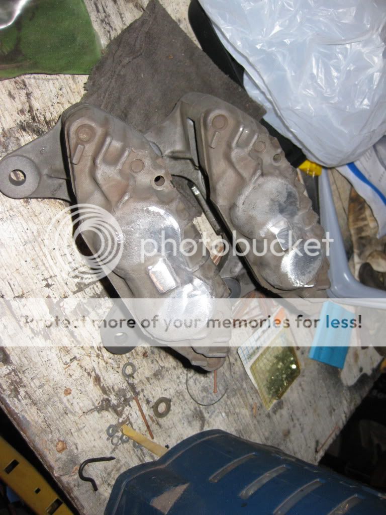

Did a little work to the calipers for some extra clearance. I mocked the caliper up the the strut with a kopi on and without spacers the little nub on the face of the caliper literally fits between two spokes. I usually run 5+mm spacers in the front with those wheels and with the nub ground down a little but it shouldn't be a problem.

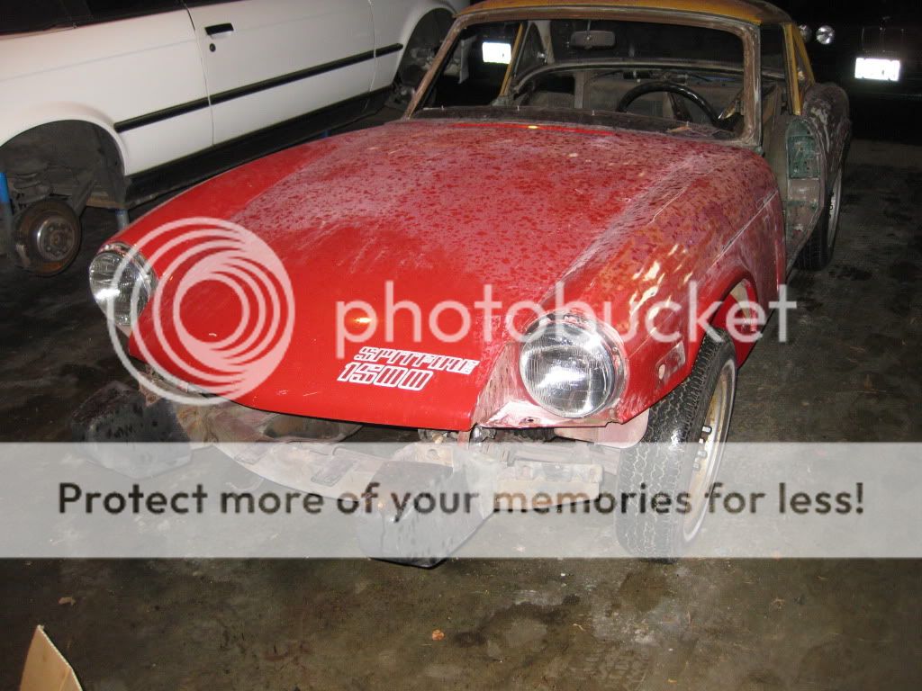

Dad was moving cars around in the shop so i have a new stablemate for now

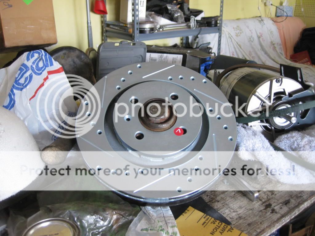

Haven't updated in a while. Got the rotors yesterday. The people who made the rotors i bought a few years ago also make a corrado rotor so i was able to get a set to match my rear rotors.
Still no spacers yet :(
