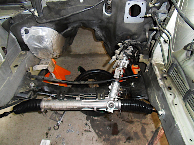

          Fresh control arms in. E36 Rack installed. New boots, mounts and tie rods installed:

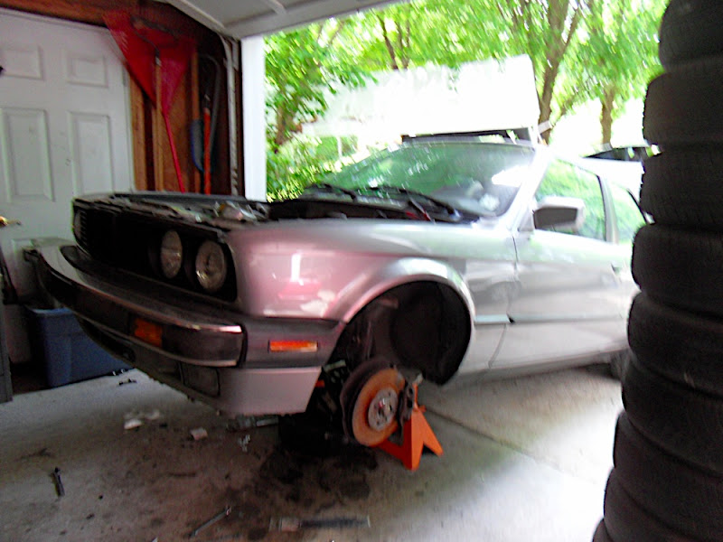

          And she is getting worked over...

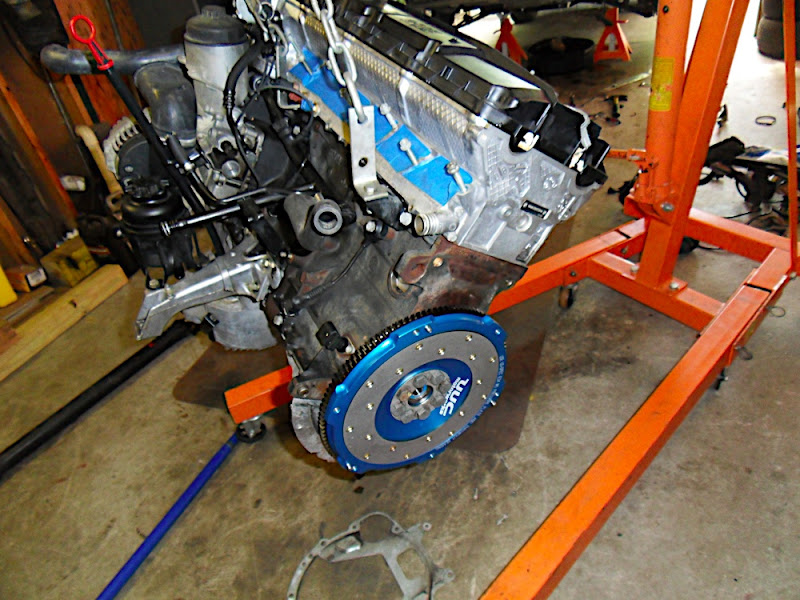

            Progress... S52 oil filter housing. Headers. New Valve Cover. UUC Segmented Kevlar...

                why s52 oil housing?
                  Motor had this weird PS pump that wouldn't connect up easily to what I had. Thus a swap and an OBD1 style PS Pump. Problem solved. Plus it is an upgrade over the other. Can run UUC oil center if I wanted now. And it is sweet mtech part. Totally could put on an ///M badge now.
                    oil center? and is the m50 one plastic or something? Im keeping a list of things for when I swap....thx
                    btw ill sell u an m badge 11$ shipped ;)
                      You can run gauges off the UUC Oil Center. It is for the metal oil filter housing. M52 had the plastic one.(see pic 2).
