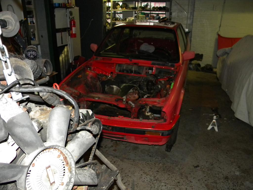

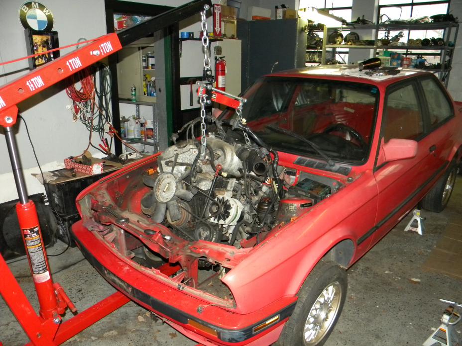

          Time to take the engine/trans out...
          Levent
          %20levent@gutenparts.com
          Ladies:
            #35
            Out...
            When you see it you will $hit bricks.

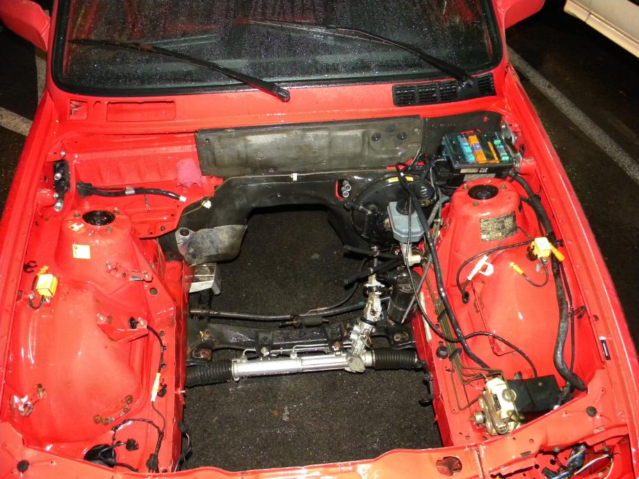

              Cant wait to clean the bay out... Who ever invented the pressure washer I salute you....
              Before...
              Levent
              Ladies:

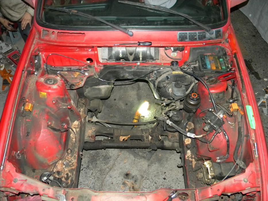

                #37
                After...
                Levent
                Ladies:
                  #38
                  holy shit that thing was dirty in there...nice work!
