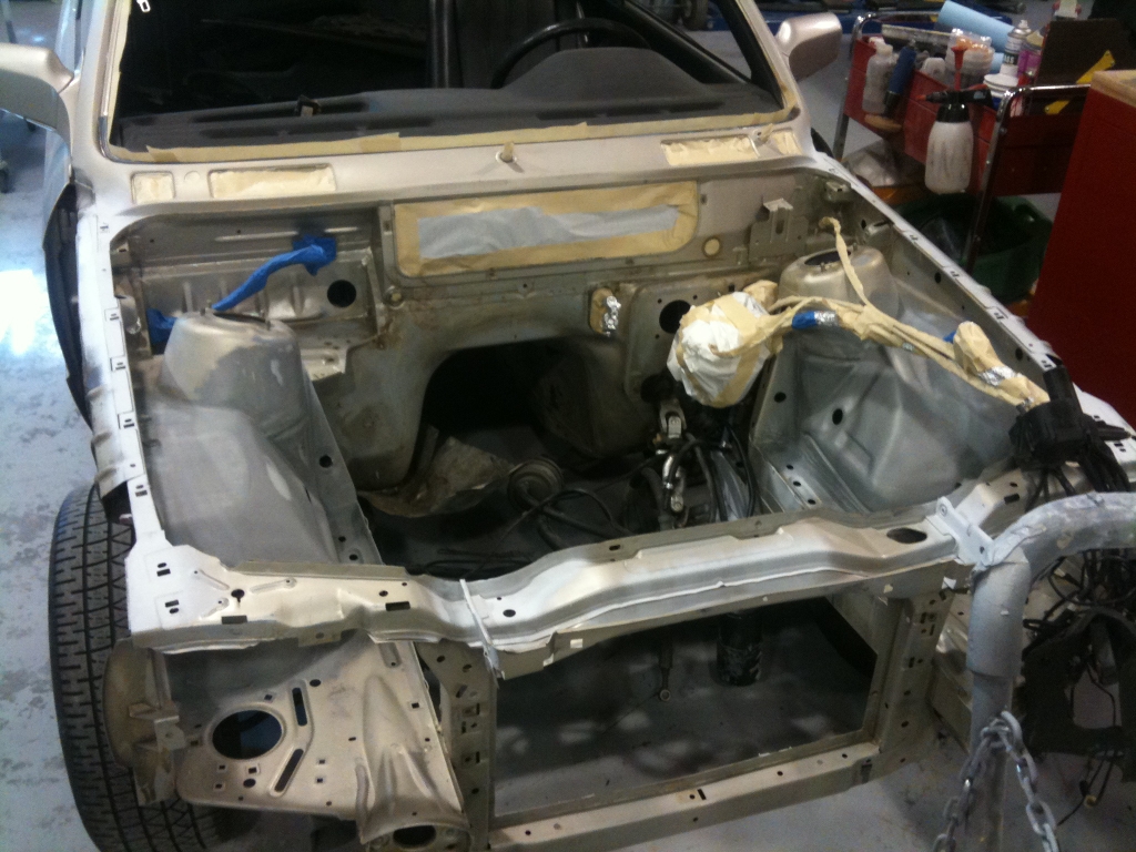

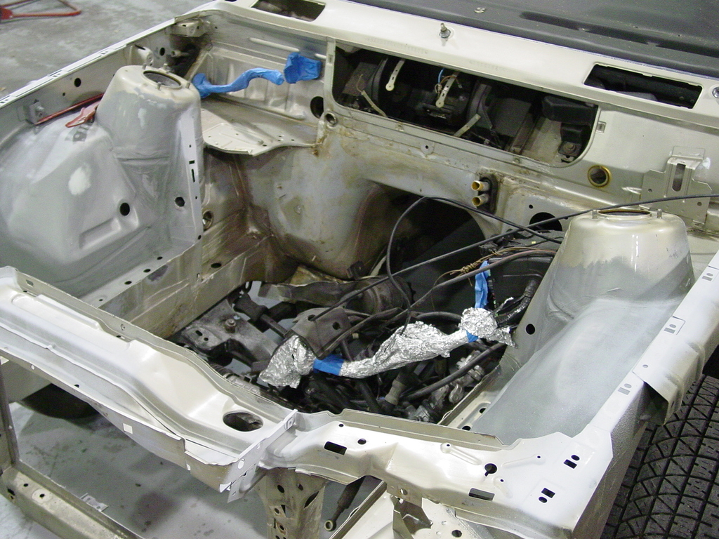

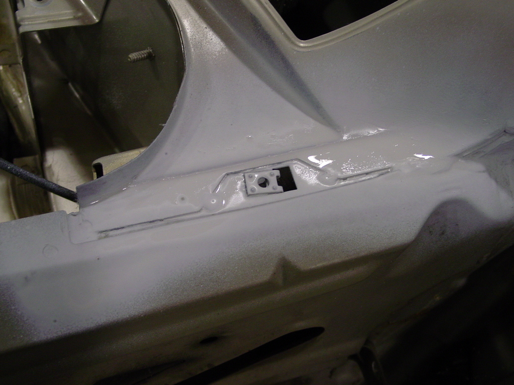

    No painting done tonight, it will have to be Monday. Here are some shots of today's progress though.
    Seam sealer off the fenders:
    Primed:
    Rust removed from the lower core support and more scuffing of the paint:

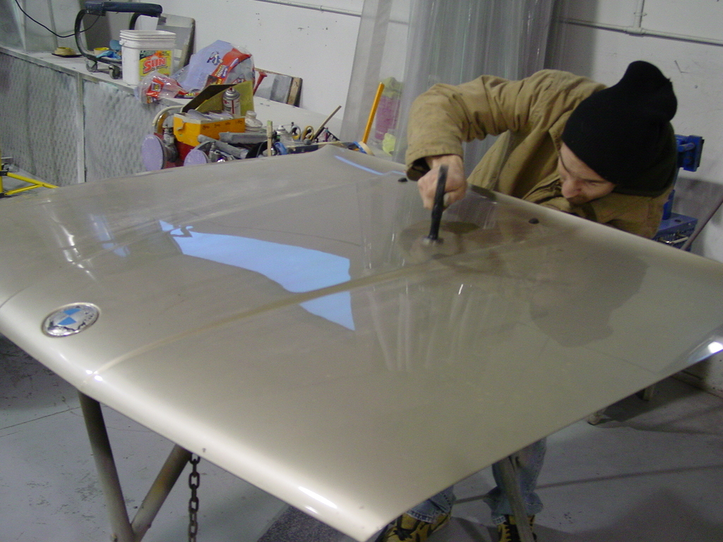

    Nate working some dents out of the hood for me:

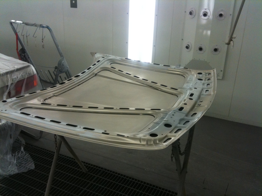

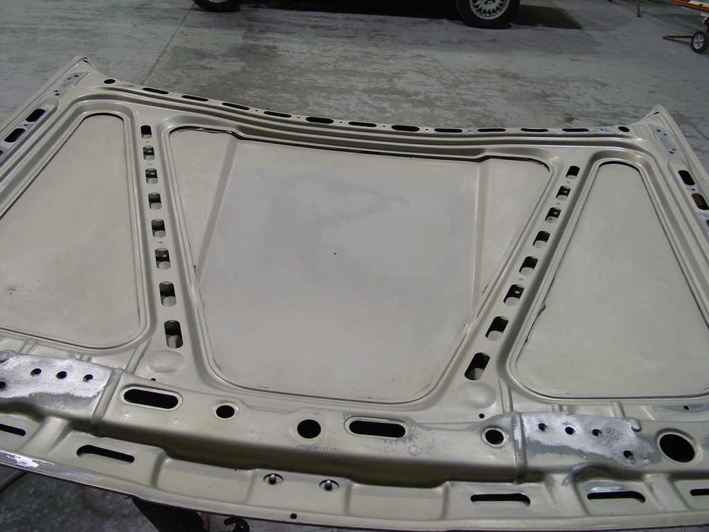

    Then I began work on the hood, scuffing and lots and lots of rust removal:

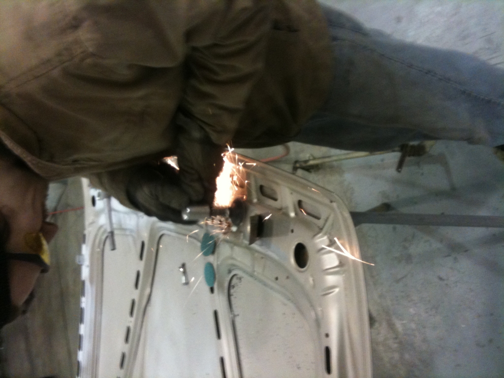

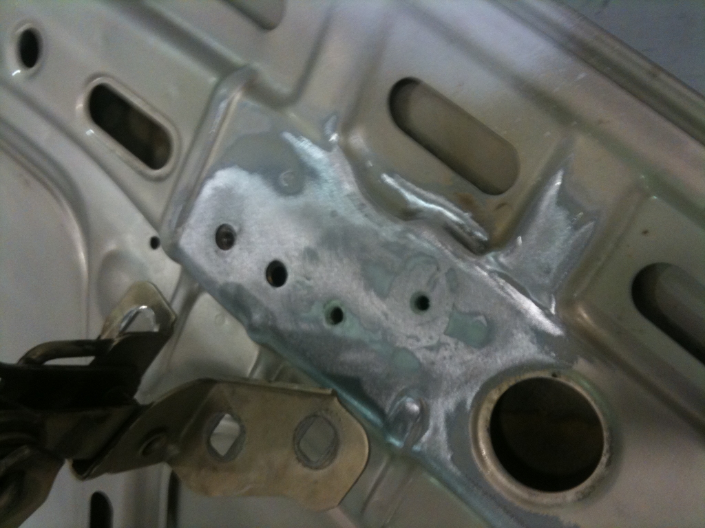

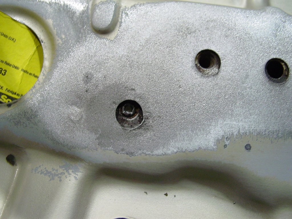

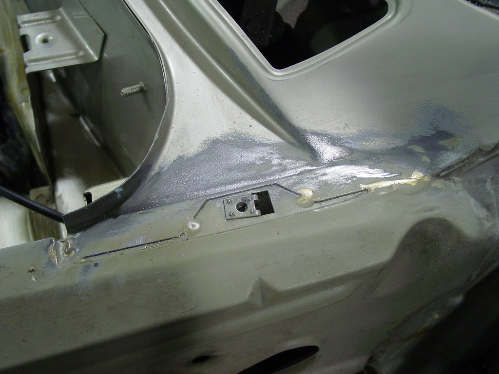

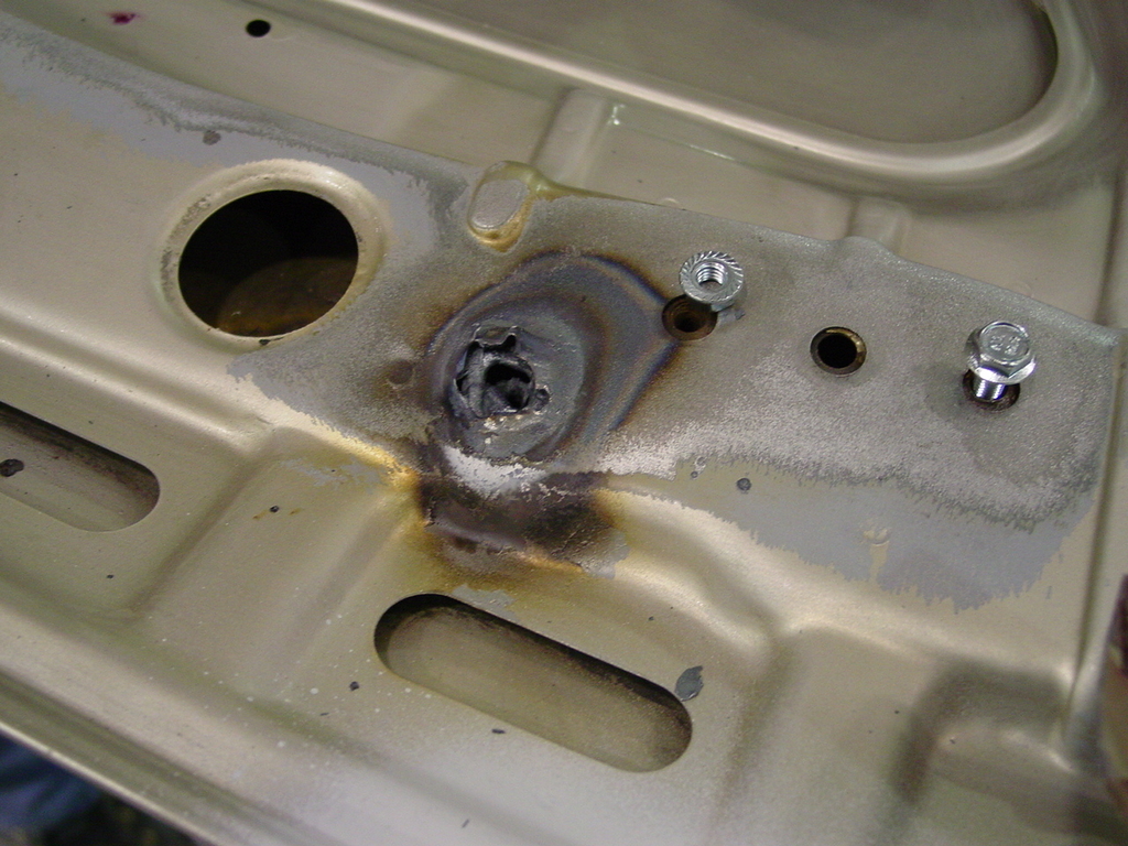

    I had a bolt broken inside the hood's nut-sert. I tried to use a reverse drill bit to remove it but it broke inside... UGH. Good thing I have pro's looking over me.
    The problem:
    We tried to burn out the broken stud/drill-bit but it backfired. The broken drill-bit was the least piece to melt and this created a hole:

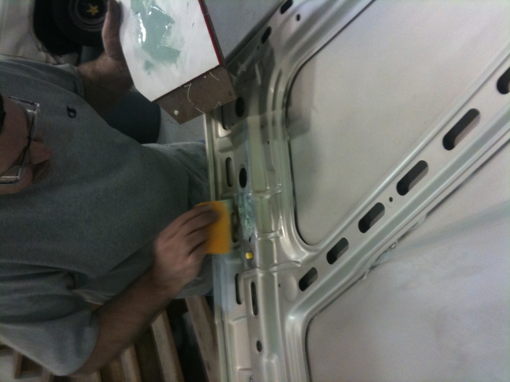

    The final solution. Drill out a new hole and weld in a new nut-sert. Once again, glad I'm around professionals, I learned so much in one afternoon.
    Chris choosing the proper bit size:
    Nate grinding down the newly welded in nut-sert:
    Chris adding Glaze to the slight imperfections:
    Problem fucking solved:

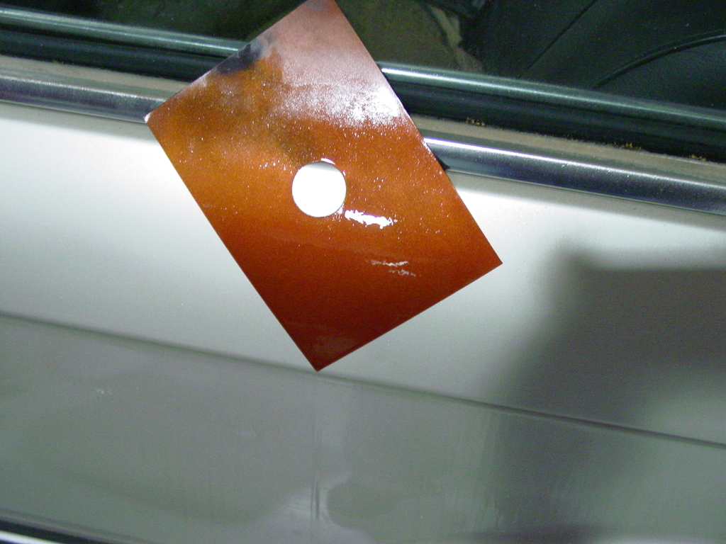

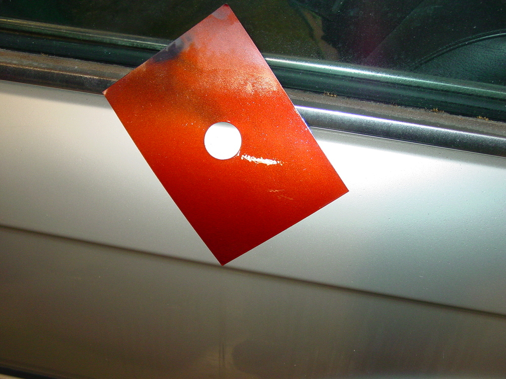

    Sorry about no paint for those waiting. But here are some pictures of the color I chose.
    Sunlight simulated:
    Cloudy/night color:

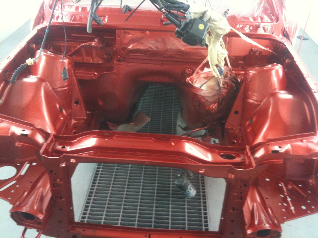

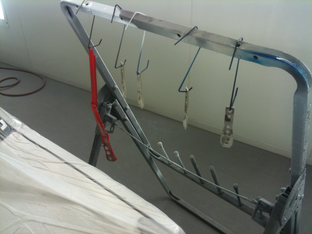

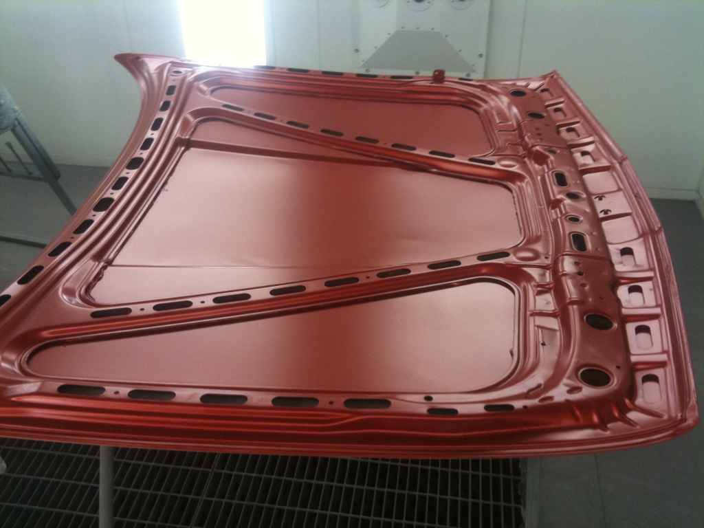

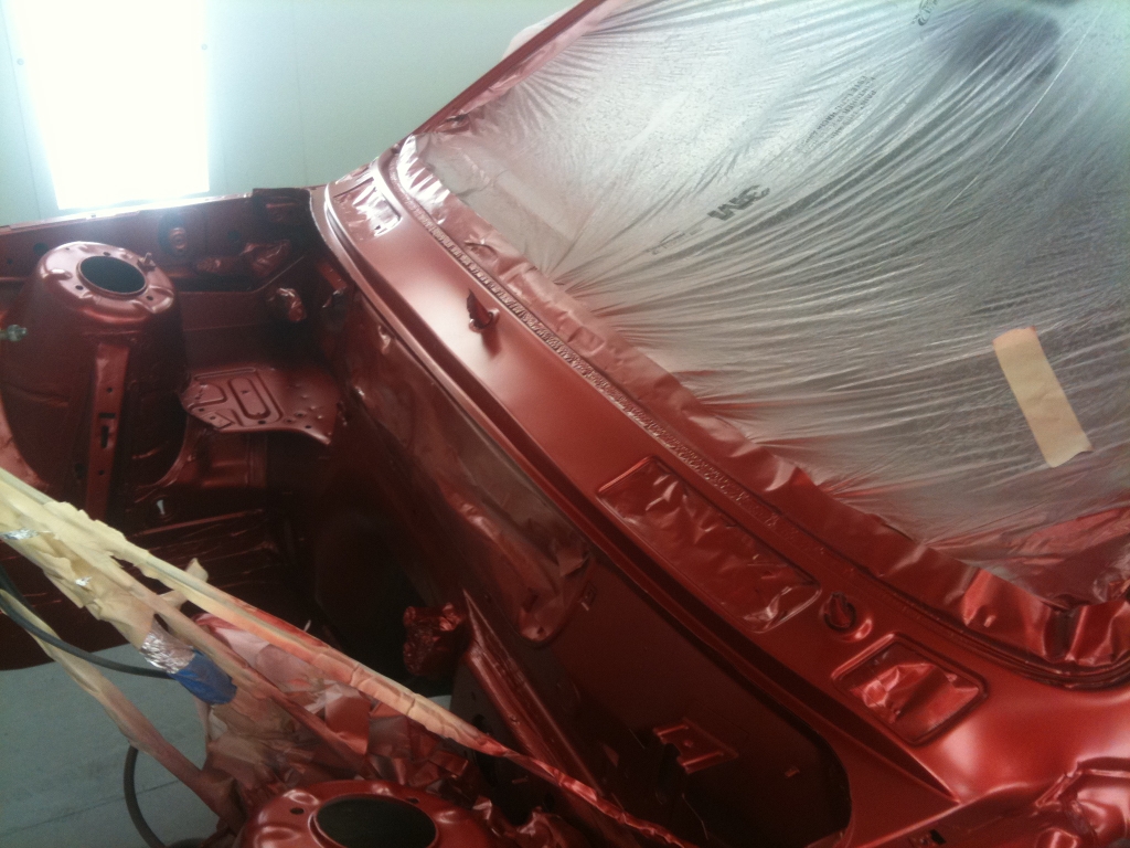

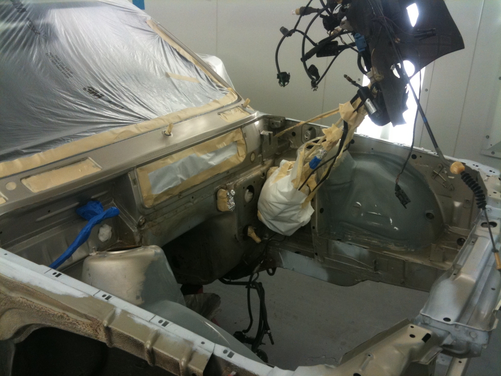

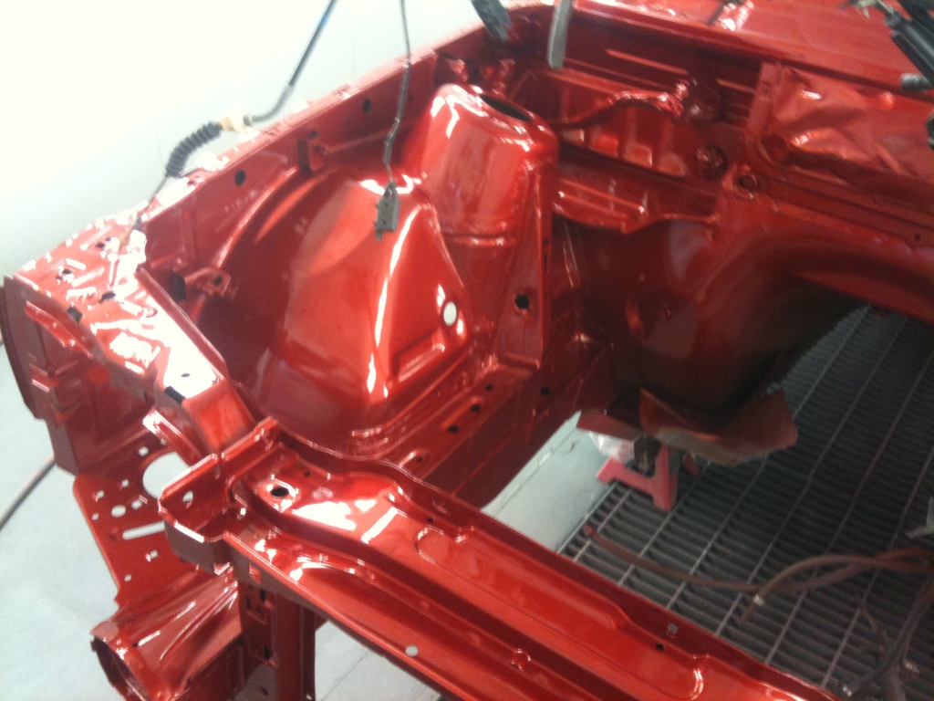

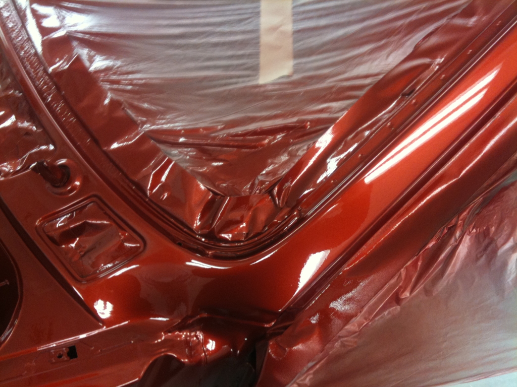

          Getting ready and entering the paint booth this morning:
          Mixing the color!!!

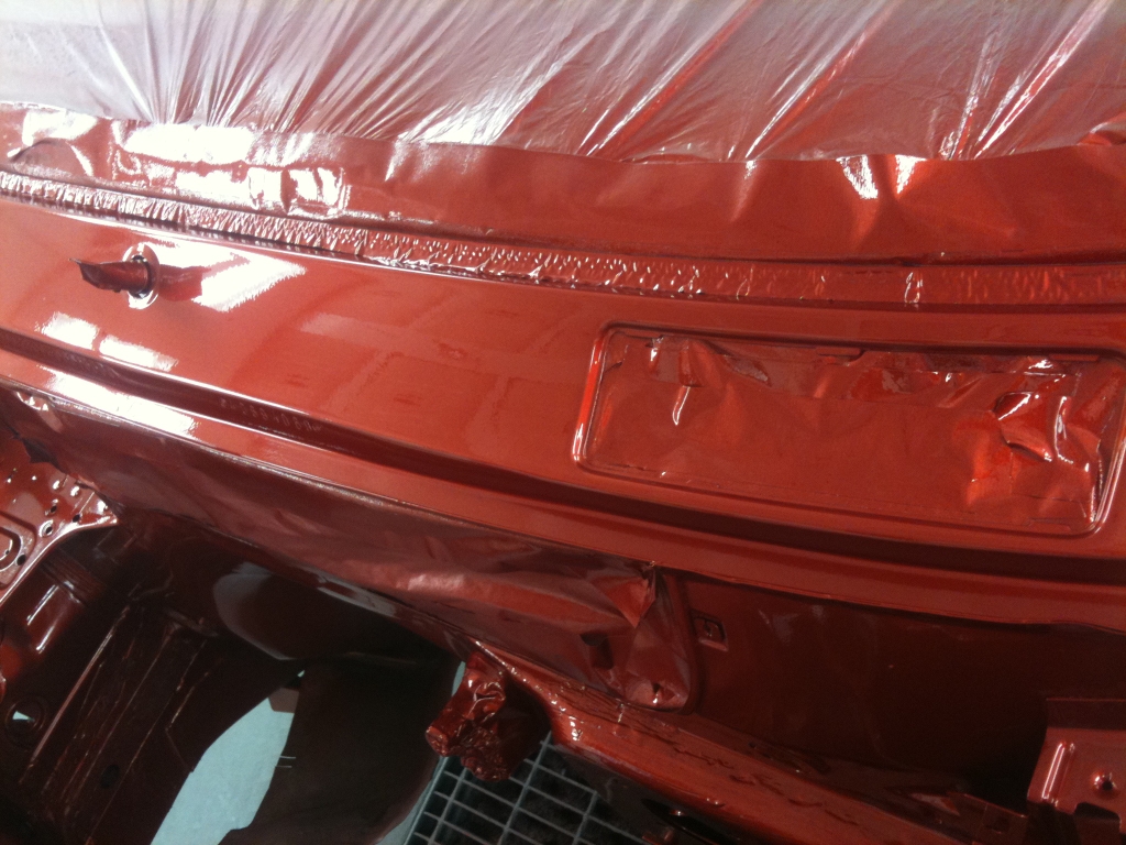

          Base coat on! one more layer before clear:
          More in about an hour after clear is on.
          1987 PRO-3 car /1990 325is (2.7i Concours)
          • Jparkr
            HR Admin
            • Jan 2006
            • 3494

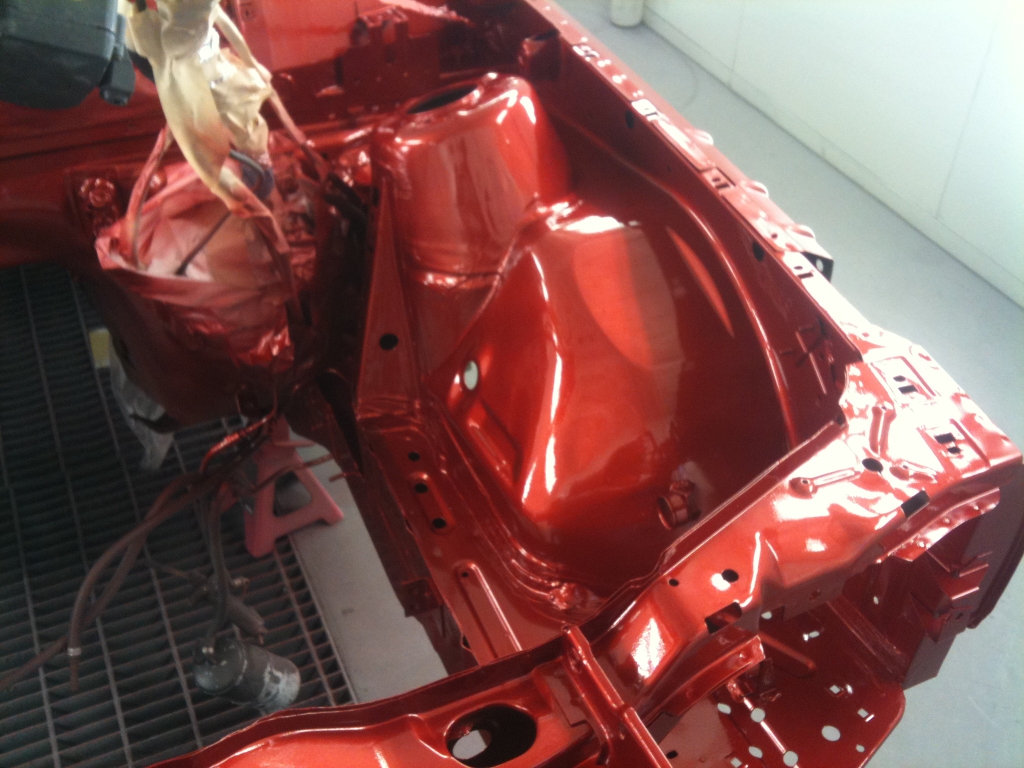

            Clear coat is on and I had to go home and change my pants. Then I looked at these pictures and had to go change them again. I am running out of jeans...

              Like how the color turned out. Great prep always makes for a nice paint job no matter the color. Great job!

                            It also makes me really glad that I didn't end up with a beautiful gloss paint job in my engine bay. The first time I dropped a wrench, or bumped one of the arms into it when dropping in the motor, I'd probably kill myself.

                                I was thinking about using that color for a long range project...maybe a bit more orange but WOW, that looks great. That glossy shaved bay...yummy! Im sure that caution is just needed when putting the bay back together. :up:
