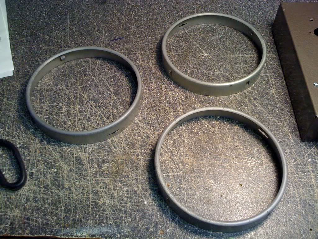

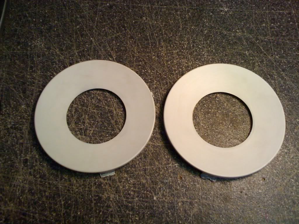

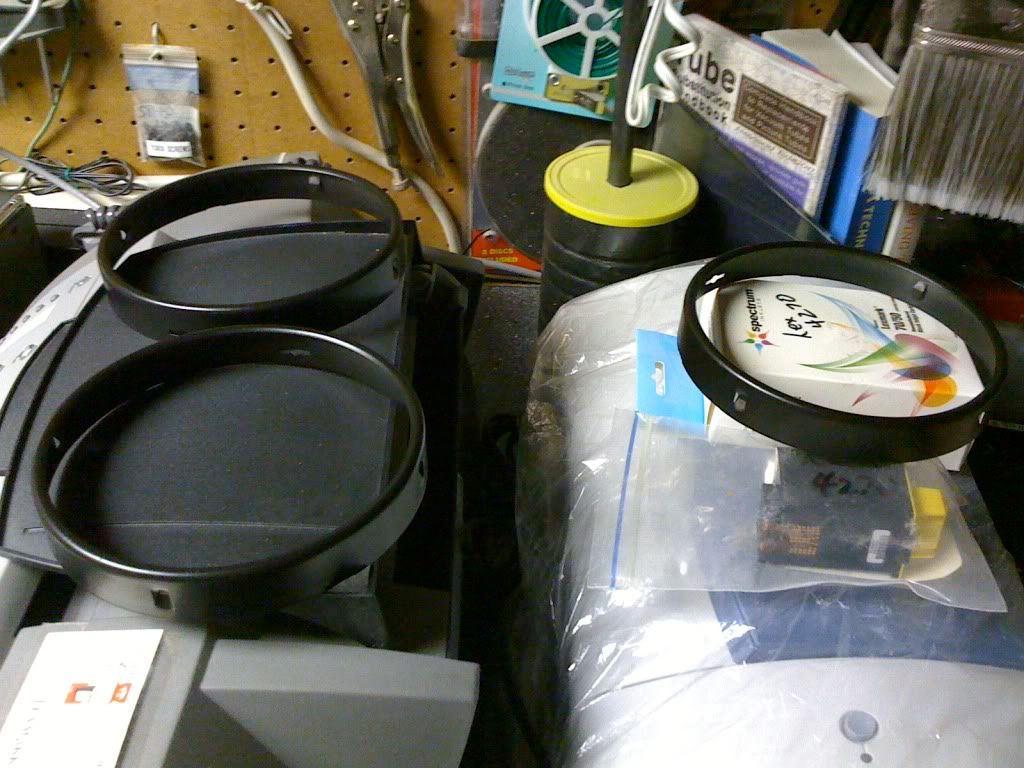

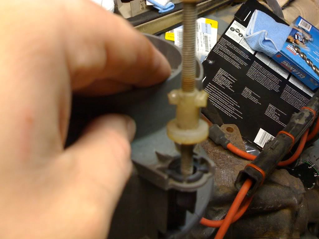

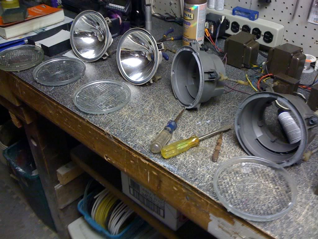

                  Some weeks ago I took a trip home from school for the weekend and went through the process of smoking my US ellipsoids. I didn't document it as well as some of my other work, but I think you should be able to get the gist of it:

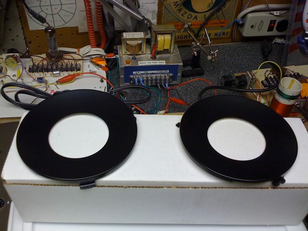

                  Trim rings popped off easily and were scrubbed down prior to painting:
                  For some reason my car was missing one of them, but I painted the three that were there with some SEM trim paint. Since then I've secured a replacement for the missing one and will paint it over spring break while I'm at home.

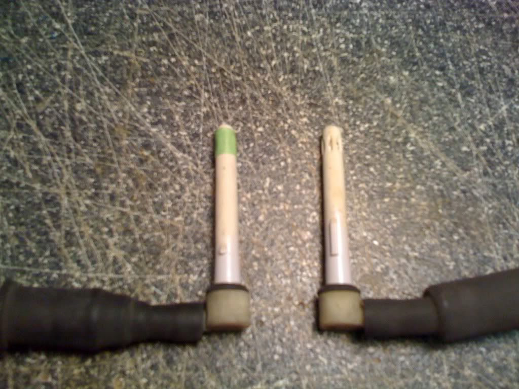

                  Some people have a lot of trouble with the little black cups shown in the bottom of this picture:
                  I found it easiest to simply rotate the whitish (now yellowish with age) plastic pieces until they could be slid out of the housing. I did this with all of mine, broke zero black adjuster cups, and saved a ton of hassle.

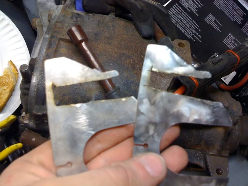

                  After some time in the oven and some gentle work with a screwdriver, the lenses were coerced off the housings:

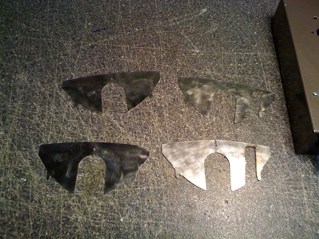

                  The blinds from the low beams came out shortly after cleaning some of the adhesive off of their alignment tabs, and a little steel wool made short work of the chrome coating:
                  SEM then made short work of the exposed plastic:
                  This is where things took a bit of a less typical turn. OEM Hella smoked headlights use a + arrangement for their crosshairs in the high beams, which is impossible to replicate with US ellipsoids due to the evaporation extensions at the top of the housings. Trimming the crosshairs to allow space for the evaporation tubes can allow you to go with a perfect + instead of the typical X, however:
                  Since I was losing a lot of material that would have been painted black and contributing to the smoked reflection effect, I figured I'd paint the evaporation tubes too, so that I didn't have white plastic hanging around what was supposed to be a predominantly black area:
                  Make sure to tape up the actual openings so that you don't get paint on the tiny balls inside the tubes and gum them up, preventing moisture from escaping.
                  Unfortunately I stopped taking pictures at this point for some reason, but they came out very nicely, aside from a little condensation I apparently allowed into my passenger low beam, which I'll have to crack open and dry. Over break I'll also get a couple of pictures of the finished product for comparison.

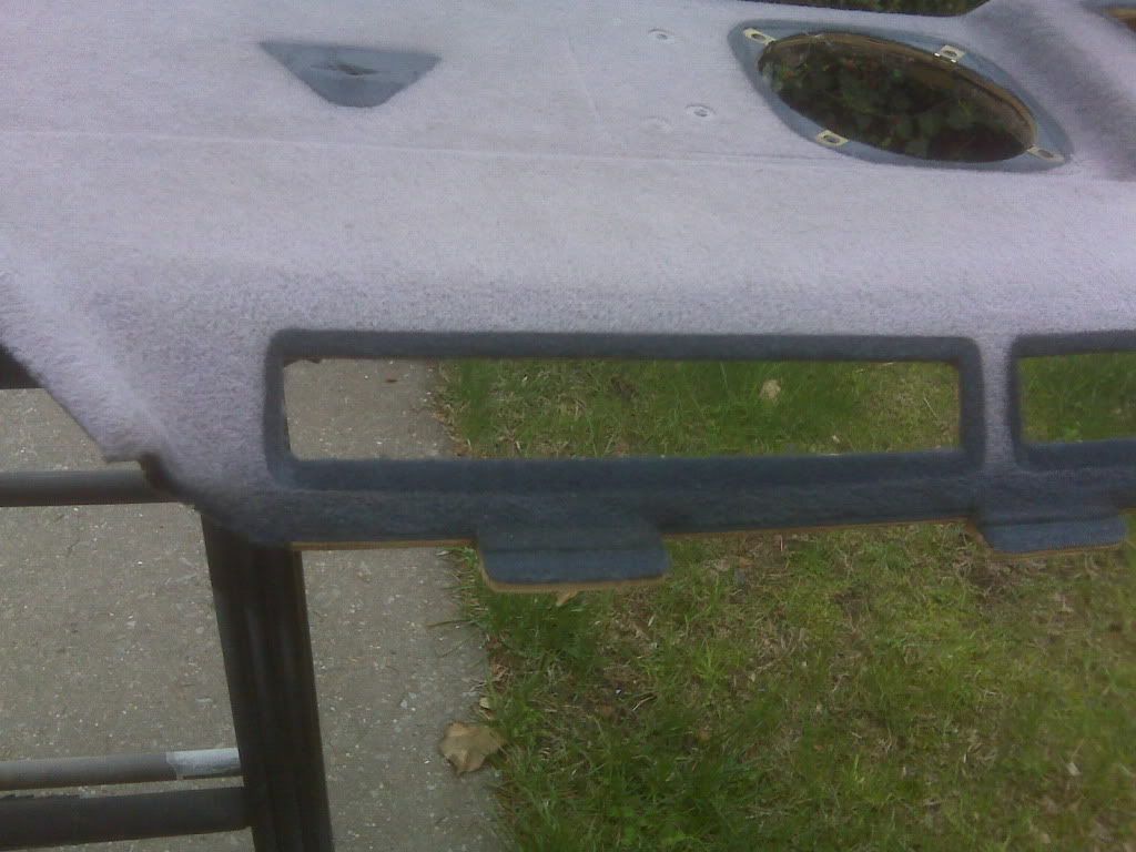

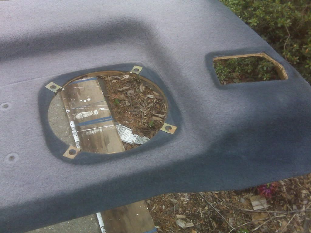

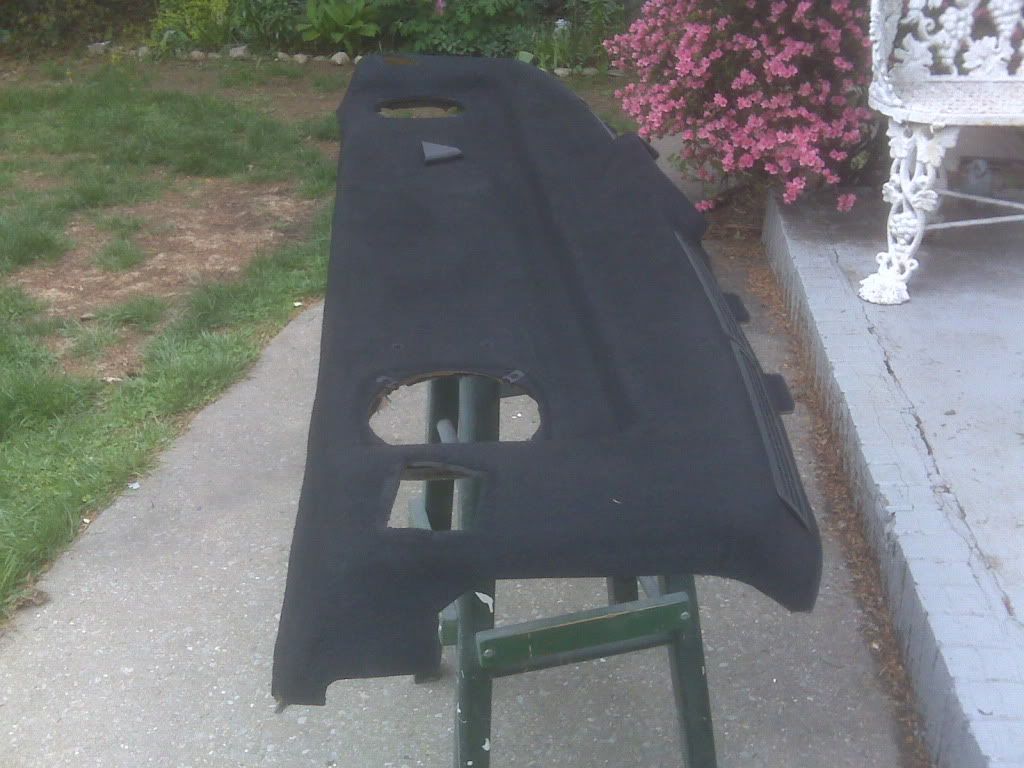

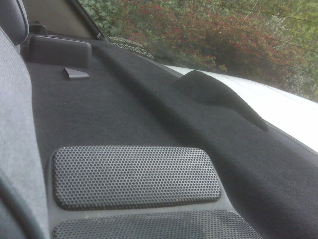

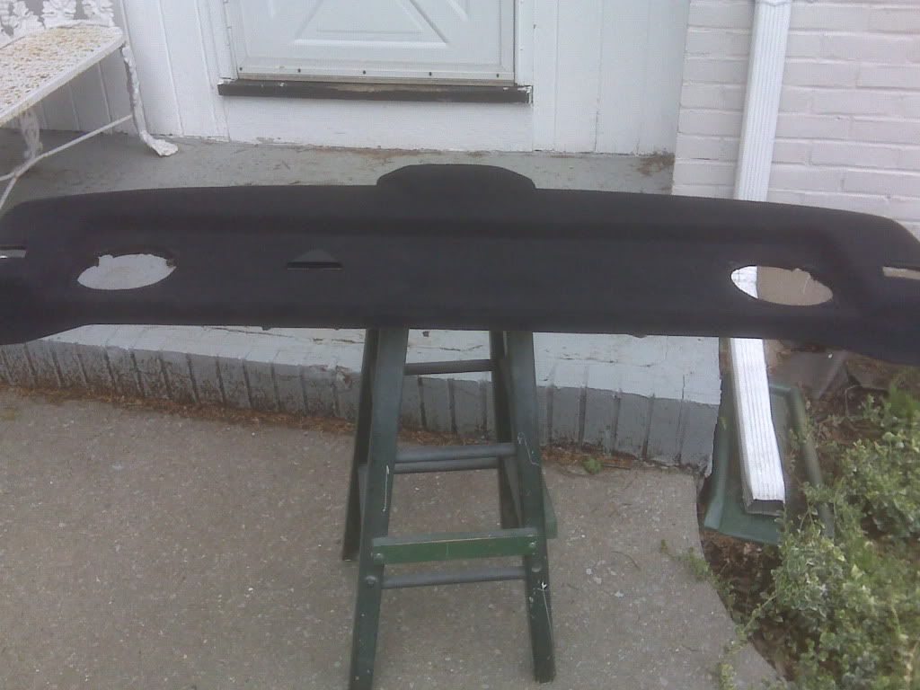

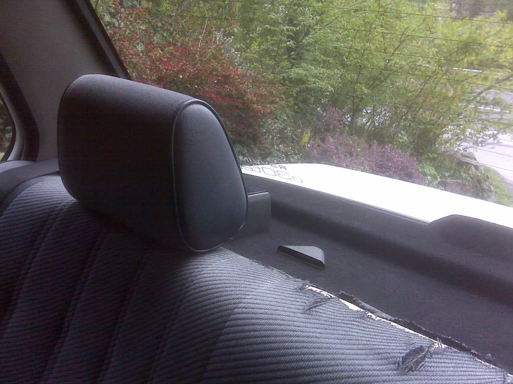

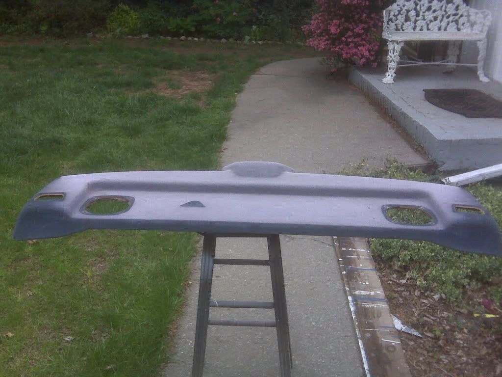

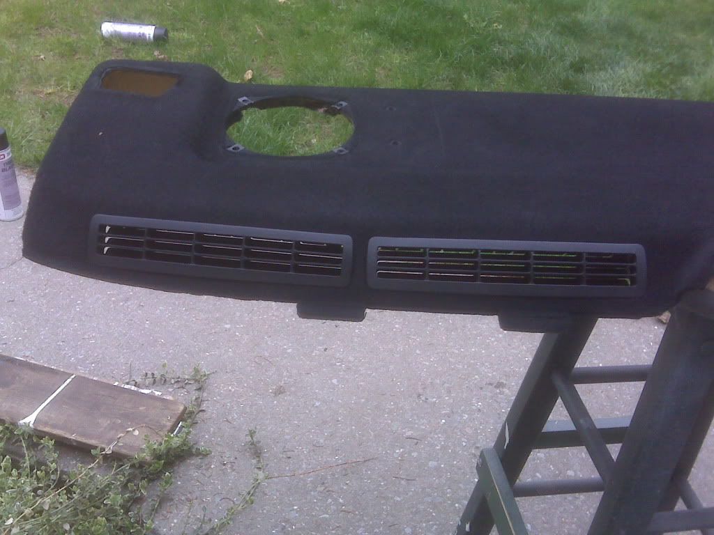

                          Had some spare time at home this weekend since I went home to work. Little car projects make me feel good and take my mind off of not nice things, so I decided to refinish my rear parcel shelf, which was in the poorest of conditions. The blue interior of my car, while different, had taken a beating over the years and hadn't held up as well as other parts of the car. The parcel shelf and top of my rear seat were without doubt the two worst spots:
                          You can see the stark contrast between the sun-bleached and covered parts over the years. A quick vacuuming and two cans of Rustoleum Vinyl and Fabric paint later:
                          I think it's a vast improvement. I also touched up the four vents, the seatbelt guide pieces, and the plastic triangle (what is that even for, btw?) with some SEM trim black while I had the whole thing disassembled. Excuse the mangled rear seat, I'm working on getting a replacement for that.

                            Triangle is a receiver for the middle seat belt.
                            • 4drPwr
                              • 370
                              I don't understand. It's held in with a plastic nut on the underside, not to mention it's installed in a piece of cardboard. How can it have anything to do with a restraint system? Is it where you're supposed to store the middle seat belt when not in use?
                              86Zinno
                              • evilnickwong
                                • Aug 2007
                                • 302
                                Yes, it's just a holder for you to clip the middle seat belt into when not in use.
