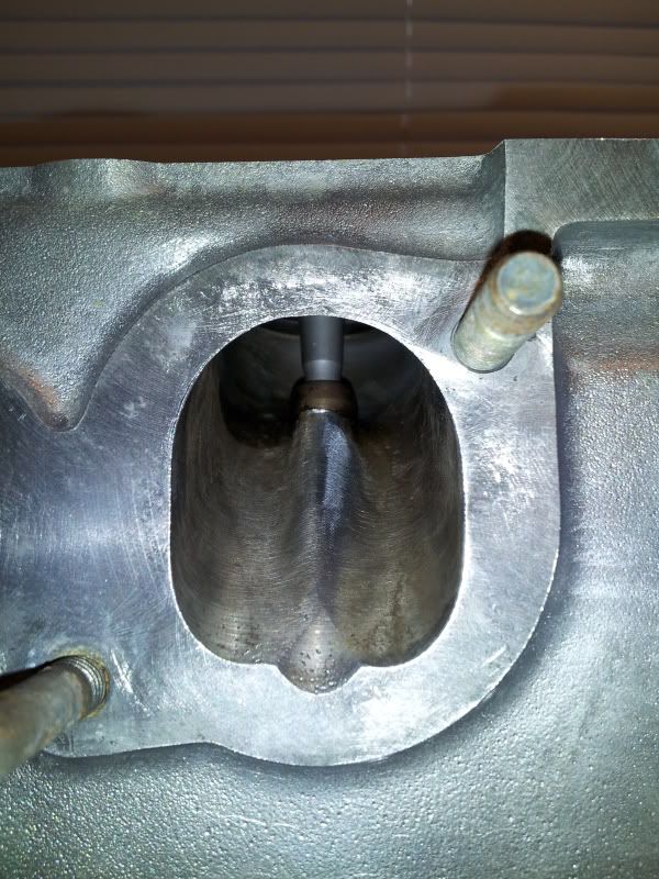

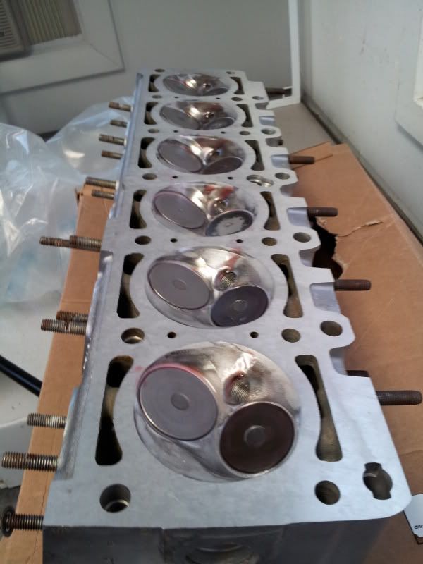

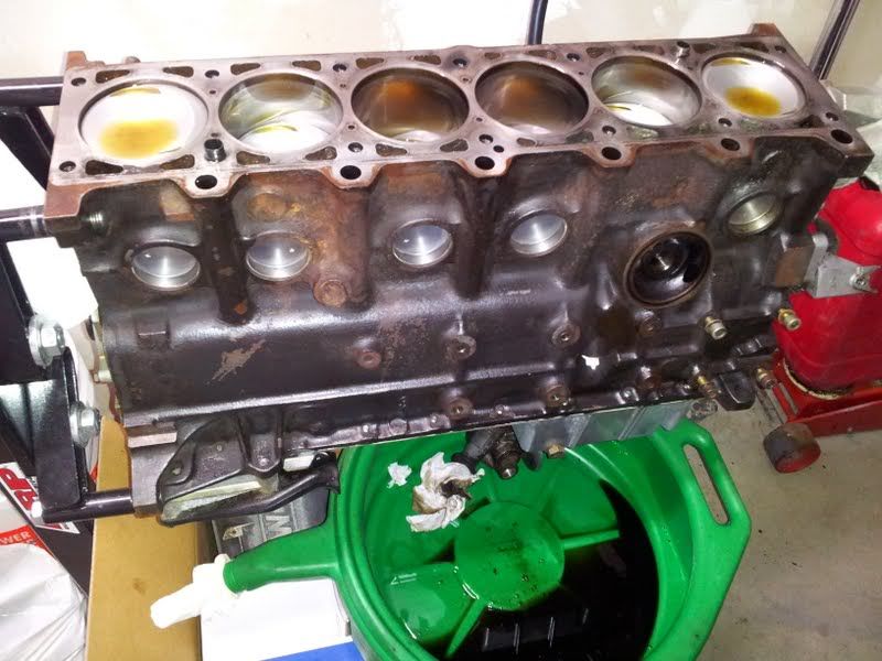

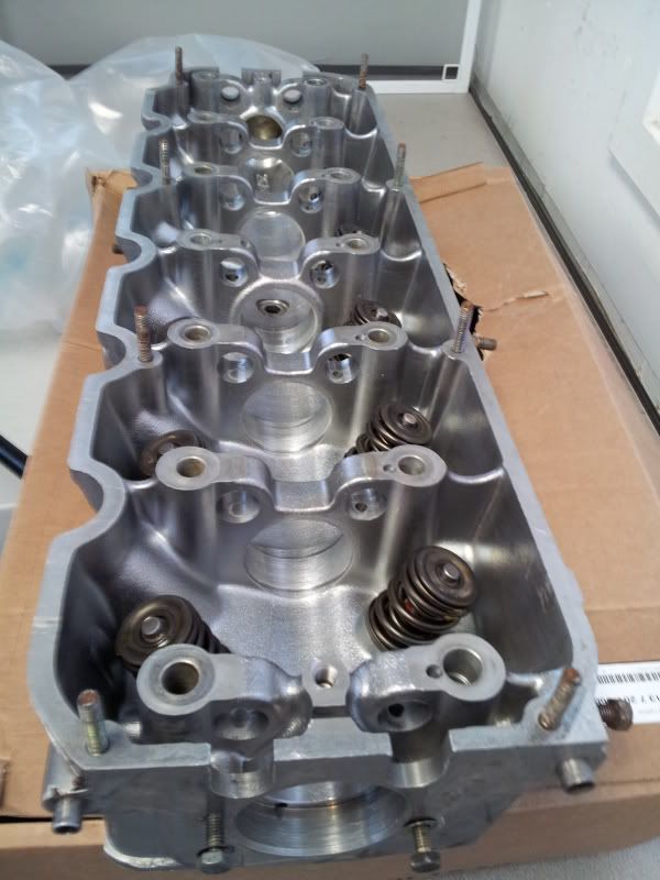

After tearing down the motor to a short block to inspect everything and replace seals / gaskets I noticed that it had both # 5 and #4 valve seals leaking ever so slightly so off to the machine shop it went. I had them pressure test, resurface, 4 angle valve job and put the new seals in. It tested good and all the valves seated nicely besides one so i figure might aswell make it perfect while off the block. I'm glad that I brought it to the machine shop as the cam had a slight bend to it, I figured something was up when it was hard to turn by hand. Thankfully it only had a few hours of run time and nothing was destroyed by this, they were able to hone it out. I don't think I will put another performance cam back into the car, probably just going to return it back to a new stock "i" cam with all new shafts and rockers.
Upon pulling the head off, there was slight carbon buildup but nothing out of the ordinary that some oil wouldnt take off. Cross hatching is still very visible wtih no scoring or scratching present.

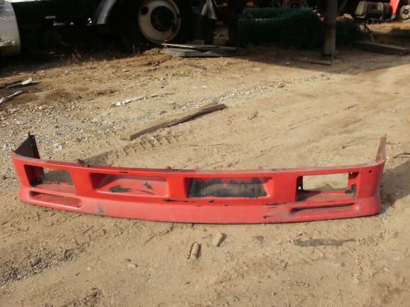

In the mean time I found a 325es spoiler FS, and bought it. I got the spoiler and the valance both in perfect condition minus the paint. I plan on putting it on with the is rear spoiler
