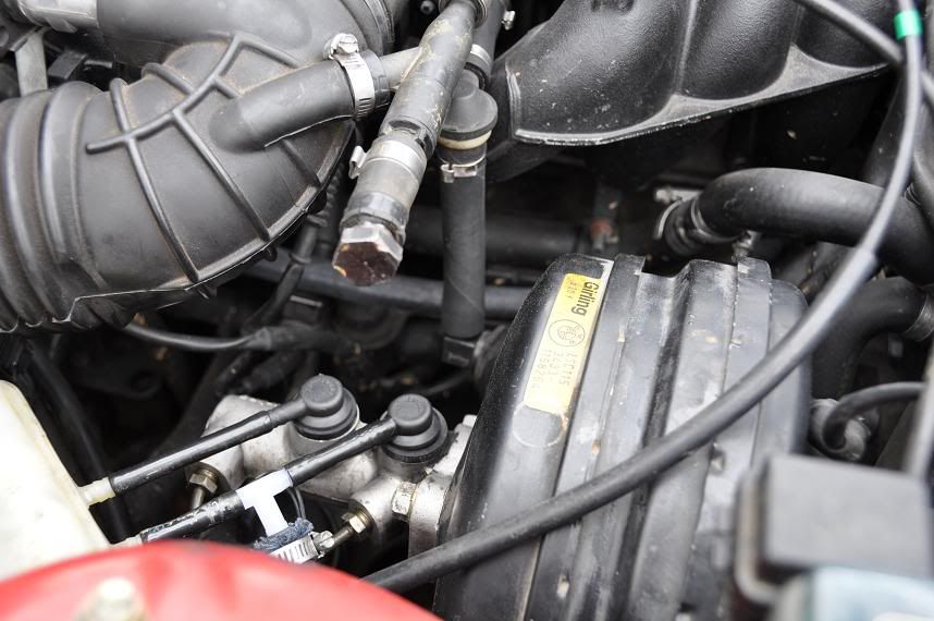

            This weekend I was able to find a e32 735 brake booster and master cylinder, as well as a remote reservoir. I installed the brake stuff this weekend. Anything I can do ahead of time to speed up the downtime this swap will create will be great. The 735 booster/mc was a great improvement over stock. The pedal is quite firm and has less travel. It feels like a newer car. It was a complete bolt on affair, with exception to the vacuum hose that goes to the booster had to be modified, and the reservoir had to be mounted remotely. I used a e34 v8 reservoir I picked up and used it for temporary use. I will eventually buy a 2002 reservoir to replace it.
            The downside to the e32 master cylinder is that it makes it hard to heel/toe rev match during braking and shifting at the same time. In order to remedy this problem I need to adjust the pedal further towards the firewall. That is easy, but I will also have to modify the bracket that holds the switch for the brake lights.

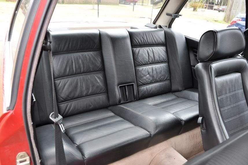

              You da man! Damn those E21 seats looks so good. What happened to your wheels?
                #37
                I want your seats.

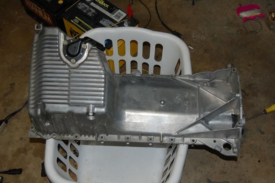

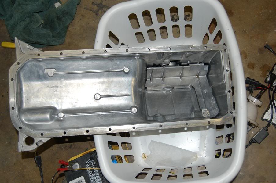

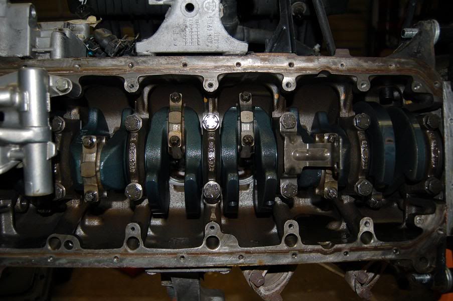

                    Here is a little update/tip. Take your oil pan to a machine shop and get it hot tanked. Dont spend 3 hours with purple power and a 10 pack of tooth brushes to clean your oil pan.
                    -Dan
                      #40

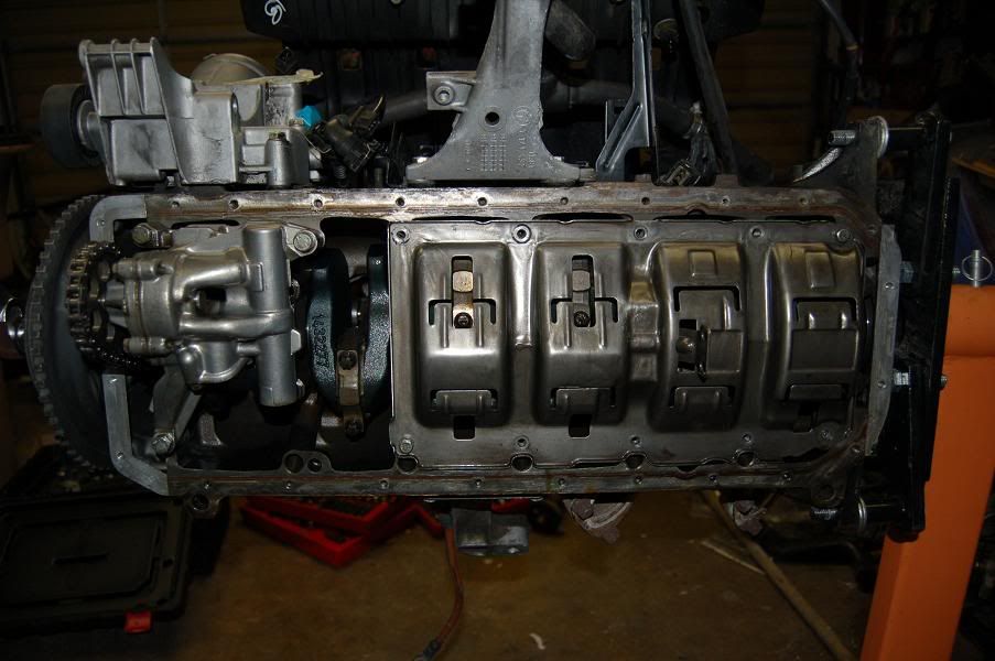

                      did your oil pan not have the windage tray or did you remove it?
                        #41

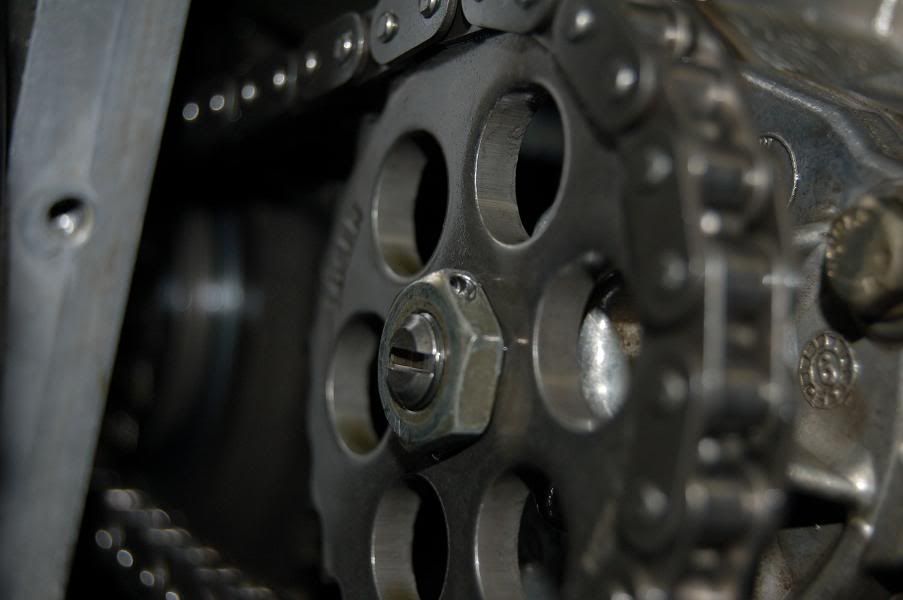

                        Nope, the oil pan didnt have the windage tray in it. I have no clue why, my previous e34 pans had them. I will just leave the e36 windage tray attached. Here are a couple pictures of my bottom end and associated windage tray parts. On a seperate note, my oil pump nut is already drilled for safety wire, but no safety wire was on it.
                        -Dan

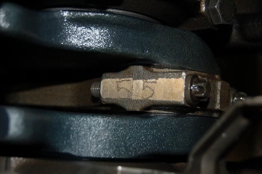

                          Have you taken a look at the bearings?
                            #43
                            Nah, dont really want feel a need to do so. All signs point to the bottom end being rebuilt at one point or another.

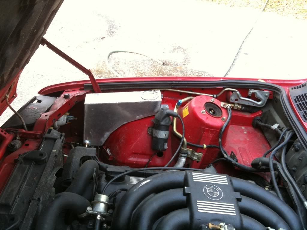

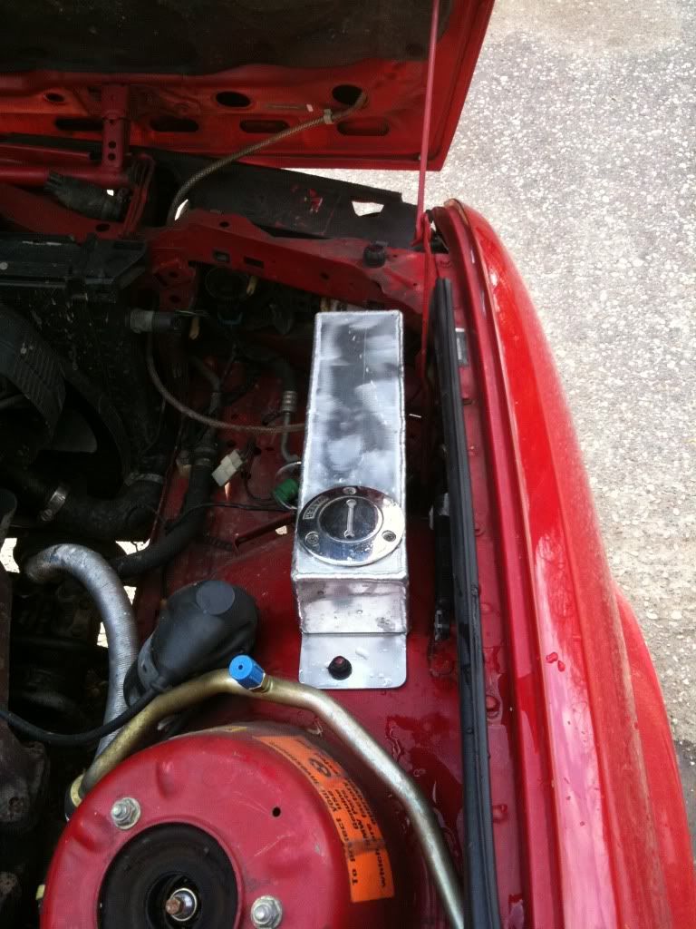

                              I added a couple things to the car this week, nothing major, just little bits that ive had around that needed to be installed. I made this spiffy aluminum windshield washer reservoir. I also picked up one of the fancy wide angle side mirrors from a friend of mine, Im still unsure how i feel about it. I also installed a 400w dc/ac power inverter in the glove box. I love being able to charge laptops and various other things when i need to.
                              -Dan

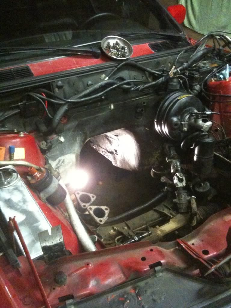

                                Started pulling the m20 at 7:30pm, had it out of the car by 9:00pm. Im now getting in over my head.
                                -Dan
