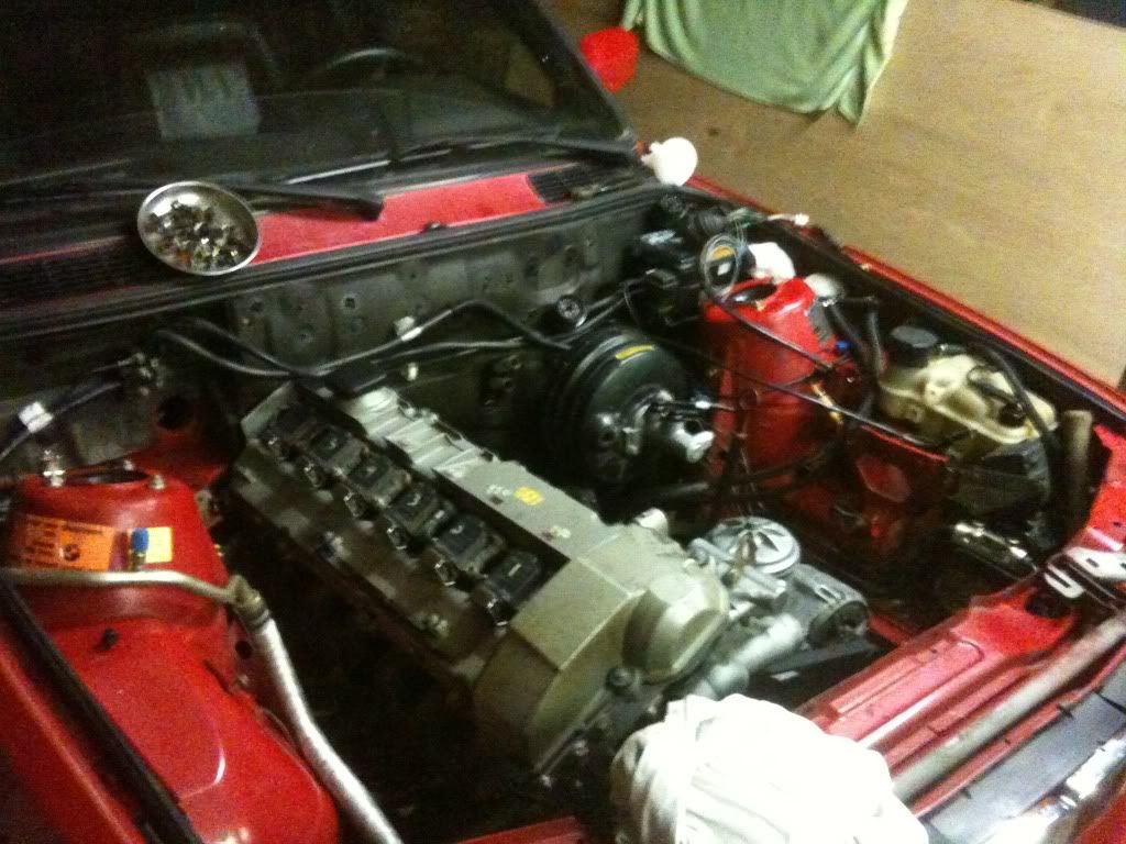

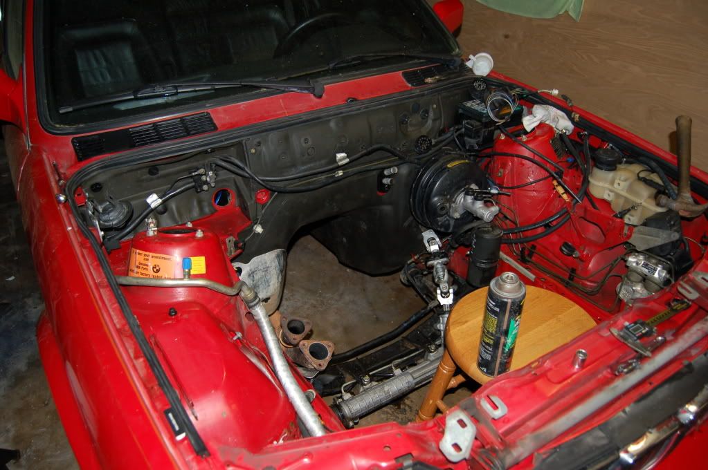

        Today was a rather slow day on the swap, so the pace slowed down a little. I had a few family things i had to attend. Progress today really didn't make a big difference like putting a new motor in the car did.
        I pluged up most of the wires for the harness, and got them sort of routed where they need to go. The engine will crank with the key, and my harness adapter will do something correct enough to turn on the fuel pump. The rest of my time was spent fabbing up a transmission mount and modifying the shift linkage.
        Here are better pictures of the cell phone pictures i posted last night. It still looks the same, just wires running everywhere.
        -Dan

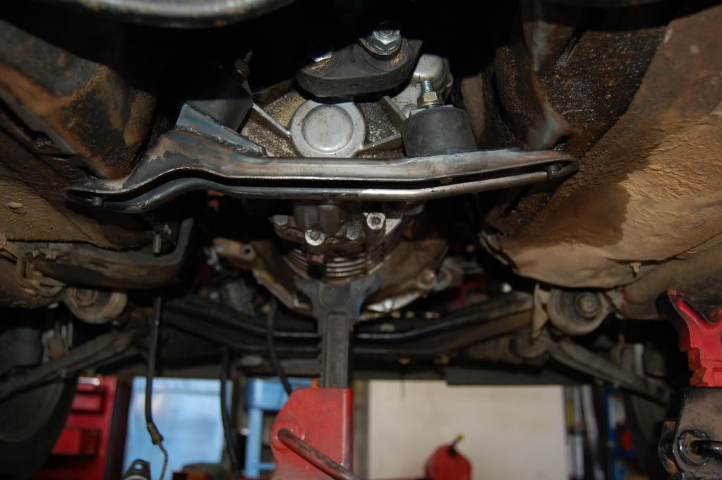

            Here is a quick shot of the transmission mount i modified for use with the 260 tranny, and e21 mounts.
            -Dan

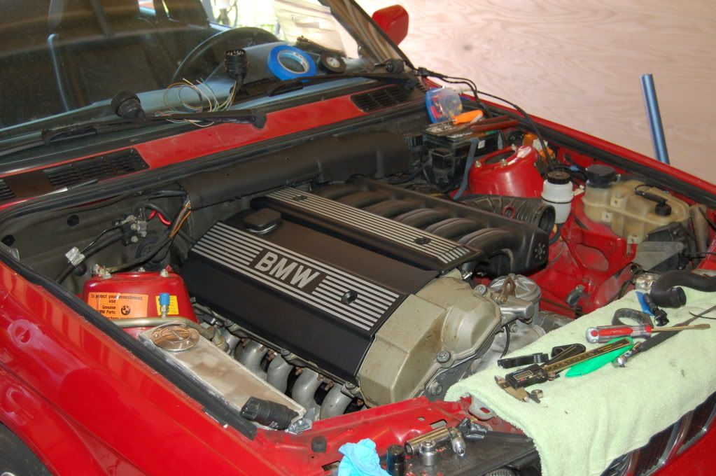

                Thanks, ive been out there for a bit today putting on the stuff that makes the motor look cleaner.

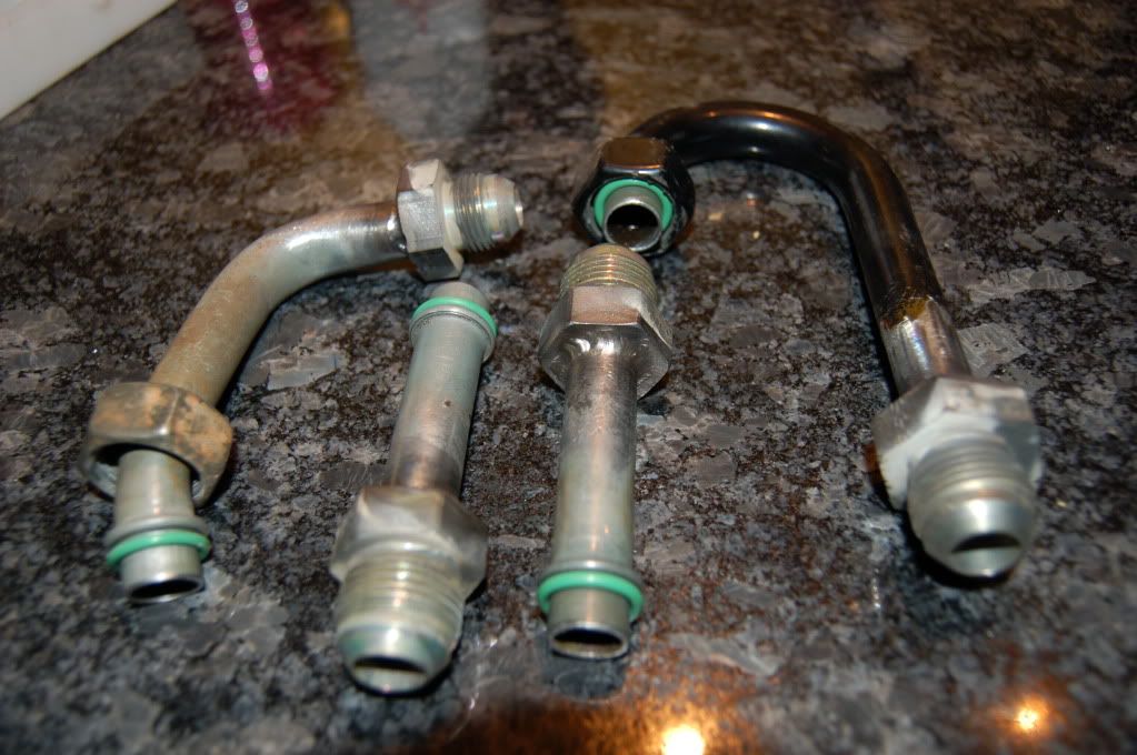

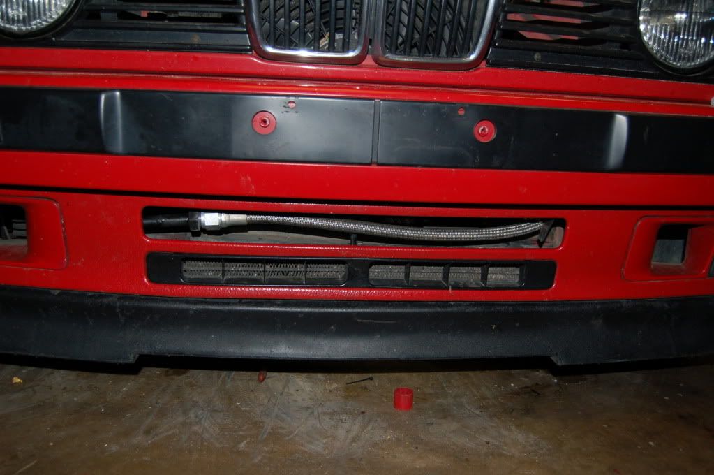

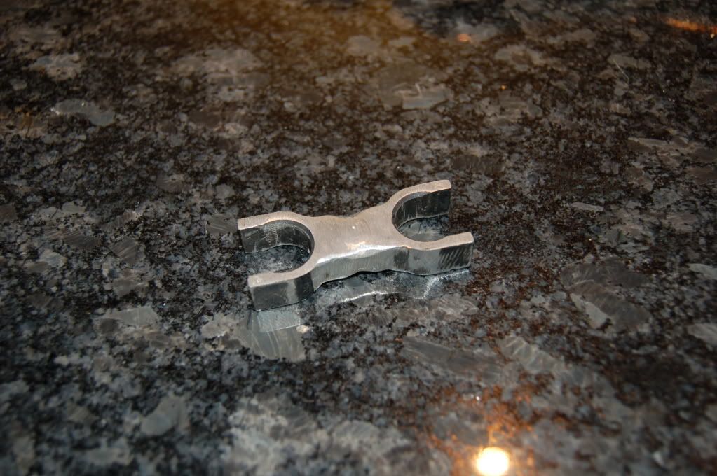

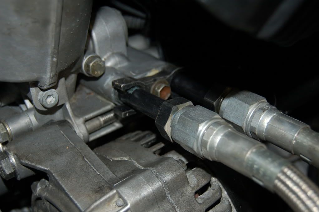

                  #53

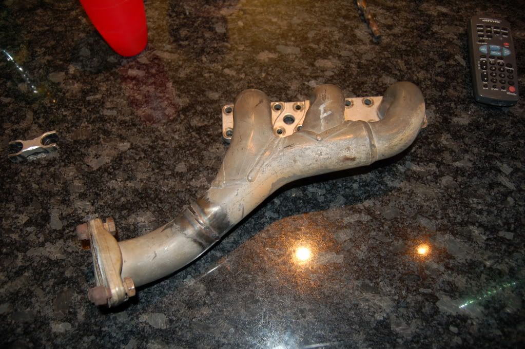

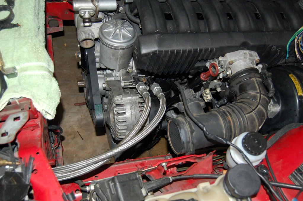

                  Today was a great day, I got my oil cooler buttoned up using most of the e30 lines and cooler, I had some fittings lying around and some hose that worked out nicely, so i didn't have to spend any money getting that all fitted up. Having access and the ability to TIG weld opens so many possibilities. On that note i also modified the m52 headers so i could take the car to an exhaust shop tomorrow and get the old header back temporarly put on. That was super easy as all i had to do was cut the front header and rotate the flange about 30 degrees.
                  And since everyone loves pictures, here are a few.
                  -Dan

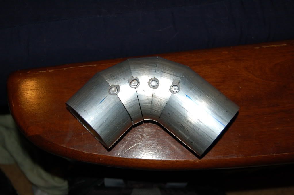

                        This is what i worked on tonight. I couldn't find any intake boots that weren't torn at the yards, so i decided to make my own. I still have to add a bit more to it, but it should work nicely.

                          finished the intake pipe, should work well.

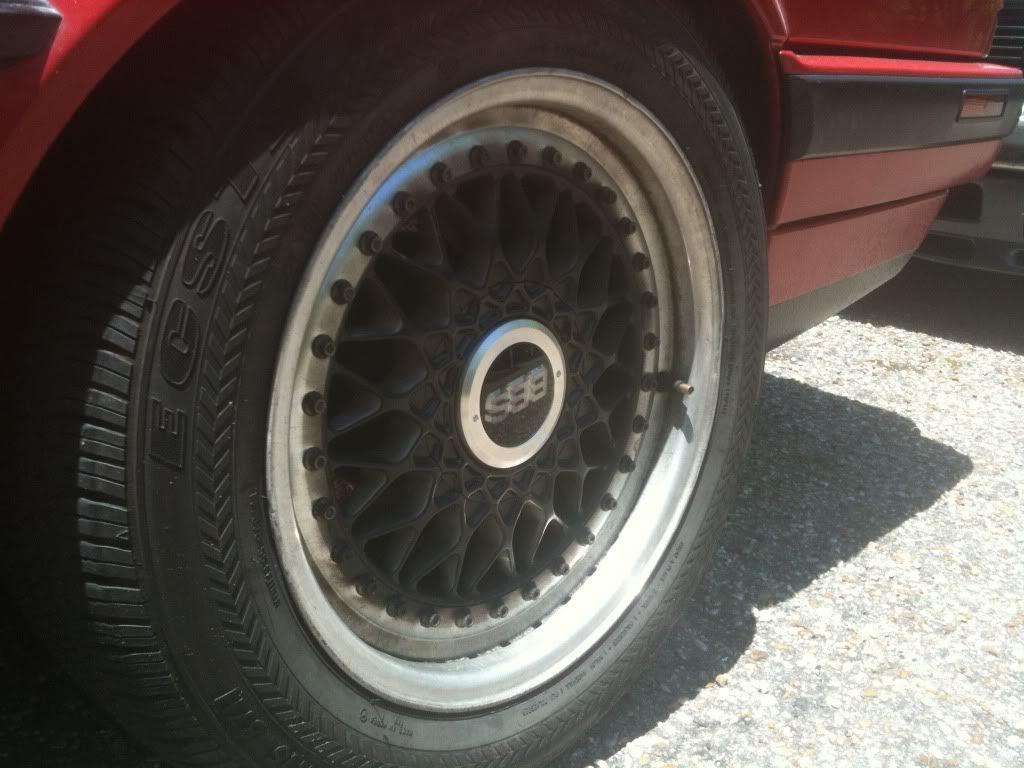

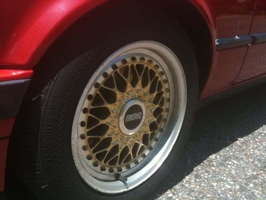

                              Got some flat caps for the BBS's, and ordered a chip. Yes i know the RS's are spray painted, I wanted to see what color I liked better before I stripped them down and painted the centers. Ill get to refurbing them when i get some money together for new lips.
