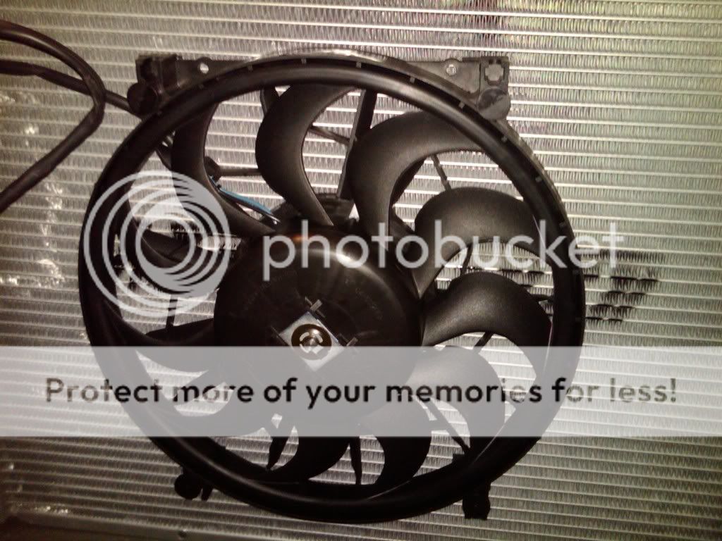

                  Installed this Derale pusher fan. Its only 12.5", but it moves 2150 cfm.
