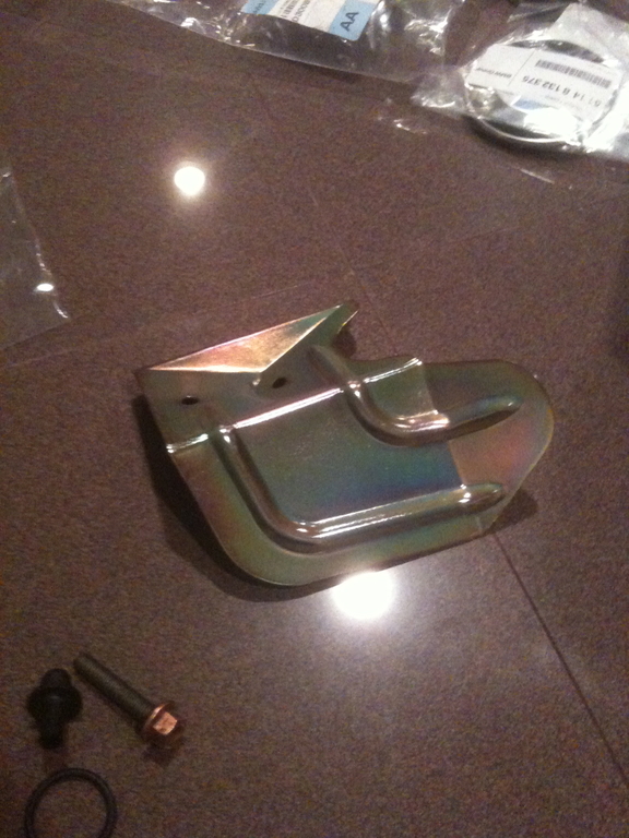

      I'm waiting on some parts to come. Mostly little nuts and bolts. The exhaust side motormount heatshield had to be shipped from Germany, so it's slowing up the order a bit. Hopefully it comes today so I can get everything bolted up and drop her in.

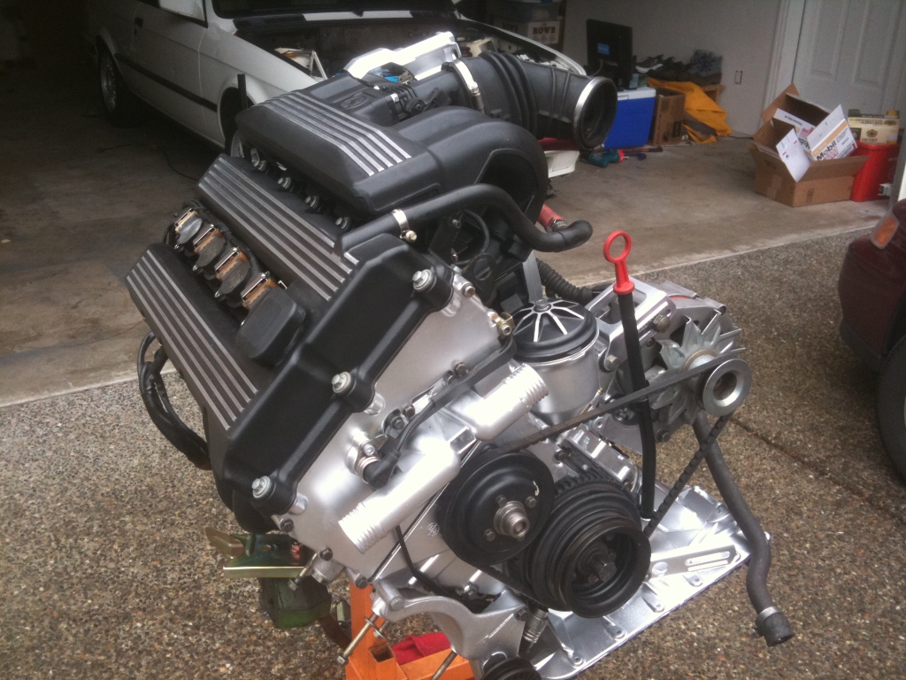

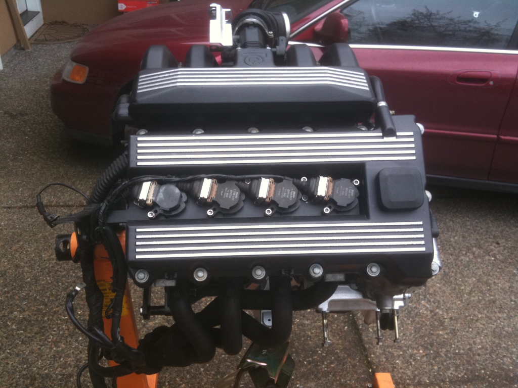

        Updates! Ready to drop in!!!
        So I put the finishing touches on the engine today, and it's ready to drop in. I'll be borrowing a cherry-picker tomorrow hopefully, and then a one-day break-in drive on Saturday :).
        We put the new rear main on and were able to fill it with oil last night.
        Heatshield that had to be shipped from the motherland & new O-ring for the oil filter housing:
        Valve cover and COP on:
        Not sure how this got upside down, but when I deleted the "mess under the intake" a few months ago, there was a light kink in the vacuum line from the ICV to the intake boot, so I went to Home Depot and found a brass fitting that worked for an elbow:
        Ain't she purdy?
        I put some 1500deg black paint on the headers, so hopefully they stay black for a while.
        The only paper gasket on the whole thing poking its head out (the RTV I used is some nasty s&%*... I got a little bit on one of my tools, and I had a hell of a time trying to get it off):

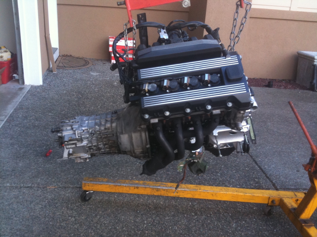

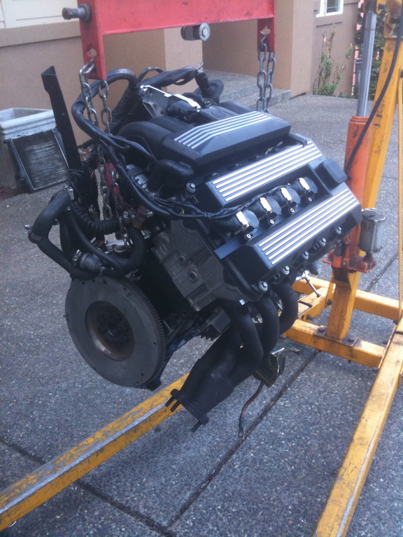

                    Productive day:
                    The engine finally came off of the stand and on to the hoist.
                    I got the 13lb 323 flywheel all mounted up. Breaker bar in the right hand and torque wrench in the left... took a bit of skill to get them to 90lb/ft each.
                    Got the tranny mounted up:
                    I didnt really take a lot of pictures during the two hour struggle to get the engine in with the transmission on. Pretty much everything under the hood is hooked up and ready to go. I have the full M3 harness covers to go on too.

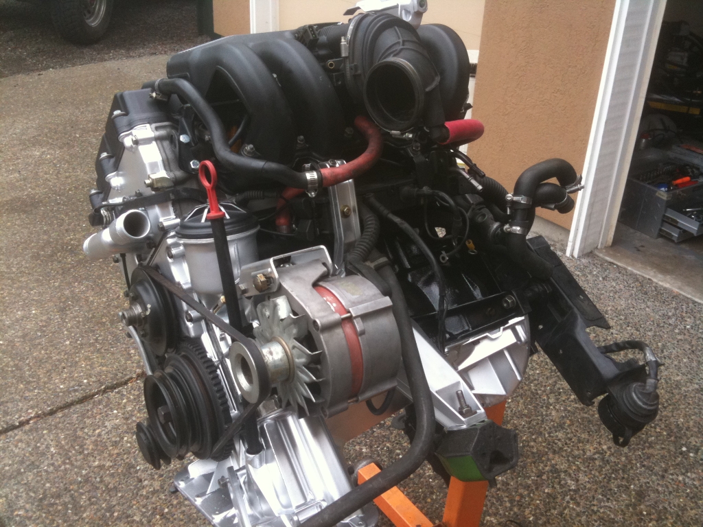

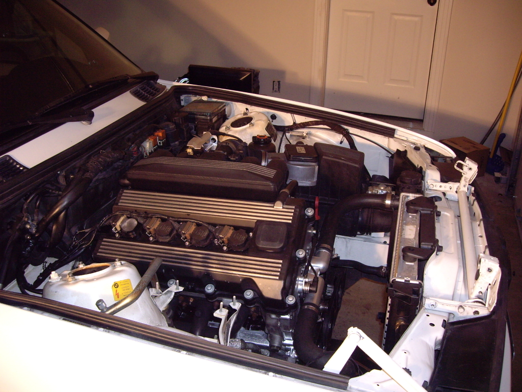

                        Whats with your AFM? The plug is different than the M42s ive come across
                        Originally posted by vlad
                        • KenC
                          King of Kegstands
                          • 14396
                          #42
                          What do they normally look like?
                          According to records, the AFM was replaced at the dealer in '07 by the previous owner (~$700).
                          Originally posted by Gruelius
                          • Joe318is
                            • Sep 2005
                            • 6451
                            #43
                            Most have a round plug... just curious if there was an AFM swap i did not know of
                            • KenC
                              King of Kegstands
                              • 14396
                              #44
                              If you look in my pic, you can see the round plug in there. Maybe they just updated the plug into the AFM... who knows.
                              • Joe318is
                                • Sep 2005
                                • 6451
                                #45
                                They all have that too. Its kinda odd, i think [but dont quote me] that there was an early recall on these cars where they placed a jumper between the AFM and the old plug. Theres an inline resistor built into the jumper.
