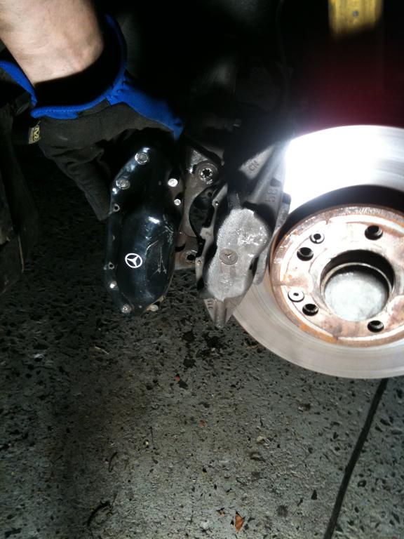

  • ZM Blue Devil
    replied
    We also received the 500e Aluminum Brembo's:mrgreen:
    Will be installing those soon as the new larger rotors done.
