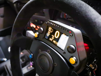

              A bit of a bump... Were you ever able to extract engine data from the MSS50? I read on another forum your on that the pre-2000 euro cars were not OBD II, so we cannot use the easy CAN port to pull info for data logers or lap timers, etc.

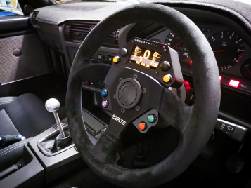

                  Yep, reversed engineered the whole thing in the end and built this.
