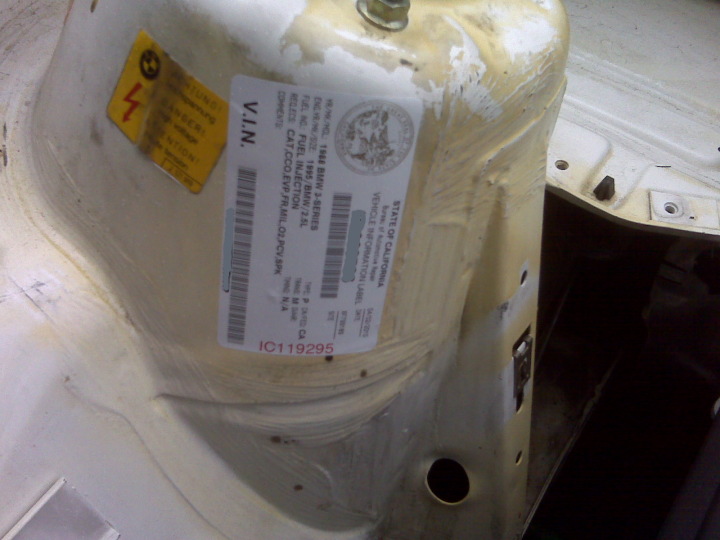

    WOOOOOT! Passed smog referee. Took it in to Alameda, CA Smog Ref. Had a nice folder of documentation, including replacement engine VIN and its smog history. I don't think you needed it, but it certainly helped him identify the replacement engine. He looked through the smog books, then visually checked a few items. He took peek underneath to make sure there was a catalyst, then "uhhhh.... looks good. Wait here, I'll get you a sticker". Like any good state government worker, he slapped the smog cert on the shock tower in a piss-poor manner.
    Smog Ref spent most of the time looking through requirements on the computer. Since he didn't ask, I forgot to mention the M3 cams. Oops, my bad.
    A smog test isn't required until registration comes due in June. When I go in, the smog shop will treat it like any other 1995 325i.

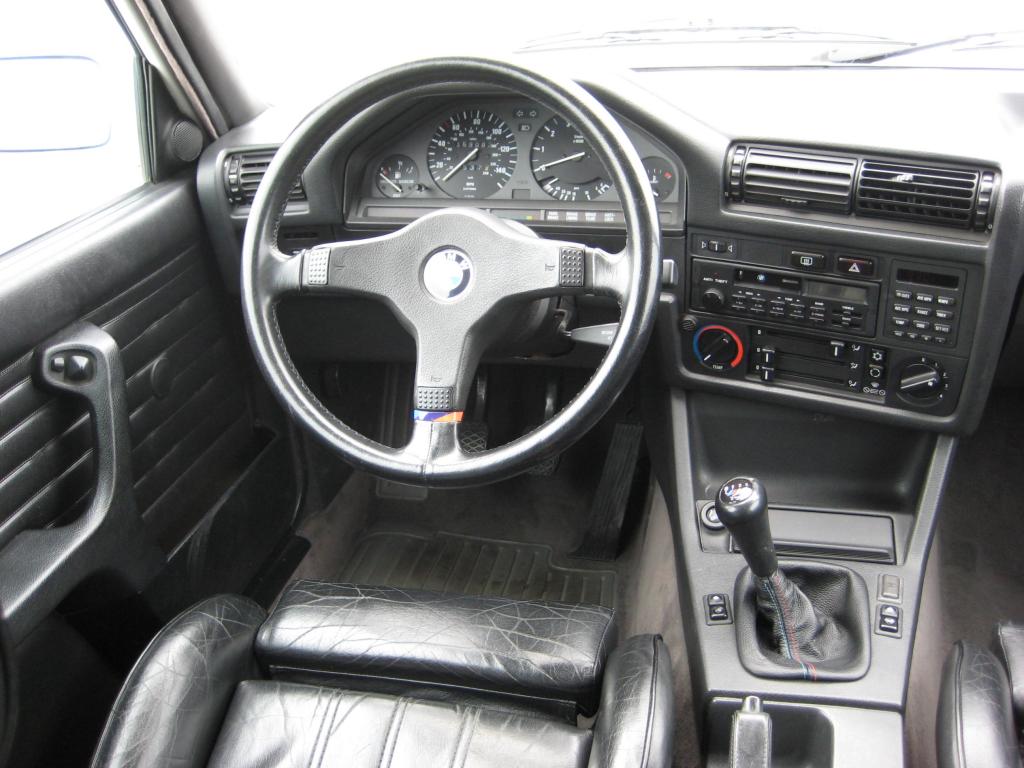

            This is a nicely optioned car, with all the little extras: Black leather sport seats, M-Tech steering wheel, Maplight mirror, 13-button OBC, Tape cassette console, etc.

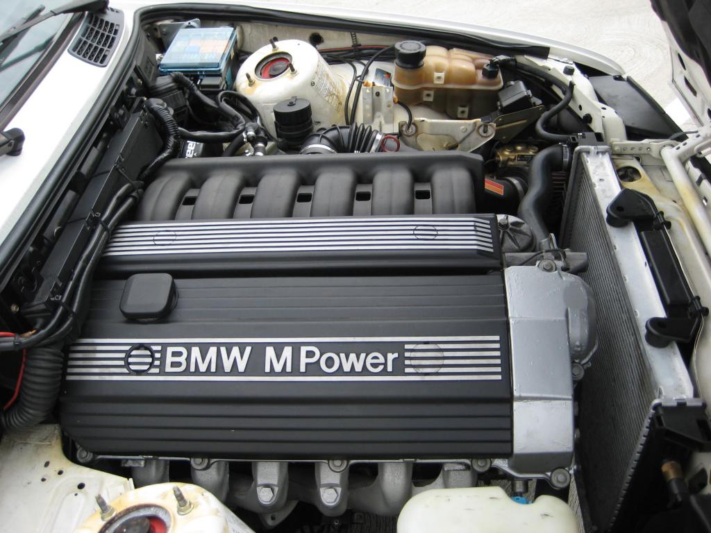

                      The S50/M50 was about cost / performance. Also, I'm an accountant, I'm a sucker for documentation.
                      I bought the S50+ZF on a whim for a few thousand dollars, before selling it as costs escalated out of control. It needed computer + E34 oilpan, and history was unknown. The guy *said* it was low miles, but really had nothing to prove it. For all I know, it could have been thrashed to within inches of its life.
                      By comparison, the M50 was $500 complete, from a T-boned 525i. Bought from reputable local shop with 10+ years of maintenance records. It was probably Grandma's daily driver, likely never revve'd over 2500 RPM in its life. For extra $100, he thew in a huge pile of spares: another DME, another MAF, a Getrag 250, and 328i driveshaft (most of which got promptly resold for a few $ on R3v and Craigslist, bringing the all-in cost down).
                      In retrospect, yeah, an S50 would've been nice, but an M50+cams+chip should do 200 whp = 230 crank hp, gets you near the M3's stock 240hp. The car isn't a tire-churning monster, but it is very nicely powered, nicely balanced, and rev-happy. I'm happy with the tradeoff.
                      Besides, a few months later, I found YET ANOTHER S50+ZF, totally complete, in PicknPull, including computer. Picked that one up for $600 including paying a guy to deliver to my home. Kept the "==BMW M Power==" valve cover and sold the rest to finance my new wheels.
                      See that story here: http://forums.bimmerforums.com/forum....php?t=1399230

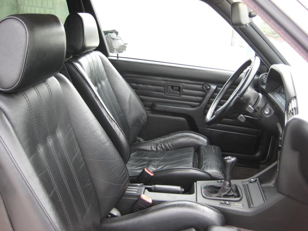

                            Installed a new bottom seat cushion for the driver sport seat, and hot-glued an extra layer of foam in for good measure. It makes a world of difference in support.
                            (After this picture) I re-dyed the seats using Doc's Leather Black. It is a leather conditioner with a black dye, did a great job of filling in all the scratches and creases, so the seats are a nice consistent black color. Great results for a measly $14.

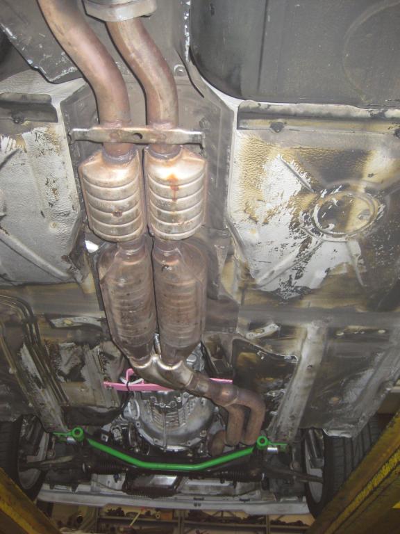

                                I took it to a custom muffler shop to have the E36 exhaust better adapted to the E30 body. They welded some new hangars, and gave it some body english to get it right. No more banging on washboard roads. The exhaust note is just like a stock E30, you wouldn't know it had anything done to it.
                                I'm going for a Miami-Vice theme in the undercarriage. Green swaybars by Suspension Techniques, TRM Control Arm eyeballs, and a pink Getrag260 adapter (made & painted by a guy on this forum). Why pink? Don't know, didn't have the time to repaint black before installing it.
